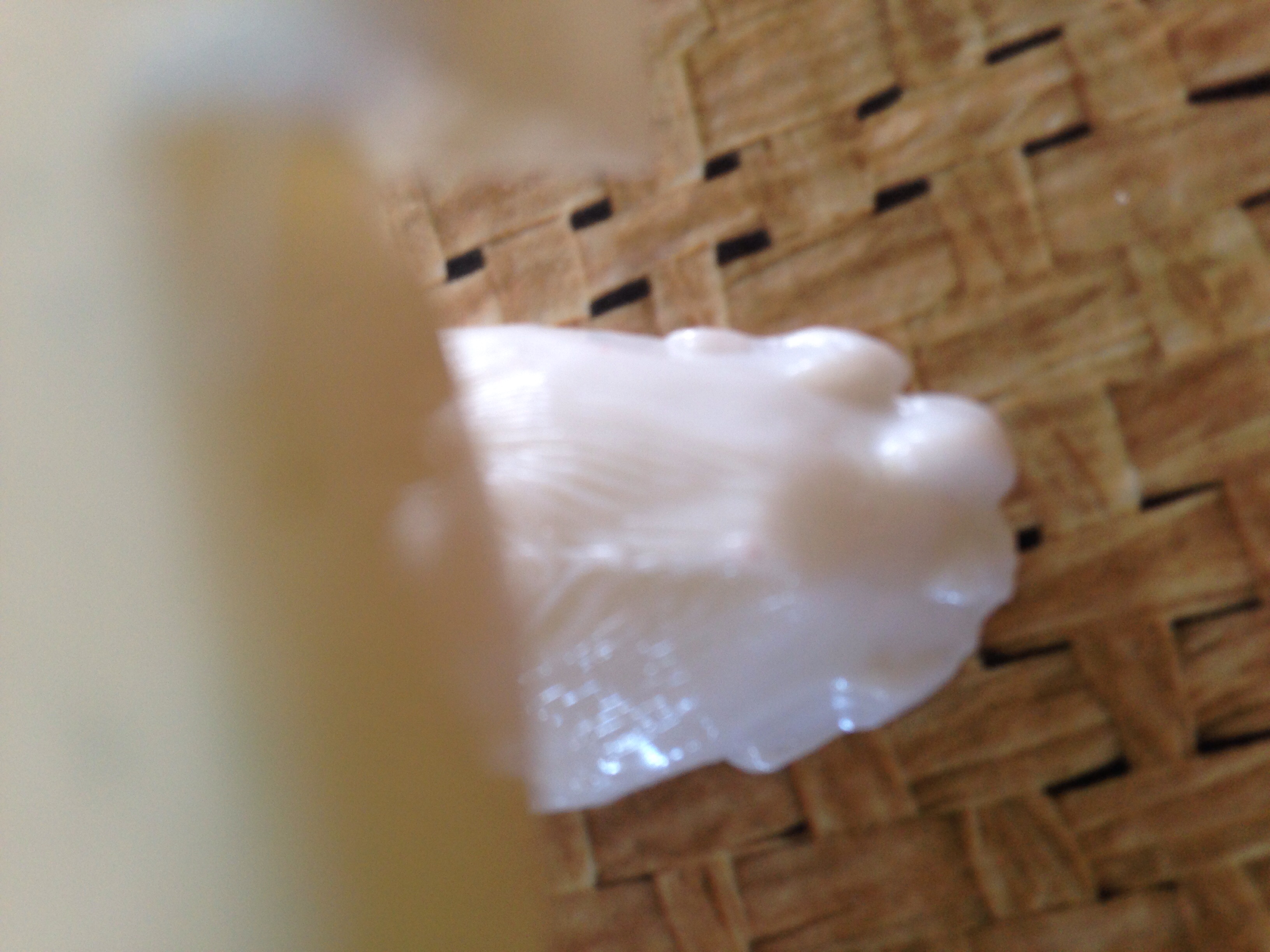

so I have taken your guys advice and made supports for my prints but now it leaves marks like the picture below. This is after an acetone bath is there something I can smooth it down with?
thanks
I would use a blade to clean the little extras off before the acetone bath. The bath will smooth some but when you have a lot of extra material it will not remove it all.
