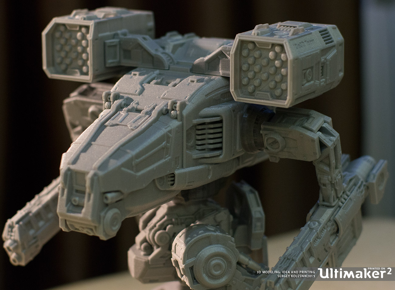

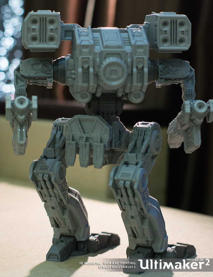

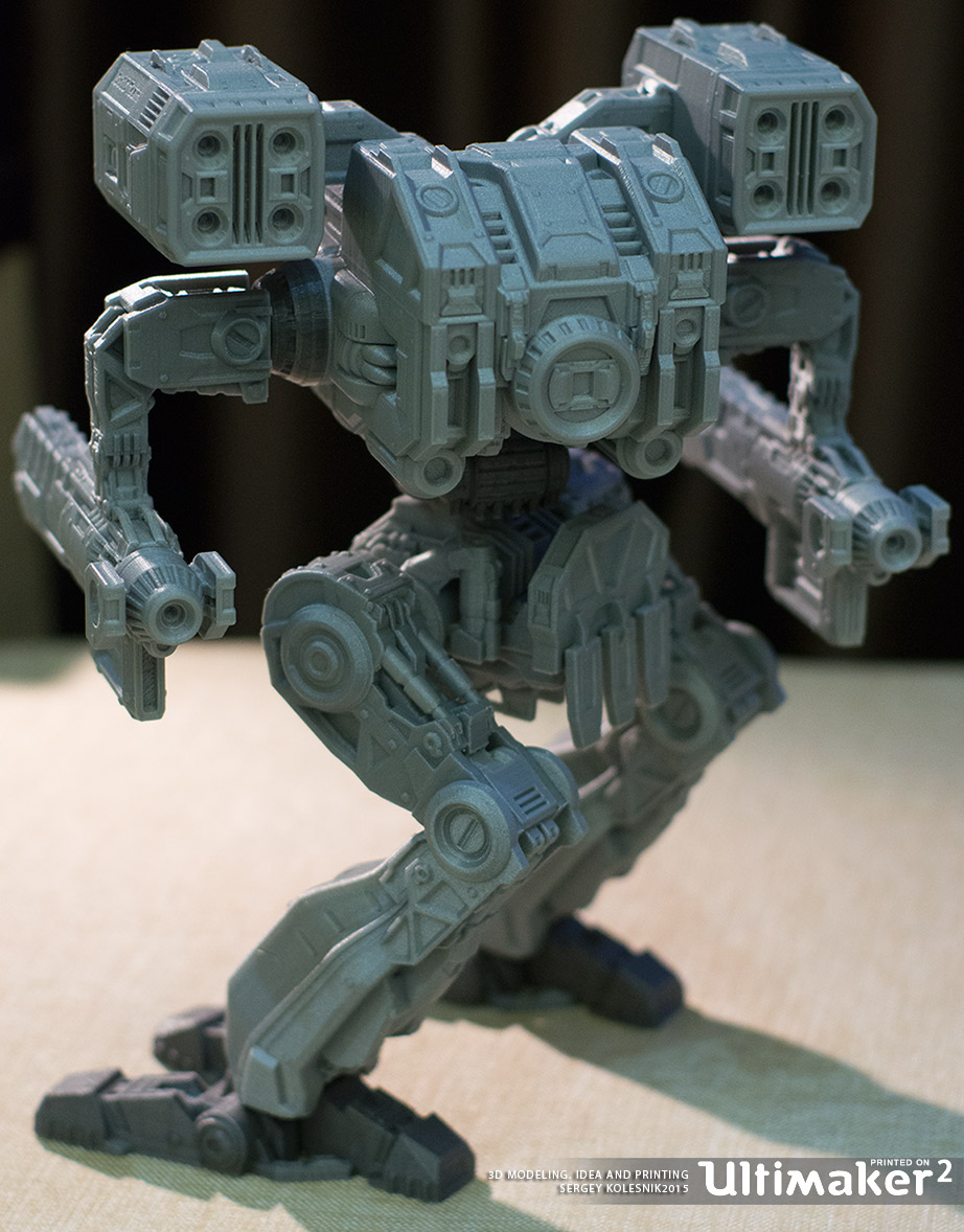

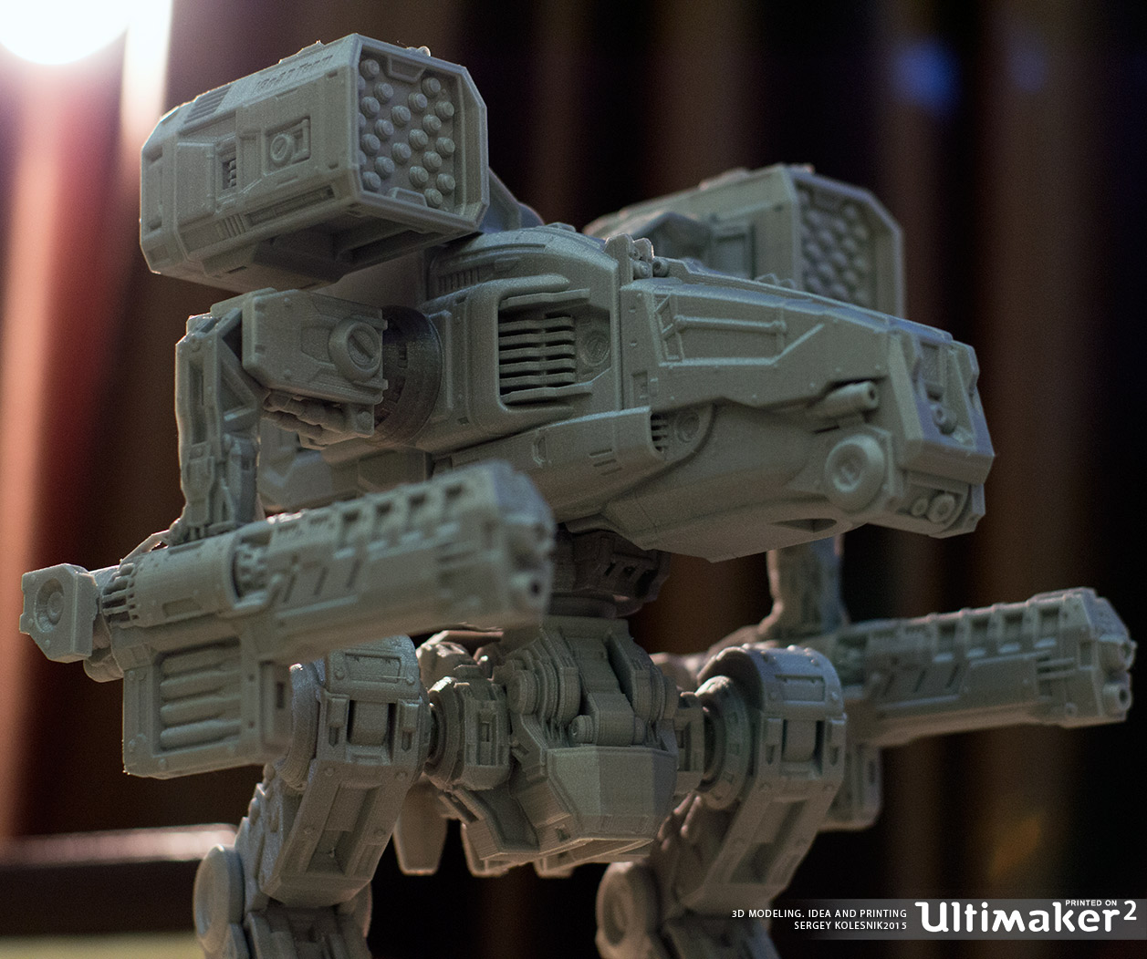

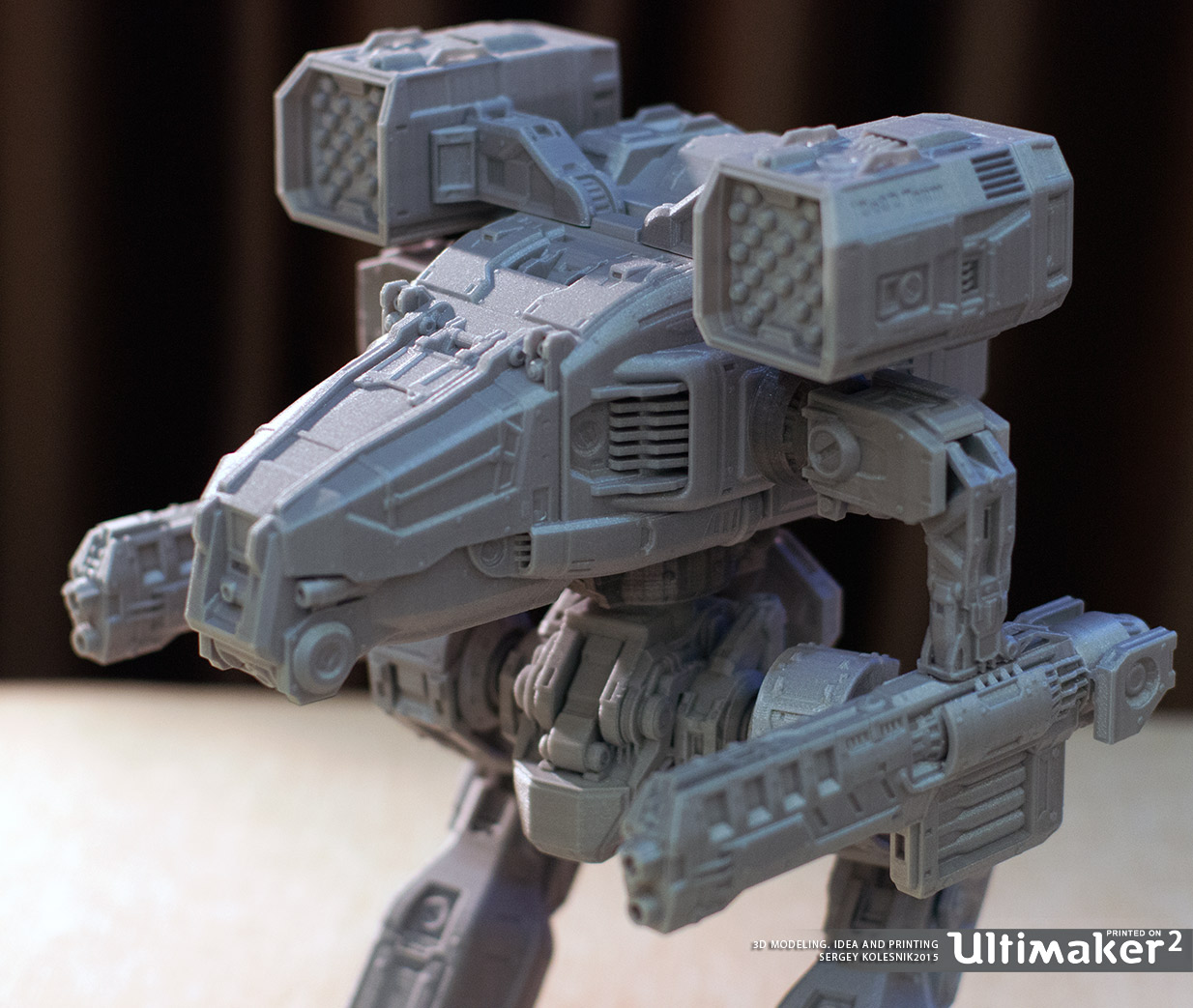

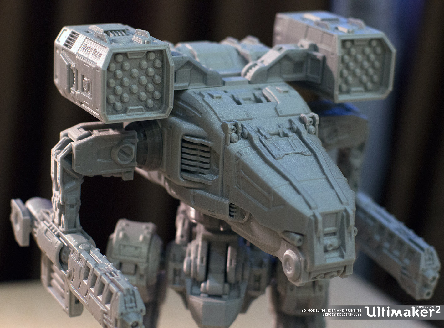

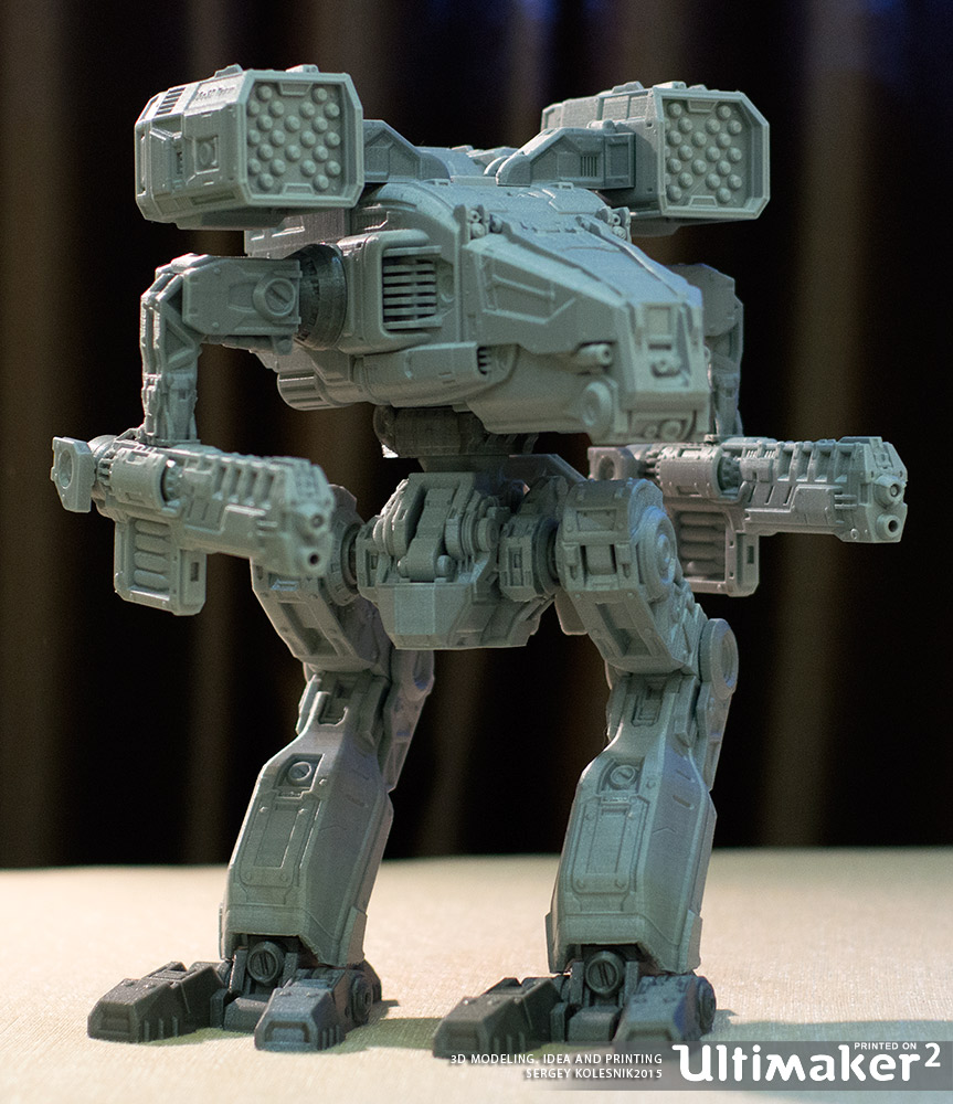

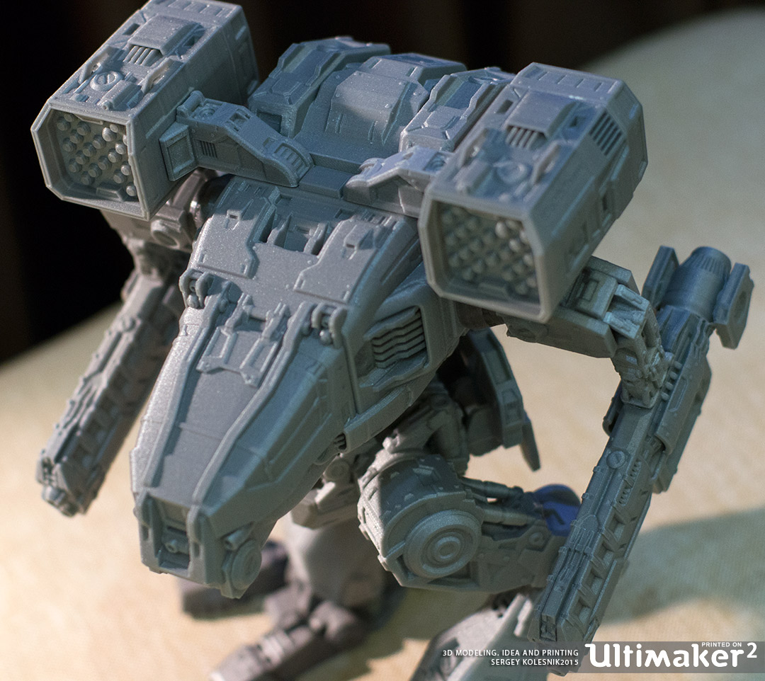

This is the first copy of the height of 32 cm.very heavy toy 830 grams.
pla Innofil3d/ you can order and buy the printed model for me.

Hi Sergey,
Can you please share with us your printing settings on the Ultimaker2? What is the secret to achieve such perfect print?
Best Regards
the magic of course! :)))) low speed print and correct temp/ and i use only pla innofil3d
I have been using innofil3D filament too and I know its quality. I was expecting to know more about the magic. There is any fine tuning in the Ultimaker 2 that you could share with us beside low speed and correct temp? In the photos I didn’t noticed any Z-scar.
Cheers
216-218c if speed 45-55 mm/sec .210 on 35 mm/sec
Which slicer do you used?
cura v 15.04.2 only / cura forever :slight_smile:

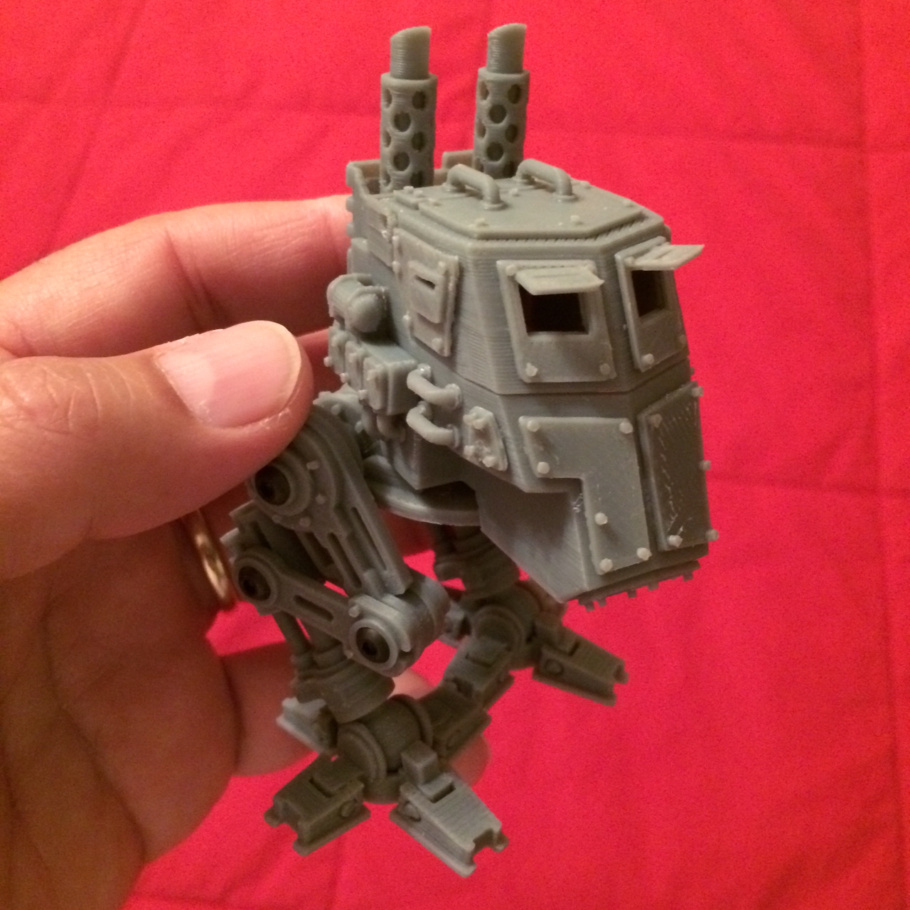

And I was proud of my silly toy…
Congrats.
Why don’t you take it directly from the game file?
Here is the Masakari I took from the game and made 3D printable.
http://www.shapeways.com/product/868LFMEN2/warhawk-prime-masakari-prime
