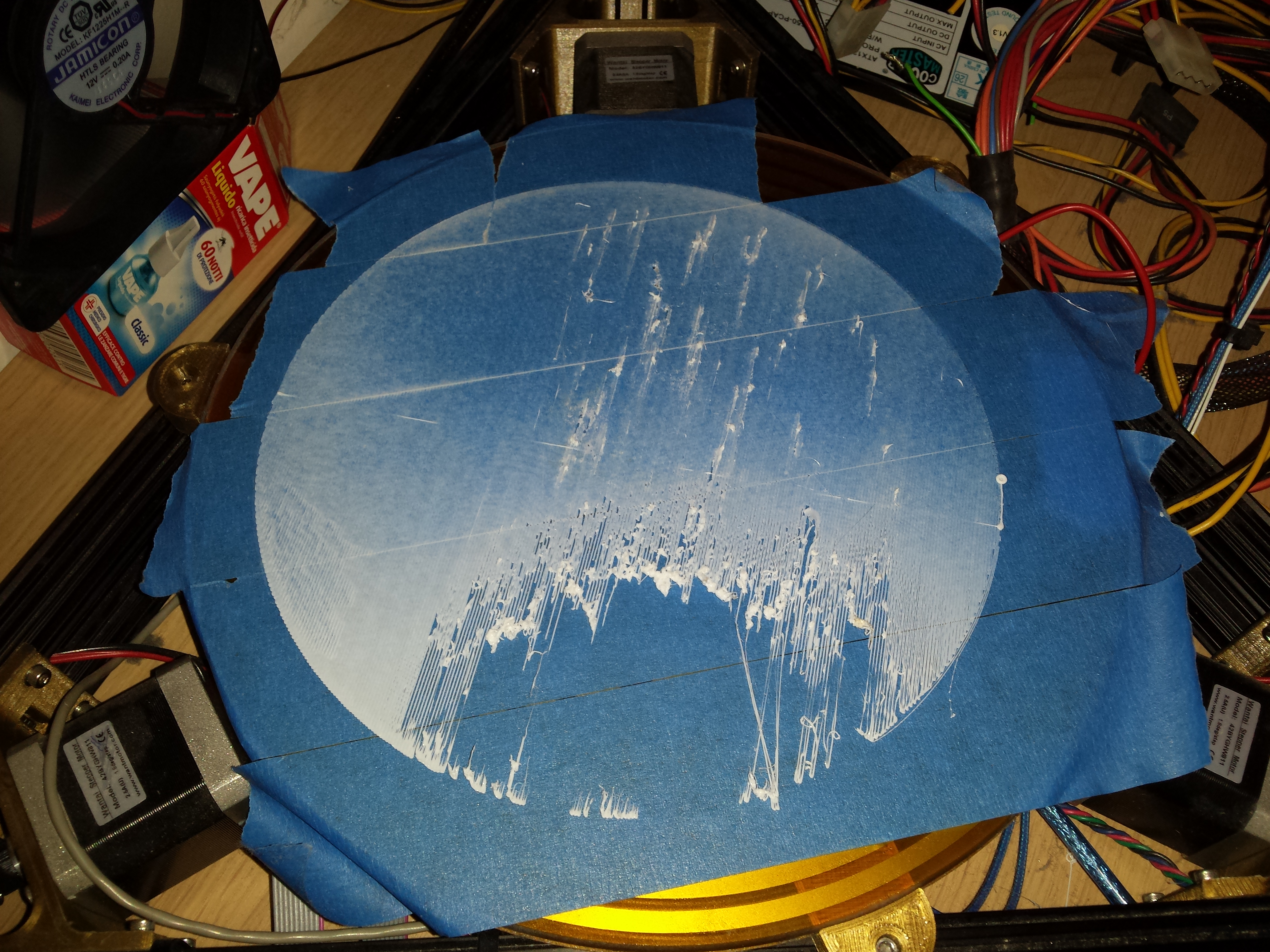

Greetings all,
I bought a Kossel XL last year from builda3dprinter.eu. Unfortunately I’m having a lot of problems with calibration. To be exact it will work so-so for small prints, but when it comes to larger footprints, it fails miserably. I’m attaching a photo to illustrate my problem. I calibrate each tower and the middle of the platform, using the paper test, and those are fine. Even then there is this “dimple” having a whopping 0.15-0.2 mm gap there…Currently I’m trying rotating the platform to see if this issue is with the movement or with the glass somehow…I mean this is not a concavity/convexity problem nor is it a simple “tilted plane”, and thus calibration simply doesn’t help with it…Any suggestions would be appreciated. Btw, the issue is the same without the masking tape, using the heated bed. Thank you!

.15 to .2 mm gap is not unheard of. Glass isn’t '.00000001mm ’ perfect. Mirror glass is usually better. I suggest rafting large prints, and over extruding on the first layer an additional 25% or more
Hi Adam,
I have a delta too and the issue is familiar. For me the purchase of a borosillicate glass bed solved the issue, but I see that you already have glass. Not all glass is equal though… These are some other random thoughts:
* If the diagonal arms are not equally long you can get very strange non-linearity effects.
* in my experience the “thin spots” can move around if the nozzle moves the other way so also experiment with that. If that is the case your effector is not level enough and there is too much slack in the mechanics.
* Are you using a thicker “initial layer height”. For instance 0.3mm work well for me.
From my experience and your photo, I would say the glass bed isn’t flat. It looks like in the center it gets too close to the nozzle and prevents filament from flowing and then as the glass gets closer to the camera it lowers and gets too far away from the nozzle and the filament can’t stick. Obviously you could try getting a different glass bed, or you could try tilting the bed very slightly so that the part of it that is closer to the camera goes higher and gets closer to the nozzle. This should also slightly lower the other half of the bed which looks like it’s too close to the nozzle anyway.

Aerospacesmith, yes the setting for the Y tower was off, but I didn’t care much, I’ve been fiddling with it for quite a long time, and I just wanted to demonstrate the issue. Unfortunately it really does seem like there is a palm sized “anomaly” there, regardless of the calibration settings. I recently tried rotating the bed to see if this “dimple” moves, so far it seems it does not. So I’m starting to fear that it has to do with the diagonal arms, as Themba suggested.
For the time being I’ll fiddle with the first layer, see if over extrusion and a higher layer thickness helps. I could also just use the “better half” of the print area for most models.
This looks and sounds like something going on with the diagonal arm settings, especially since you seem to have played with and eliminated a lot of the other issues (bed tilt, delta calibration, etc.) You may try just swapping the diagonal arms to another side of the effector - if the dimple follows, there’s your culprit. Outside of replacing the arms or modifying them to all be the same length, I don’t think there’s any way in the firmware or other fix to make the problem go away. I had great success with using a calibration sensor and firmware that supports it. See here: Mini height sensor board | David Crocker's Solutions blog 18. It is sold through Filastruder in the U.S. Good luck!

Szia Adám!
Had the same issue with a rostock and the problem was that one arm was longer. But first check the bed with a aluminum ruler and a lamp ( put ruler’s blade on the glass, light it from behind if you see any light coming through, you can purchase a new glass, the bed must be at print temperature(60-70C) for this!!!
If your glass is fine, luckily as its a delta printer every parameter can be modified:
http://www.thingiverse.com/thing:745523 20
So just follow the instructions with printing the calibration test and the measurements will identity the problem. If one of your arm differs from the other 2 (so to that direction its prints longer or shorter) in a Marlin FW with the instructions provided you can correct the towers.
It worked great for me.
