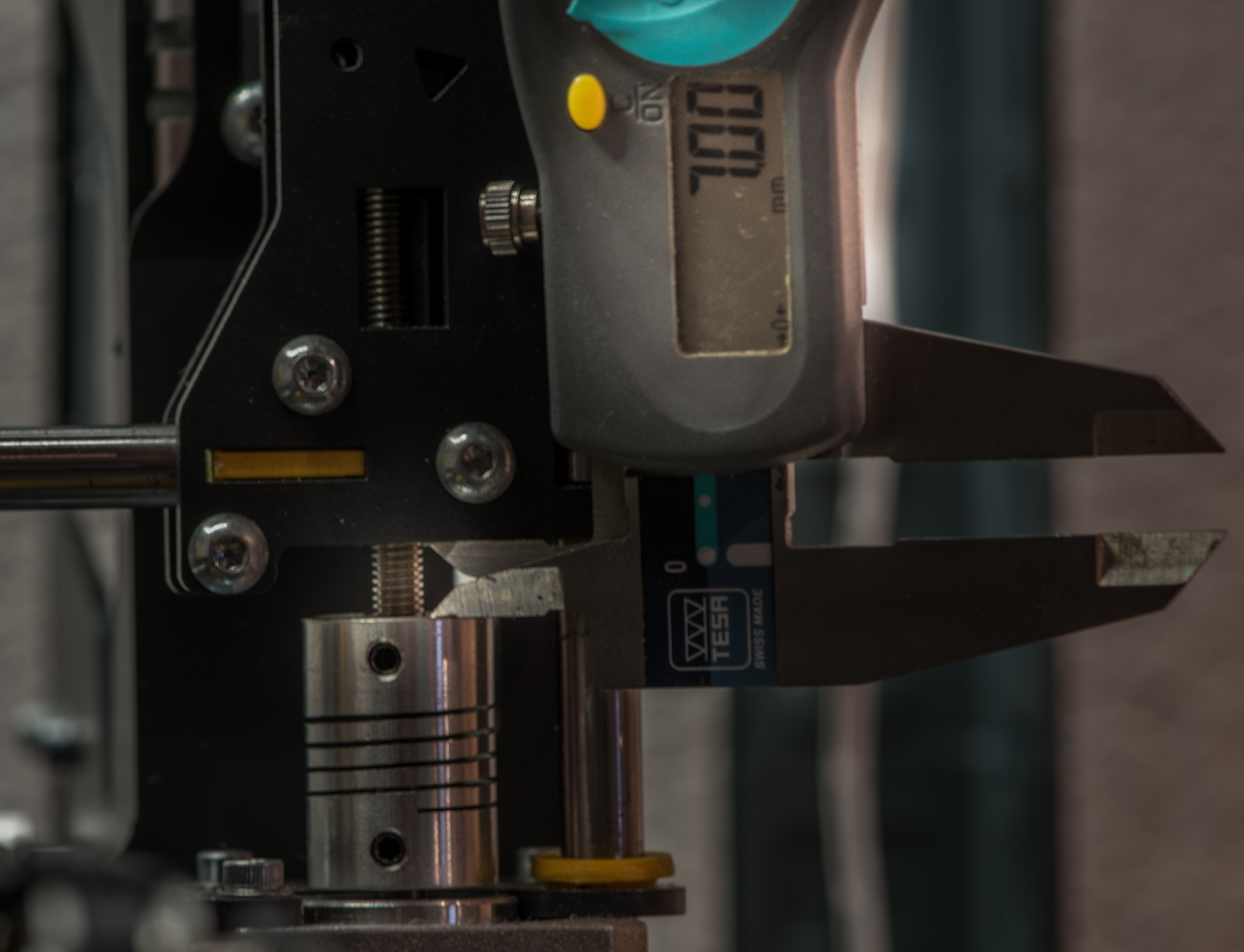

Thank you, i’ve well understanding, but what i try to say its i have not much space between the end and the extruder axis, like you can see on the picture.

Z axis screws should not be constrained at the end. I have a ReprapPro Huxley and actually the end are free:

So today i’ve buy two new M5 screw bar, but i think i do to replace Achse Starre Kupplung too, because they don’t turn right, so i will do this, an when i’ve replaced it, it will be good
There you can see :
hi, yap i’ve already removed it, i’ve prined new one without constraint, to just be a simple cap, don’t touch the screwed bar

Hi, you just need to switch bad couplings from Z motors to threaded rod with simple tubes. They work the best. It is definitely wobble, as you can see whole layers are shifted and I bet in 0.8mm pattern if you use 5mm threaded rod.

Carrefull with the couplers, there are two main variations:
1) Like above, the screw will push the rod in such way that, unless it would have the exact same width than the hole (which is impossible of course), it will not be centered.
2) Flexible couplers. These have 2 more screws that will help pinch the rods. The idea is to first screw these as much as possible then use the central screws to hold the rods if necessary. Chances are that things will be much better aligned. I also ofteen use aliminium foil to thiken rods if necessary, that allows for some fine tuning and almost perfect alignement.
