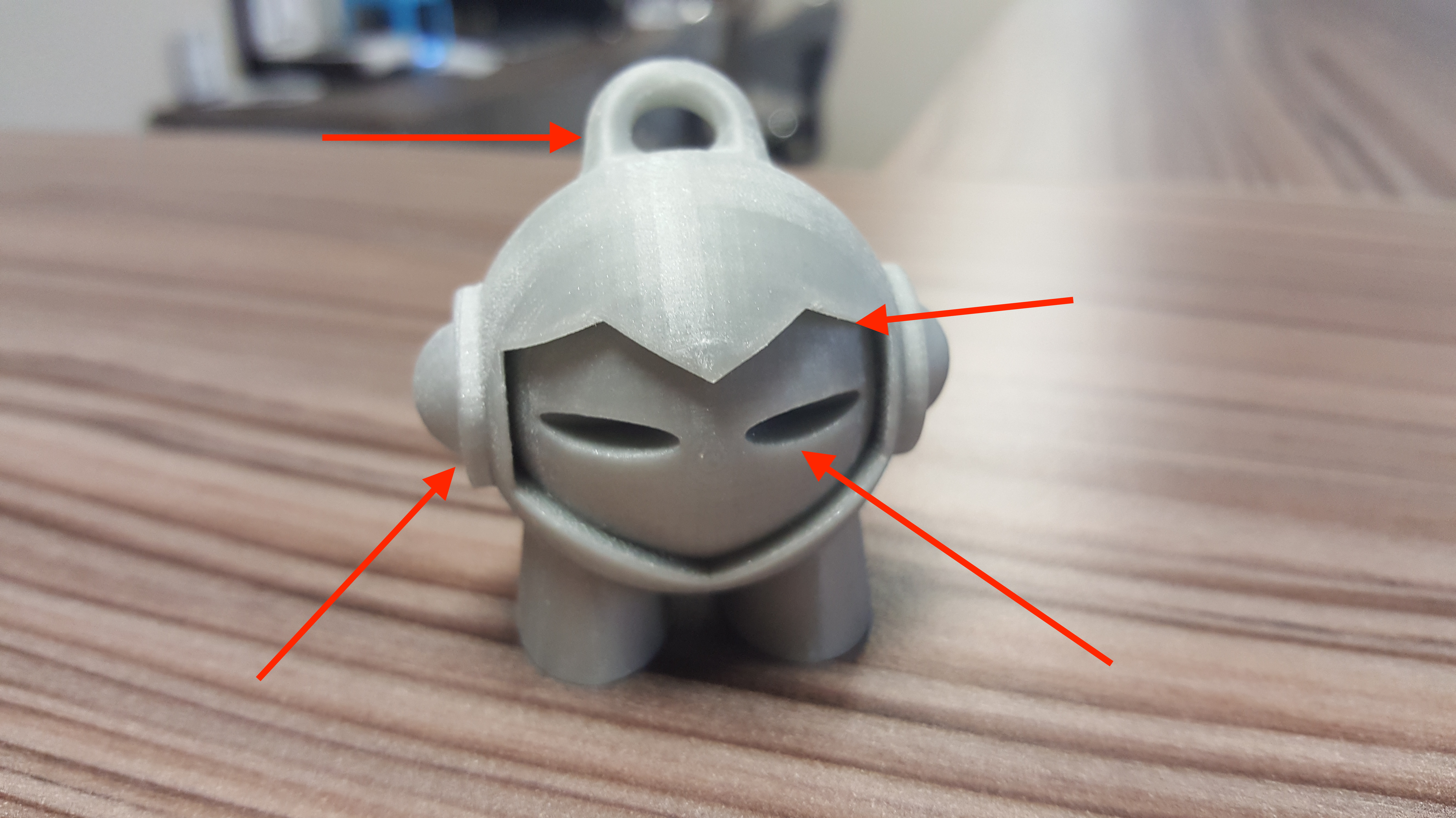

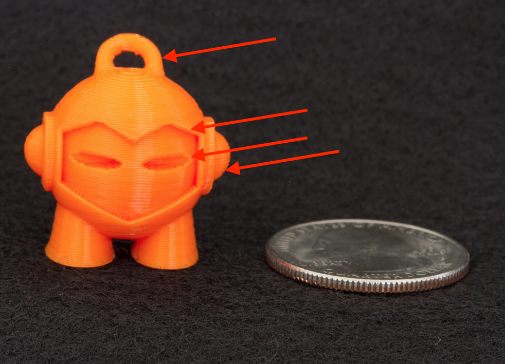

  • Quality:“A good Marvin is defined by having clean, sharp edges and a smooth surface throughout all the surface.” If you can describe your Marvin using this quote, you’ll receive 5-stars.
    Does it mean that you can’t achieve 5-stars with an FDM printer? No, of course. We know that SLA 3D printers are capable of more precise prints then FDM machines. We look at the layer height, material and colour listed on the order page and we know what to expect from a Marvin printed using those specifications. When printing you should pay extra attention to the following parts of the Marvin model:

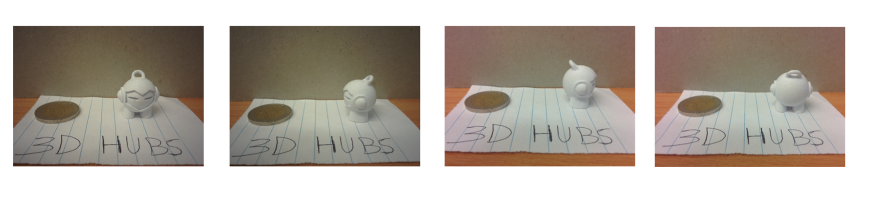

  • Service:
    “Handwritten note and multiple pictures from different angles.” Four good pictures are enough. What defines a good picture? It’s the possibility for admins to check the small details of your print. Here you can find an example:
    Pro tip: Add photo’s of prints while the model is being printed to the order page as well, customers love seeing “work-in-progress” photo’s of their designs being printed.

I’m glad my test marvin photo was good enough to be used as an example for other hubs! (The orange FDM marvin)
I’d appreciate it if the hubs that took these photos are credited in the post and contacted to let them know. I had no idea my photo was here until I opened this thread. Thanks!
