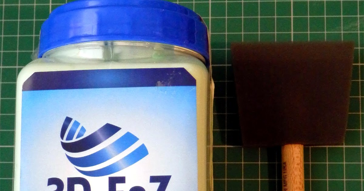

plus have alook through this for guidance - in the message below

on glass with hairspray/pva/kapton?
