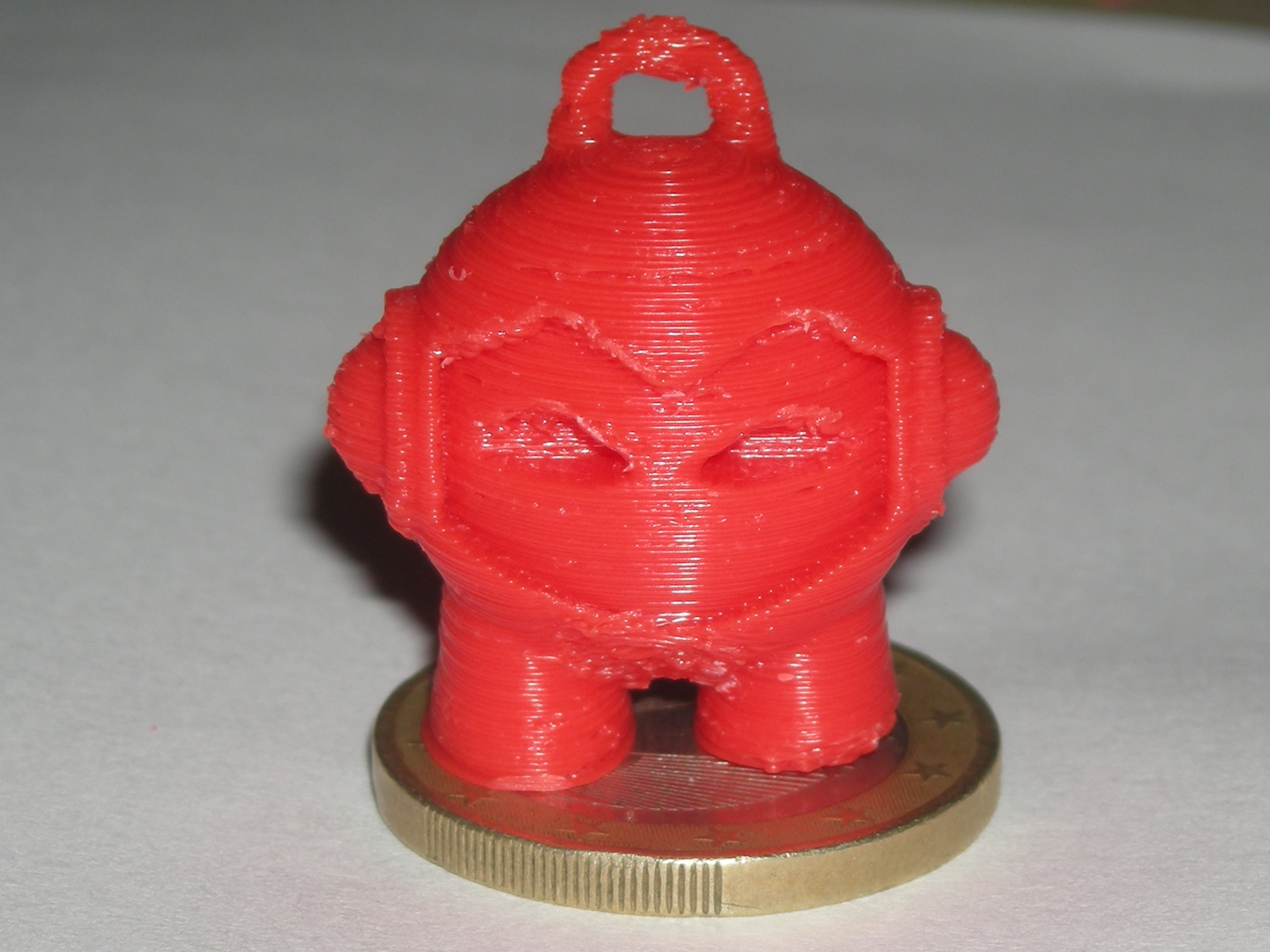

@Jozef also mentioned that DaVinci has the potential to be equal to the much more expensive printers but you may have to stick to the custom firmware. Slic3er + Reptier host can be the tools that could turn everything around. with your print.
Here’s his print which is indeed quite an accomplishment!

Good pointers mine came out excellent just like your pic on my Davinci 1.0 A.i.o with your settings.
Cool stuff! Would you share a picture of your Marvin?

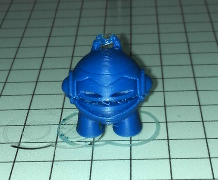

I printed a lot of this marvin but none came out good , if I use the xyz software the extruder ooze onto the print leaving dots of plastic that I have to remove when it finished printing (210° extruder and 90° plate + abs ), but if I use slic3r I can set the retraction and it doesn’t ooze , but still with 4 marvins at the 4 corners I can’t still have a good print cause the hole for the keyring doesn’t came good , in the pic is the best one till now
