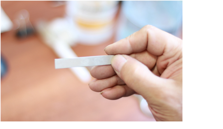

  1. Prepare bitmap, which would be applied to the aluminum surface of the plate.
For example, here is this:

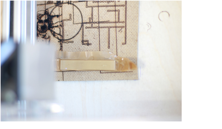

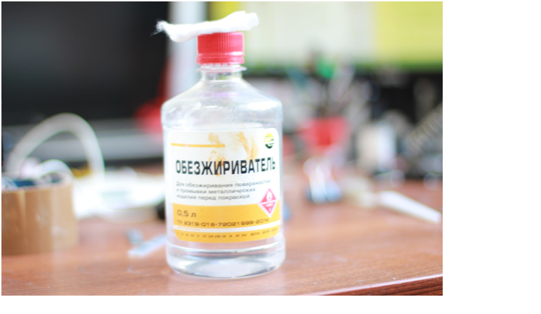

  1. Cover the aluminum plate surface with a protective film (adhesive tape, paint, paint on the selection).
  1. Place the aluminum plate on the top of 3D-printers equipped with our (specify how) laser, and include laser cutting mode (to remove the tape and pasted to create open areas in the future site of the engraving).

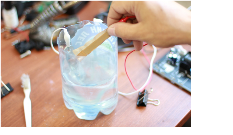

  1. Next, in the plastic container we prepare a concentrated aqueous solution of NaCl.
  1. From the source of electric current terminal 2 wire “plus” and “minus”.

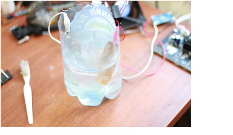

  2. To connect the positive terminal with our aluminum plate and also to omit the salt solution.
  3. Power on
  1. Starting the electrolysis process (etching) in solution. Depending on the strength of the current and the concentration of the solution can estimate the approximate time necessary for etching. Usually 3-5 minutes.

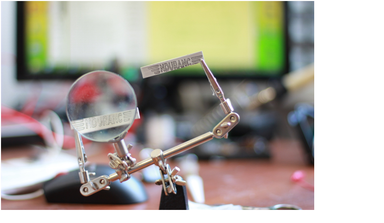

  1. We take the product out from the solution.
It must be remembered that the engraved product before being placed in the solution should be carefully isolate the exception of those areas where, in fact, engraving is to be applied.

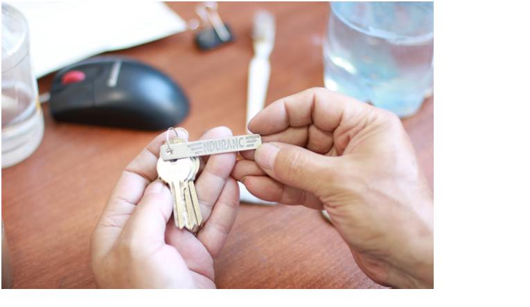

With this technology, anyone can become a master of engraving on metal (aluminum).
In our opinion, this technology has great practical value.
