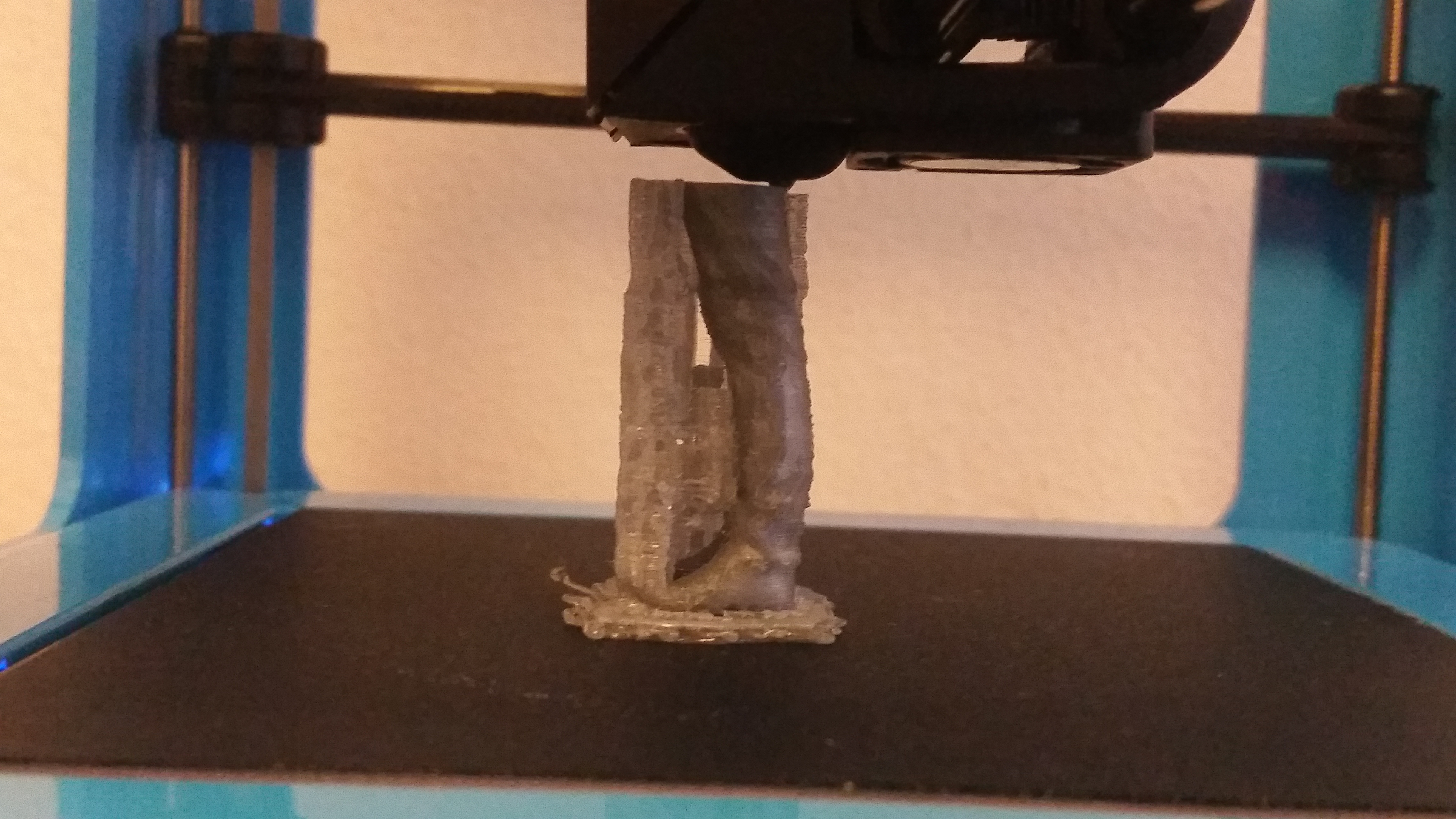

Printed myself on the M3D :slight_smile:
Got a bigger version printing, so that should be done soon aswell!
