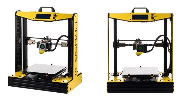

I am really interested in purchasing a 3D printer and have done research one some of the models. However, I came across an interesting feature of the RigidBot and that is the fact that it can have an adjustable build area. I’ve browsed other models to see if that was a solo case and it seems like it. I do like the RigidBot for this but the reviews on the parts make me skeptical of getting one. Is there a printer that has this that consists of better quality parts?

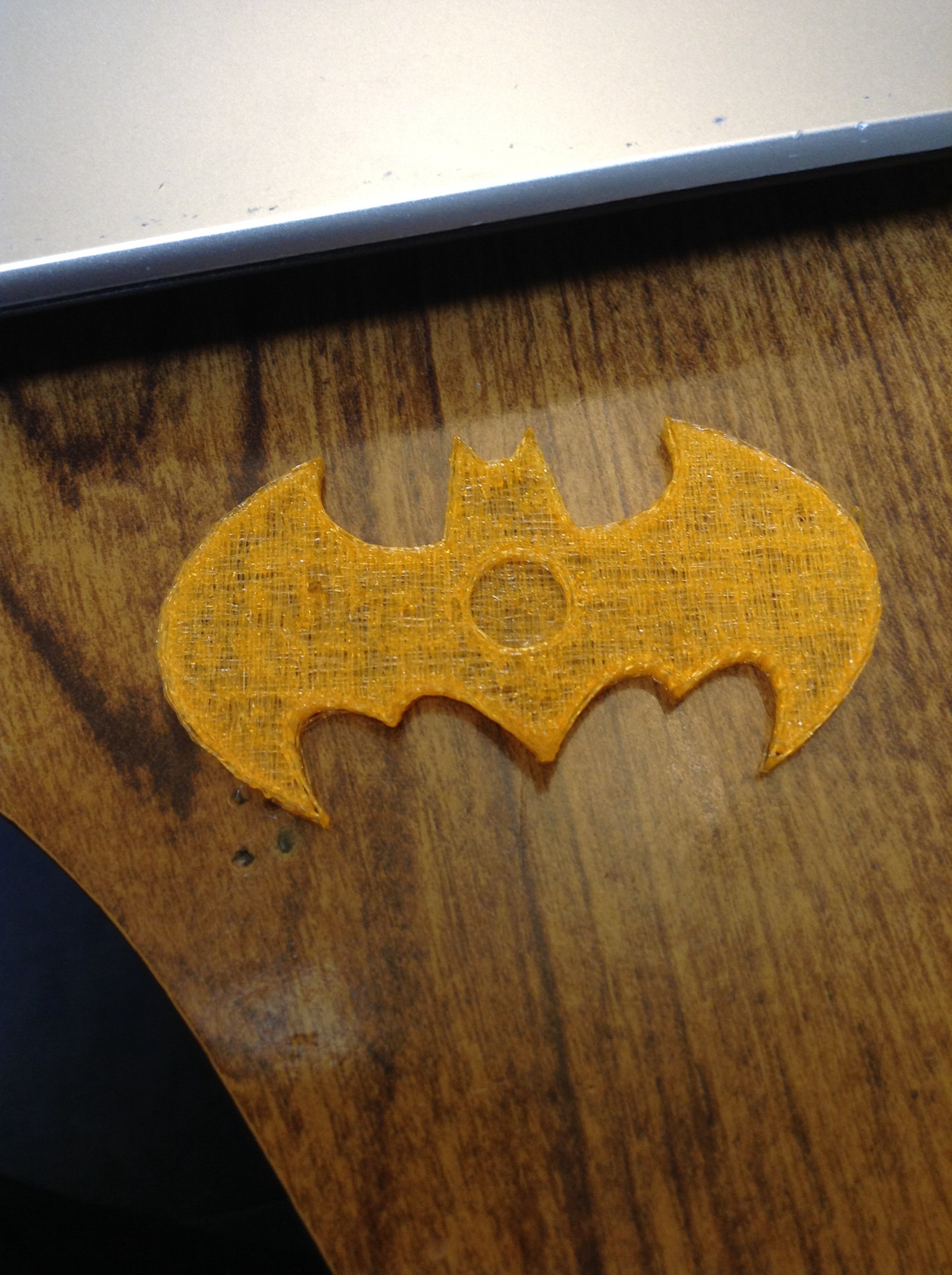

Hello Joel, my teacher had a rigidbot in a robotics class I took. He was very happy with it, and he has used it to create a ton of prototypes. I do not have first hand experience with it, but my teacher had great experiences with it. One thing to be aware of: it does not print very high quality. So it depends if you want to make prototypes or high quality sculptures. The picture below is a quick print from my teacher’s rigidbot.

What exactly do you mean by “Adjustable Build Area”? Tell you about MY printer we hope to start our Kickstarter soon. Most machines have 1-+ extruders for printing different colors on the same part. This does not increase the speed in which multiple parts can be made. We have used our machines on high production runs since I have up to 3 extruders printing 3 parts at one time. Base with 1 extruder has an 18 x 18 (X/Y) heated build area. Adding 2nd extruder makes it 2- 9 x 18 machines, adding 3rd makes it 3 - 6 x 18 machines.
Since my machine is all components it is very easy to make it any size someone would want. With changing the frame rails can make it any dimension without changing the overall design or function of the machine.
Here is one we have in use at a manufacturing facility, it is 18 x 18 x 18 build area.
I was hoping for something in the 2-1500 range. Nothing too expensive but something that has the area in looking for. The bigger the better I suppose.
As for the precision of the unit, I’m not to picky. I was planing on making large replicas and printing individual pieces so that they could effectively snap together. As for the material, as long as it’s going to be realitively durable (ei: can be handled and manipulated) I’m okay with it.
That’s kind of what I had in mind. That’s what drew me to the RigidBot was the idea of be able to replace the arms of the machine itself for longer ones to increase the build area. I’m new to the prospect of 3D printing and wasn’t sure if this concept of adjustable machines was unique to the RigidBot or was something other printer could do.

The RigidBot can print much better quality than that. I print daily at 100 microns. This looks like it just wasn’t printed well. Some settings need to be adjusted for sure.
