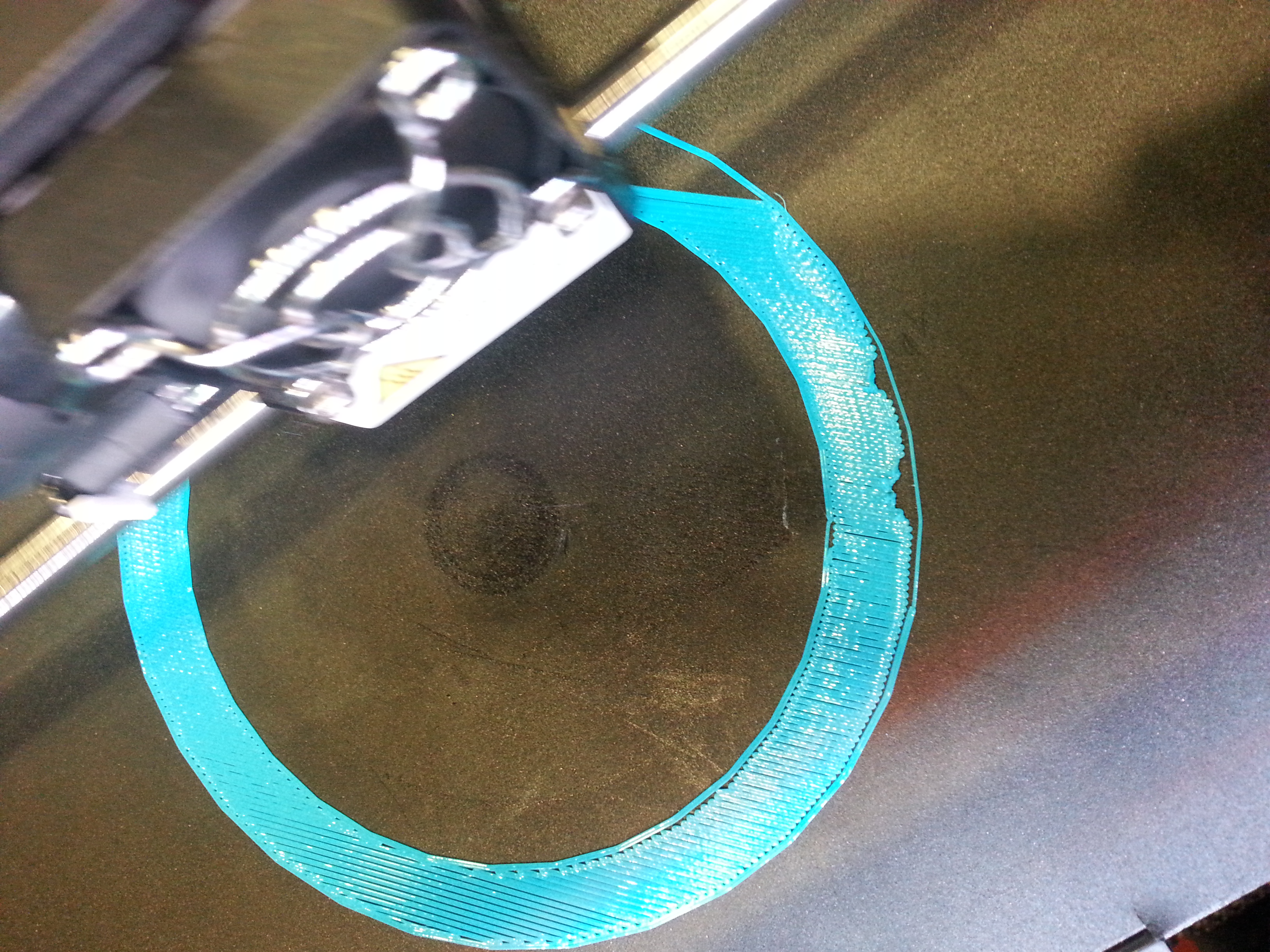

I use a slicing software called Simplify3D and it only happens in that software (I’m sure its just a setting). If I use the makerbot slicer it doesn’t do this. The PLA is simply not reaching the edge of the outline as in the picture. Anyone familiar with Simplify3D or similar that knows what I should do?

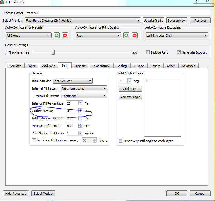

This would be most likely your outline overlap setting, in simplify if you go to the Advanced Tab under process and go over to infill, there is a section for this setting. Does this only happen on the first layer or is consistent throughout?
Increase your first layer height/width. Your extruder is not close enough to the bed, if this only happens in the first few layers.
Simplify3d defaults to 90% first layer height.
I agree with this, if its only the first layer or two, the material just isnt being placed in the proper place. Try leveling closer to the bed. I find a thin piece of graph paper works best for me, standard computer paper is often too thick, especially if its fairly nice feeling paper.
I use a rep 2 and S3D. It looks like your nozzle is too far from your print bed. On the left of the photo, it looks ok, but the right side is way off. Be sure you are correctly leveling your bed. It could also be extrusion multiplier but I don’t think that’s it. Check your origin offset under the g-code tab and see what it is set to. Also check your first layer height setting under layer. I don’t have my program in front of me, but I usually do between 80

Definitely looks like a leveling issue. Left side of print is fine, bottom and right has gaps between beads of plastic and you are not reaching the border.

I think that, as mentioned elsewhere, changing the outline overlap fixes the majority of this issue.

I had the same problem with Simplify3D, its not a leveling issue, thats been checked and rechecked. I can print a file sliced with Makerbot Desktop and it comes out perfect, then i can print a file sliced with Simplify3D and its missing the edges and the layers aren’t consistent. Sometimes it will make it out to the edge of the shell sometimes it leaves a gap, makes for a really chunky looking print as the layers are not consistently lacking in the same spot each time. But then i can print that same file sliced with Makerbot Desktop and its perfect!

It fixes the majority of it, but it doesn’t completely fix it. Thats the problem, if i’m going to use a piece of software it needs to work or not. I don’t get how MD can do it for free but S3D can’t for how much i paid for it. I still have a couple open support tickets with S3D from six months ago that never have gotten resolved.

It can be a leveling issue because the overlap also is affected by the squeeze out of the bead. Things that affect this are the overlap, extrusion multiplier, filament diameter and how close to the nozzle you are leveled. If it happens on all areas of the bed, bump the multiplier up. I set mine to 1.0 on the first floor layers, then .9 on subsequent layers. If it only happens on that one side, raise that corner of the bed by 1/8 turn. Let us know how it works out!
It does not look like a software issue. I personally have used S3D for several years and not had an issue on my REP2. If you don’t have your machine dialed in (leveled, extrusion multiplyer, etc.) Then it won’t work. The reason MD does is because they remove choices that S3D gives you. You can get much better prints more consistently in my experience using S3D. But with more choices, come more places for problems to arise. Start adjusting one thing at a time that has been suggested, starting with making sure your bed is super level and not warped (stock rep 2 build plates warp really bad). Then do a test print. Then, change something else until you figure out exactly what it is. Or, forgo your options and use MD
