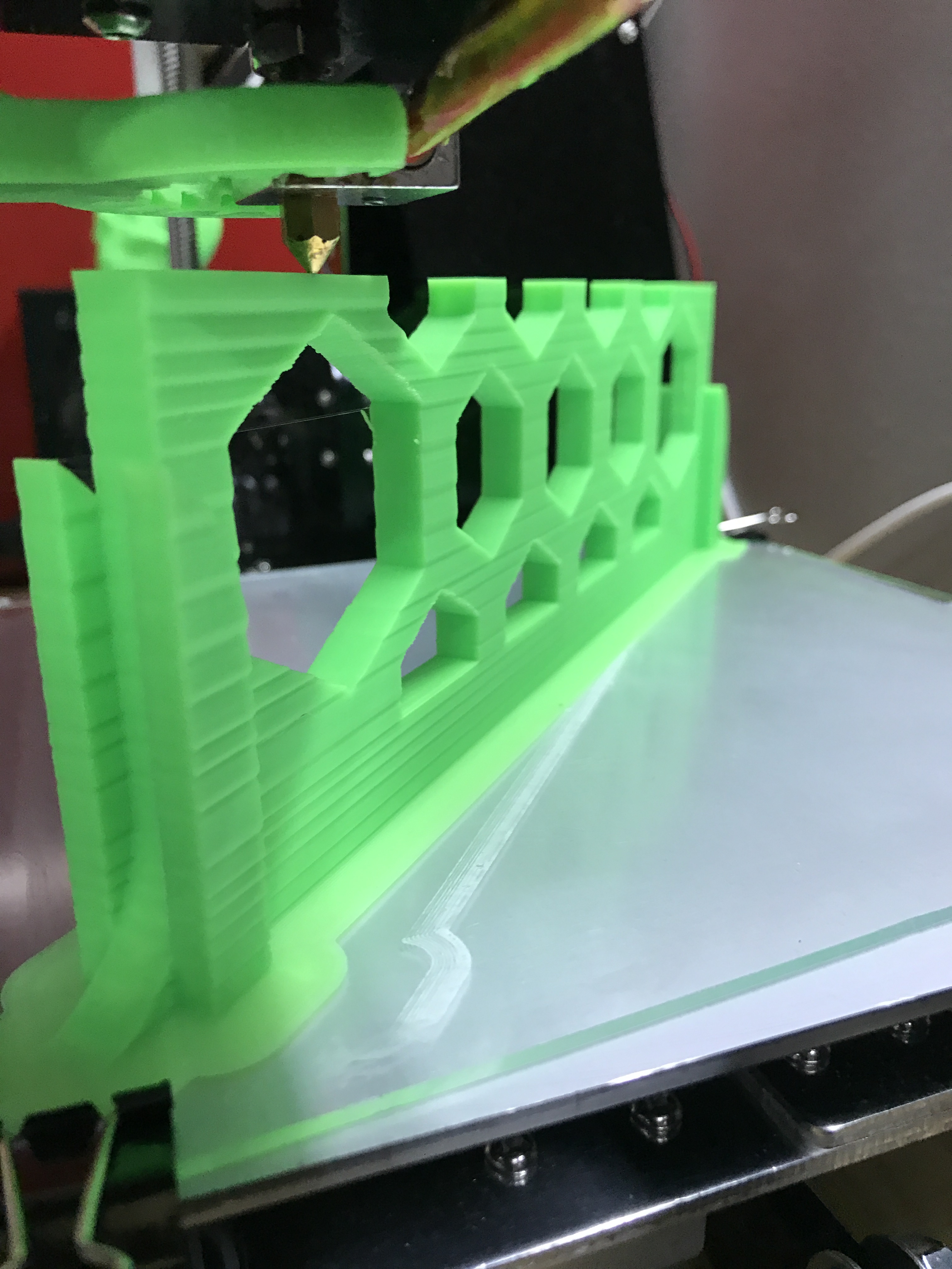

I just did my first large print and it has some inconsistent lines along the surfaces.
The lines are only on the 2 sides of the print, and it was printed diagonally on the print bed due to the size.
And idea what is causing this issue?
Printer is an Anet A8.
Thanks!
I would look at the Z lead screws to see if they are bent or binding somehow. Just my first thought.
Check your X and Y belts, could be loose.
Given the spacing and shape of the lines, I would agree with Wirlybird. It looks like Z wobble to me as well. Lead screws, or maybe a coupler/motor out of alignment with the lead screw nuts.
