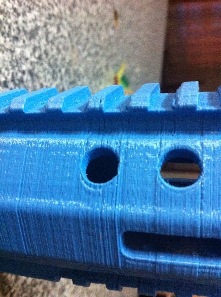

So, I sometimes, not always, get some weird defects in my prints.
I use a i3, with a 0.4 Witbox Extruder and Nozzle mounted on a P3Steel (200x300x220) and slice with CURA.
For this print, I used
- 0.20mm layer
- 10mm/s for outer shell (2mm thick)
- 40mm/s for inner shell
- 60mm/s for infill, with infill at 100%
- 130mm/s travel
This look like under extrusion to me, but sometimes, it looks like OVER extrusion, so I’m a bit confused. The filament is from BQ and I believe it is not bad quality and I cleaned my nozzle bore just before printing.
Here it looks like the exterior perimeter is larger where there are feature of the path of the filament,… is this a CURA problem ? :-X
Another angle for those “wider” layers when there is a feature in it,…
Also, I thought that wavy pattern was a result of printing too fast ? I printed the outershell at 10mm/s but still does that :-/

At which temperature are you printing? I had similar effects when printing too hot, and get good results now at 200°C with bq filament. Additionally one of my threaded rods for the i3’s Z axis was bent, which could be observed by crazy wobbling in circles at the top while the Z axis moved. I just replaced it with a new, straight rod.
I print at 220ºc indeed, once this print is finished, I’ll try at 200ºc as you said.
My BQ 5mm rods were also bent !
I now use 8mm stainless steal rods, they are far more picky in terms of correct bolt alignment when fusing it to the X-carriers, but at least they are perfectly straight.
Thank you very much for you answer !
I think you might have the speed/temperature combo wrong. Especially if you’re printing the outer shell in 10 mm/s and the temperature so high. I’d say you don’t have to go that low in speed and that high in temperature. Can’t give you the exact numbers , because I don’t know this machine but 200 sounds a very fair attempt.
I got hurt once by playing around with the shell thickness and am now very conservative when changing that. If nothing else works try setting that to the default.
