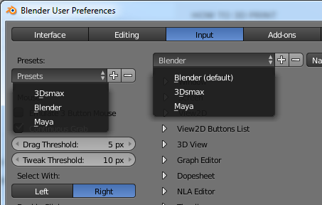

I would suggest Blender. And… If you think it will help… Check the User Preferences under the File menu. You can set it to respond to commands as if it were some other program. Here is an image showing some of the presets that exist (this is a composite image showing two drop-downs open at once):
Have fun with it.

Thanks RCole, I’ve not noticed that in Blender before, I’ll check it out. Sounds like there’s a lot of votes for Blender here, so I’ll give it go…
