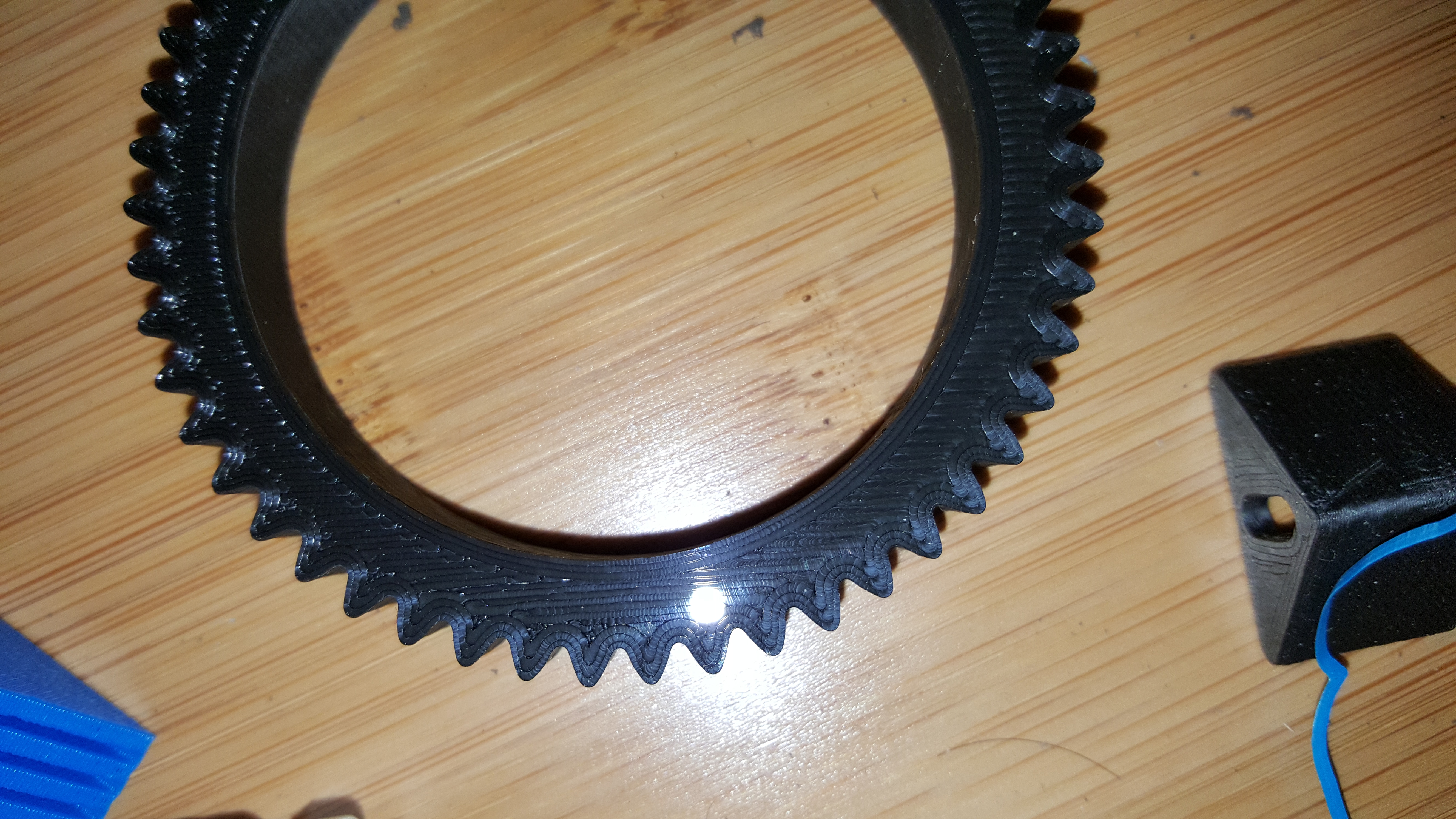

I just upgraded the bed on my Flashforge Dreamer to a mirrored bed. I mainly did this to have better support for printing nylon and switching out the bed per print.
Little did i know though how much my prints would improve with the glass bed. I have only printed a single test print so far but I am speechless at the glossy finish that resulted on the surface that was touching the print bed. The heated glass kept the PLA stuck very well with no issues and when the temperature dropped the part literally fell off.
For Anyone contemplating on upgrading their print bed to glass or mirror, Do it now! you will not regret it. I have no idea why I waited this long.
I have including a few pictures although the glossiness was very hard to capture, you can see reflections on the surface. I have also included a reference part that was printed on buildtak for comparison. While the camera might not be able to capture it, the difference in person is miles apart.
- light reflects right off the surface unlike the below identical part printed on buildtak.
-on Buildtak
-side by side comparison. Left is glass right is Buildtak
