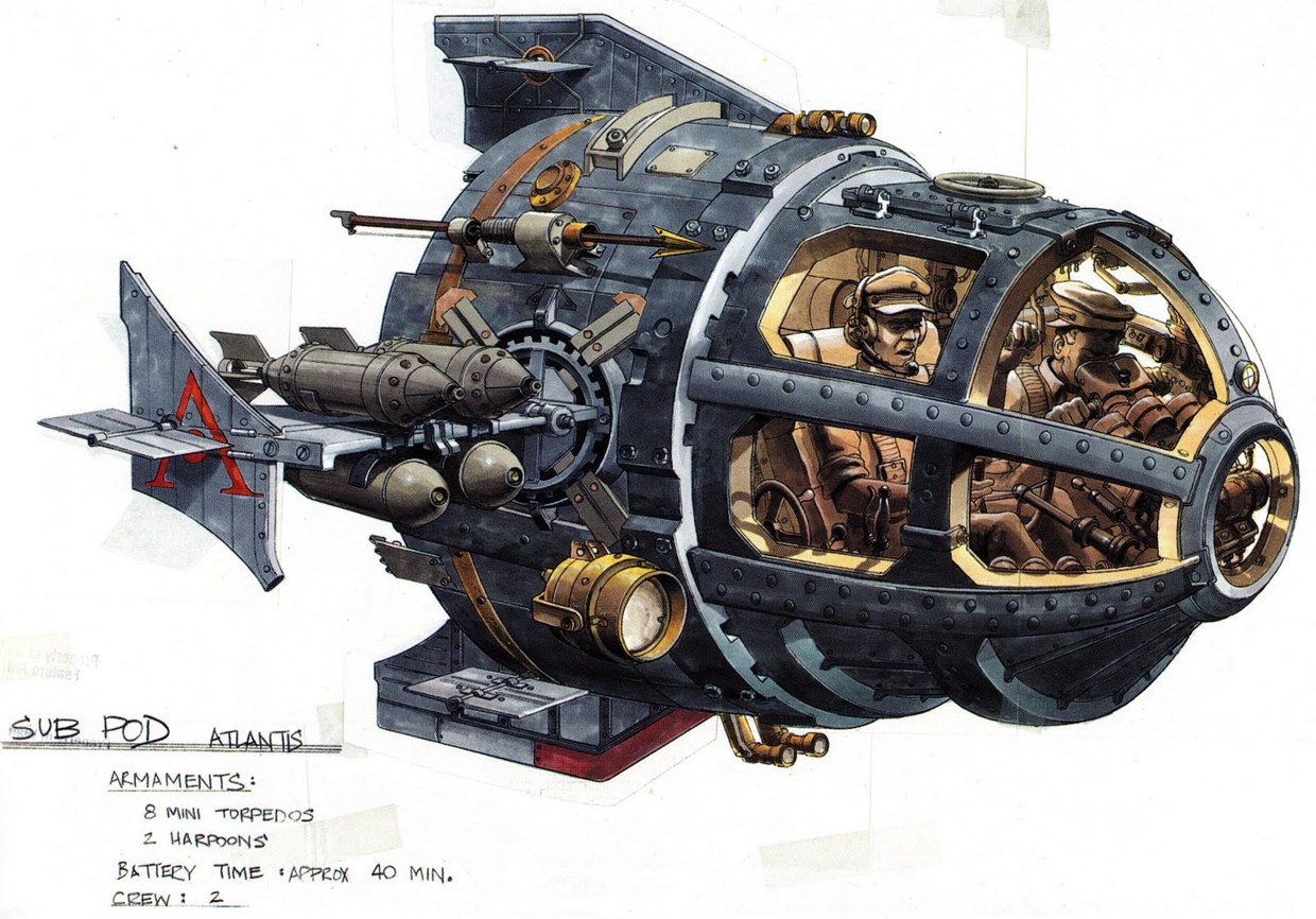

While getting some inspiration on Pinterest I came across this concept sketch of a Steampunk-looking submarine. I always like concept art, mostly because it doesn’t see the day of light in production and I find it a challenge to create it in 3D and even more: print it! How cool is it to have something in your hands that was actually just conceptual! :wink: Anyway, apparently this piece of concept-art is from the animation movie “Atlantis” by Disney. I really don’t know who designed the concept so I can’t give any credits to it. I took it upon myself to see if I could actually model this in 3D and have it printed in detail.
The concept drawing that I found…

Main purpose here was to see if I could brush up my modelling skills in Zbrush and model the whole thing with that software. Zbrush has (or had these days maybe) the reputation of being a bit difficult if it comes to do some hard-surface modelling but it can be done. Pretty good actually. I didn’t have any side-reference pictures or anything so I had to eyeball this one.
I also had to come up with some ideas of how I was going to model and print this. Once again, you really have to plan ahead. What parts are going to be part of some main objects and what will make really separate?
Some views on the final version of my model…
Taking my printing resolution in account, I can’t go that detailed. For example, I wasn’t sure that the “spear” on the side of the main body would be printable as with the “missiles” on the wings. I decided to create and print most objects separate so I could print it in a bigger size. A quick tip on this is just to check what part is going to be the biggest to print. Everything else will be surely printable as it is smaller.
In this case I wanted to do the main hull of the sub, with the window archs, as one object, mainly to have it at strength. The back engine part I would do separate. So I printed the main hull upwards on my printer so it would come out as smooth as possible (with this printer though…). So all the wings, fins, engine, missileparts, periscopes would be separate. On top of that I modelled some interior with chairs and console/steering housing.
