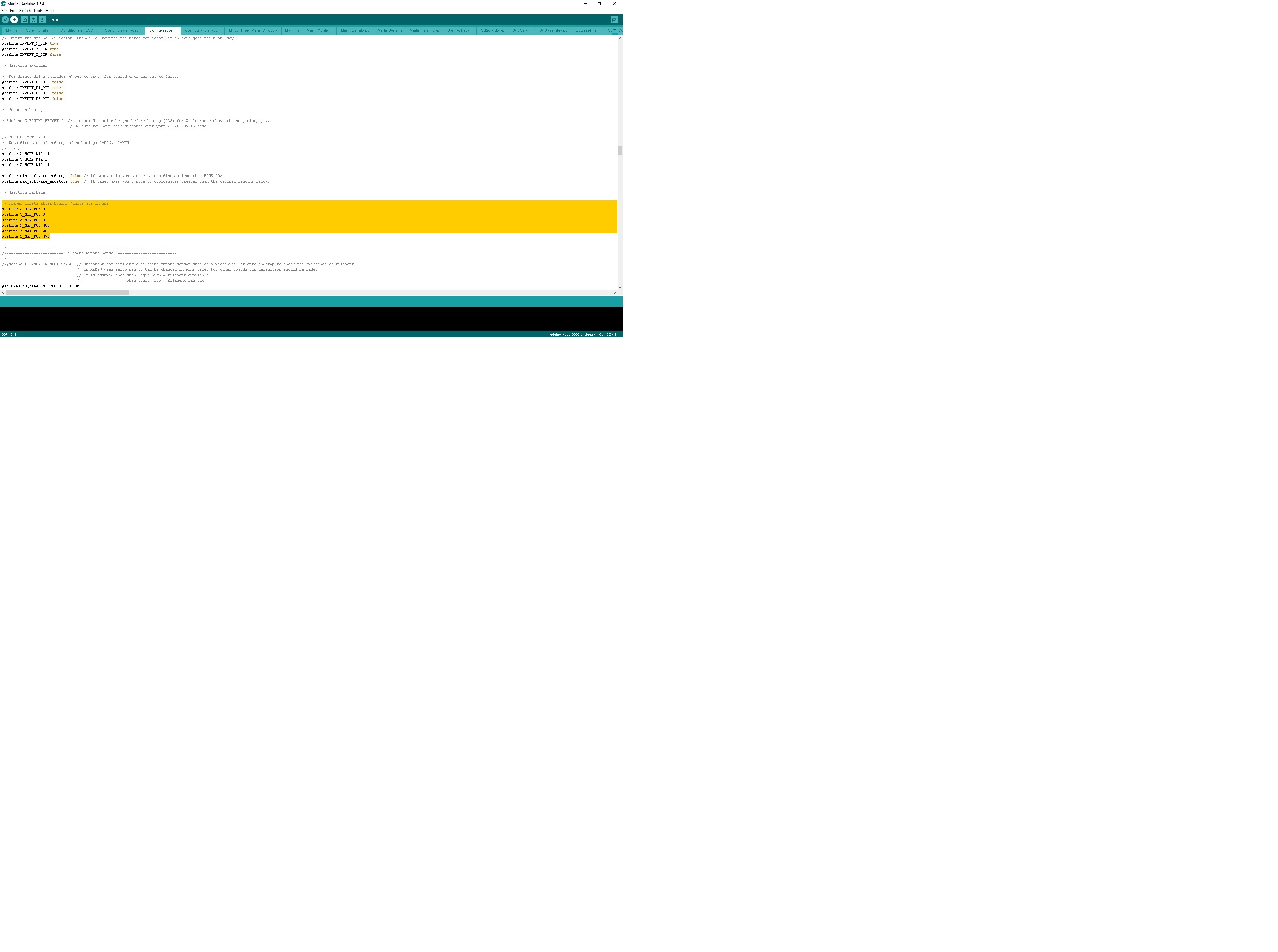

something is definitely wrong with my x limit switch or the programming is confused because it will run all the way to home on the right and try to go further. As far as the z axis, I can not figure out why it’s so slow and gritty. it seems to have a stutter when moving and sounds like there’s something working against the motor. I ran the BL touch and the sensor touched the bed but still tried to run lower than the bed level.
Well Joe, when you send the machine home it should go left until it hits the x limit. The x limit switch should stop the motor and the limit tells the controller it’s X zero position. I’m not sure but it sounds like from zero on the left if it is running too far right, the span might be defined incorrectly in the firmware. Or maybe the X limit wiring isn’t seated. You can try tracing the wiring from the limit switch back to the control box and make sure all connections are good. There is a section of firmware that defines the size of your bed. Once it hits the x limit and knows zero position, it should only be allowed to move 400 mm to the right. There is also a section that defines how many mm/step your motor moves the bed. These have to be set right, but I would think they would already be set in the original firmware. I’ll try to find these settings. They may be restored if you reload your firmware.

Thanks for all the help and input Frank, I really do appreciate it. You said the firmware should be on my SD card? How do I check which firmware I’m on in my machine and where is the file located on the SD card?

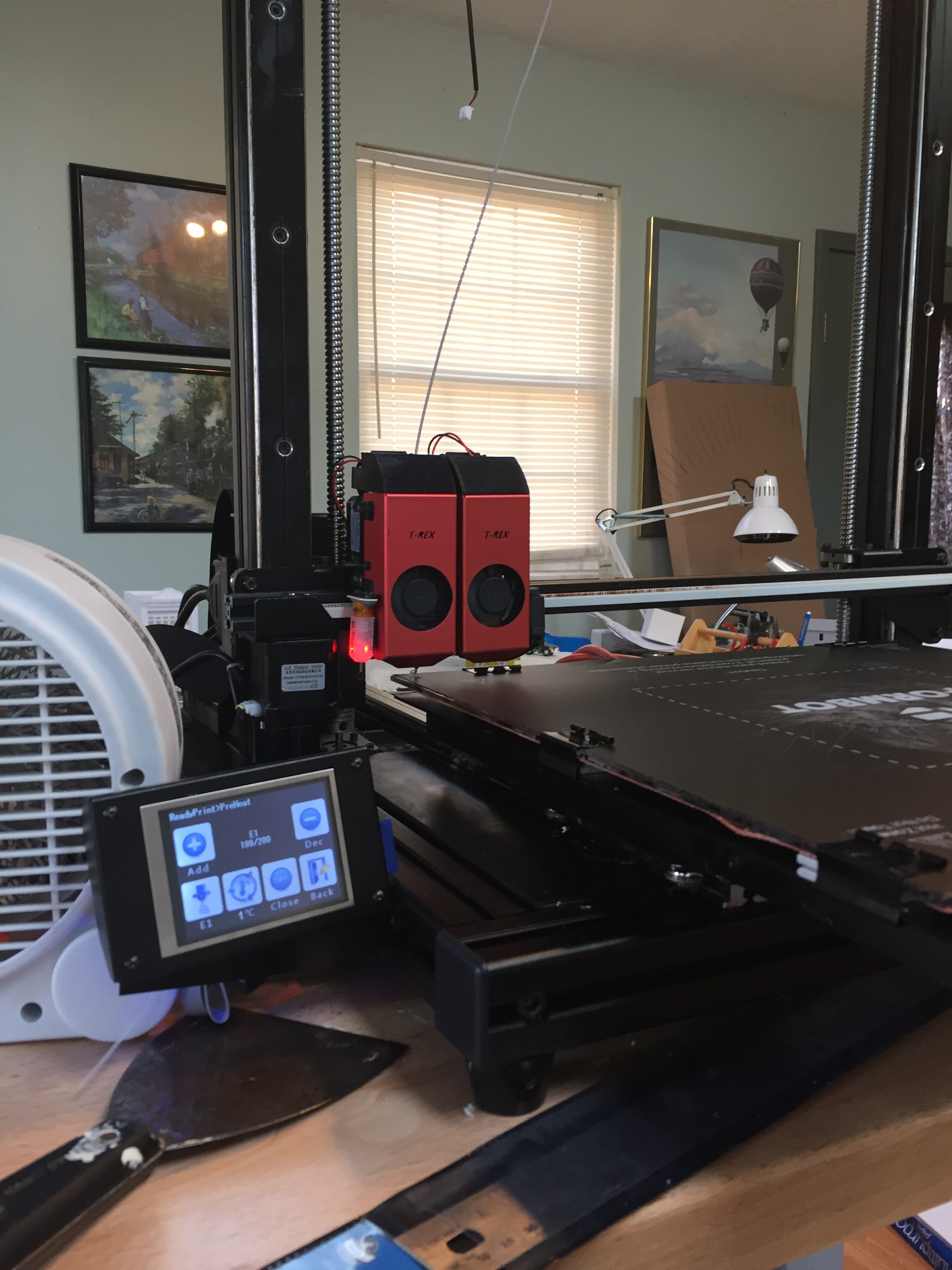

Sorry for taking so Long Joe I had to work today. So I think I may have found out what happened to your machine. So you are using dual extruders. In Formbot’s instruction to use dual extruders they tell you to set the extruders 200 mm apart. I don’t use dual extruders because my prints are usually to large to allow for dual extruders, ( I sent a picture of how my extruders are arranged, right next to each other.) If you use dual extruders and set them up 200 mm apart, you need to change the travel limits in the firmware to 200 mm*400 mm*470 mm. If you don’t do this the controller will think it can still drive your extruder 400 mm span and it will drive your second extruder right off the bed. I’m trying to attach Formbot’s manual that tells this.
As for the firmware, if you look on your SD card, under Marlin Firmware / Marlin / Marlin.ino. Marlin.ino is your firmware file. Double click to open it up. If you look under the configuration.h tab then select edit and then select find, search for "travel limits" . Before you make any changes, make a copy of your original firmware. Change the travel limits to 200, 400, 470. To download the changes, notice I’ve highlighted the upload button in an attached picture. Connect the provided USB cable to your printer and select upload. Arduino will search for your machine and if it finds it, will load your changes to the printer. I’m having trouble attaching pictures, I think I need to reboot my computer but I will log back in and attach pictures in a separate reply.
Hi Joe, these image files might help you understand what to do. I may be wrong, maybe you didn’t set your extruders apart, but it sure sounds like that’s the problem
