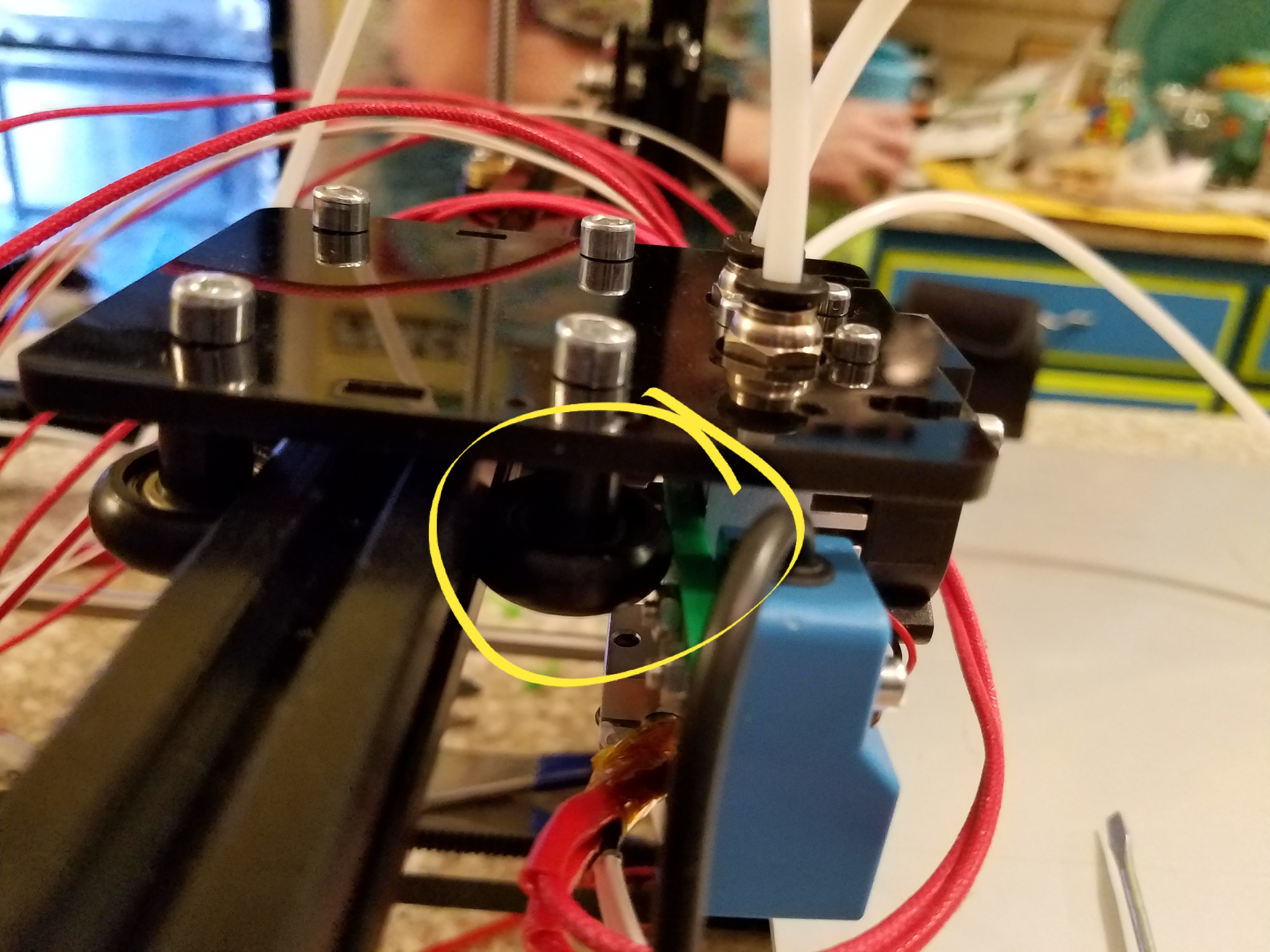

Anyone built a DIY Flsun 300x300x420mm Plus I3 3D Printer Kit with Heated Bed and Dual Extruder w\Touch screen? I am in the process and have a problem with the chimera extruder setup. In short There is no clearance for one of the guide wheels and I am still waiting to hear from Flsun. Any advise is appreciated
Hello, I’m bulding the same printer and have same problem.
How did your resolve?
Thanks, Roberto

FLSUN sent me an stl of the mount that was supposed to (but did not) fit. I ended up using Sketchup to draw a mount and printed it on my other printer. I can send the stl to you if you have access to another printer. I have since changed to a capacatince sensor and a glass bed which i also had to draw and print the mount for.
Good luck

I worked on all night and yet manually modified piece.
I also ordered a glass plated cause aluminium plate is too low positioned…
I hope to print my first piece today.

I moved the extruded platform to the bottom of the bar.
image|500x500
I also used some plastic sheet stock to make a auto level sensor mount. But it will still work with the printed sensor mount.
