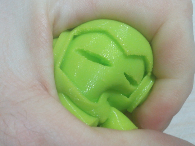

Hi, it is green Filaflex from http://www.recreus.com. You can read all about printing with flexible filaments, over on my blog : How to 3D Print with Flexible Filaments - Gyrobot Ltd - CAD Design and 3D Printing

Flexible materials does not need to be very difficult but some things needs to be kept in mind. Like for instance:
-a good feeding of material - low friction all the way to the melt-zone (or else the print will be uneven)
-a good extruder feeding mechanism that keeps the pressure on the softer filament (spring loaded is good)
-a good support directly under the feeder wheel so that the filament cannot escape
-start slow and ramp up the speed to check the limits
-nozzle diameter matters: small gives more counter pressure -thus slower speeds
-nozzle diameter matters: bigger gives a better bond between the layers and makes for higher speeds (I use 0.7mm)
-different soft material filaments will behave differently (for instance my ETPU will not give much problem with “spider web”)
-Be careful with what print table surface you use, if unlucky the material can bond so hard that it is impossible to separate (I personally use blue tape, glass or PVA-glue right now)
