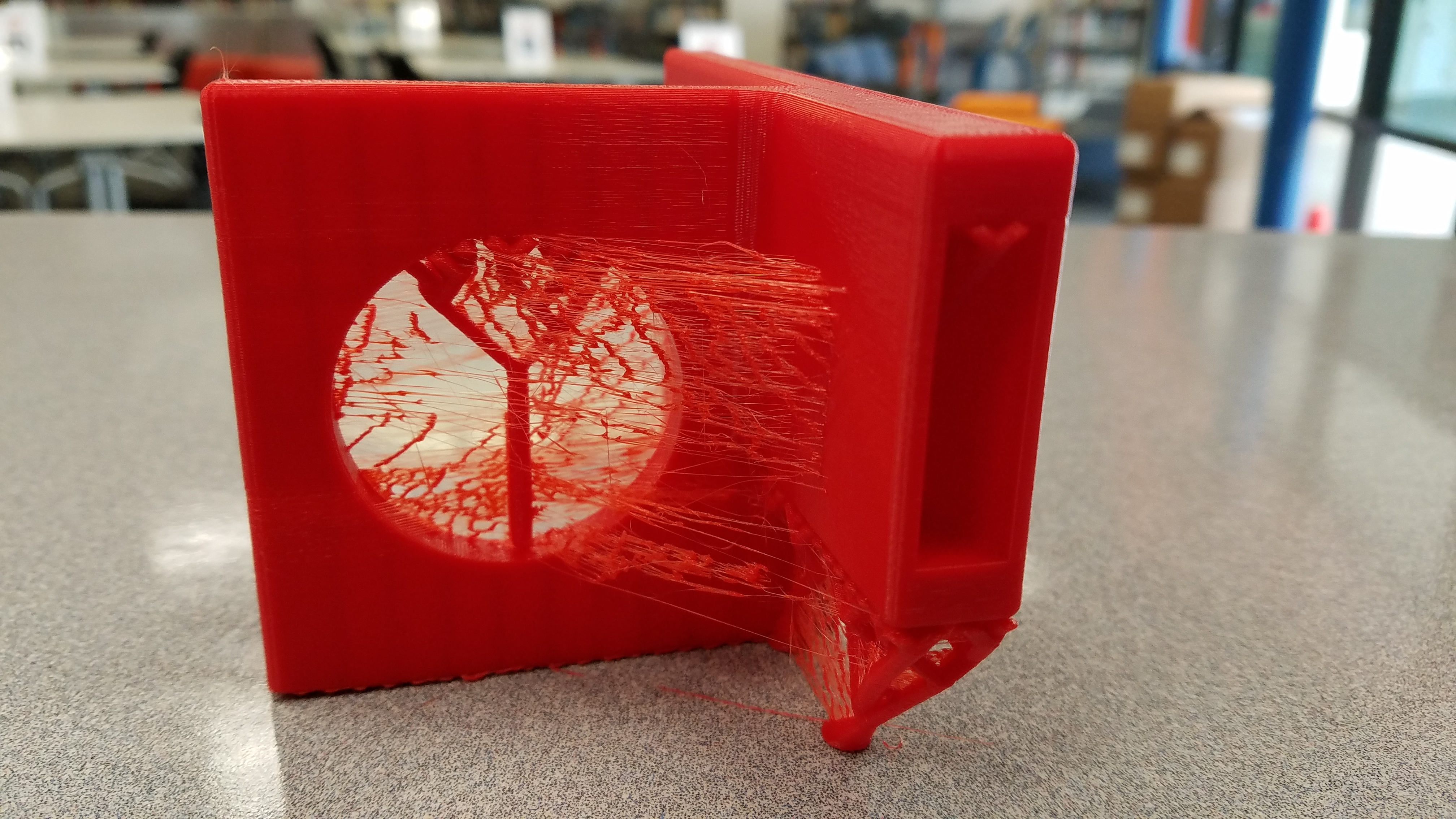

![20181029_102557|690x388] My apologies for taking so long to upload these, but this is what I am talking about when I said “stringy” filament. Yikes! Any ideas on what the problem may be and/or how it can be fixed?
Many thanks!

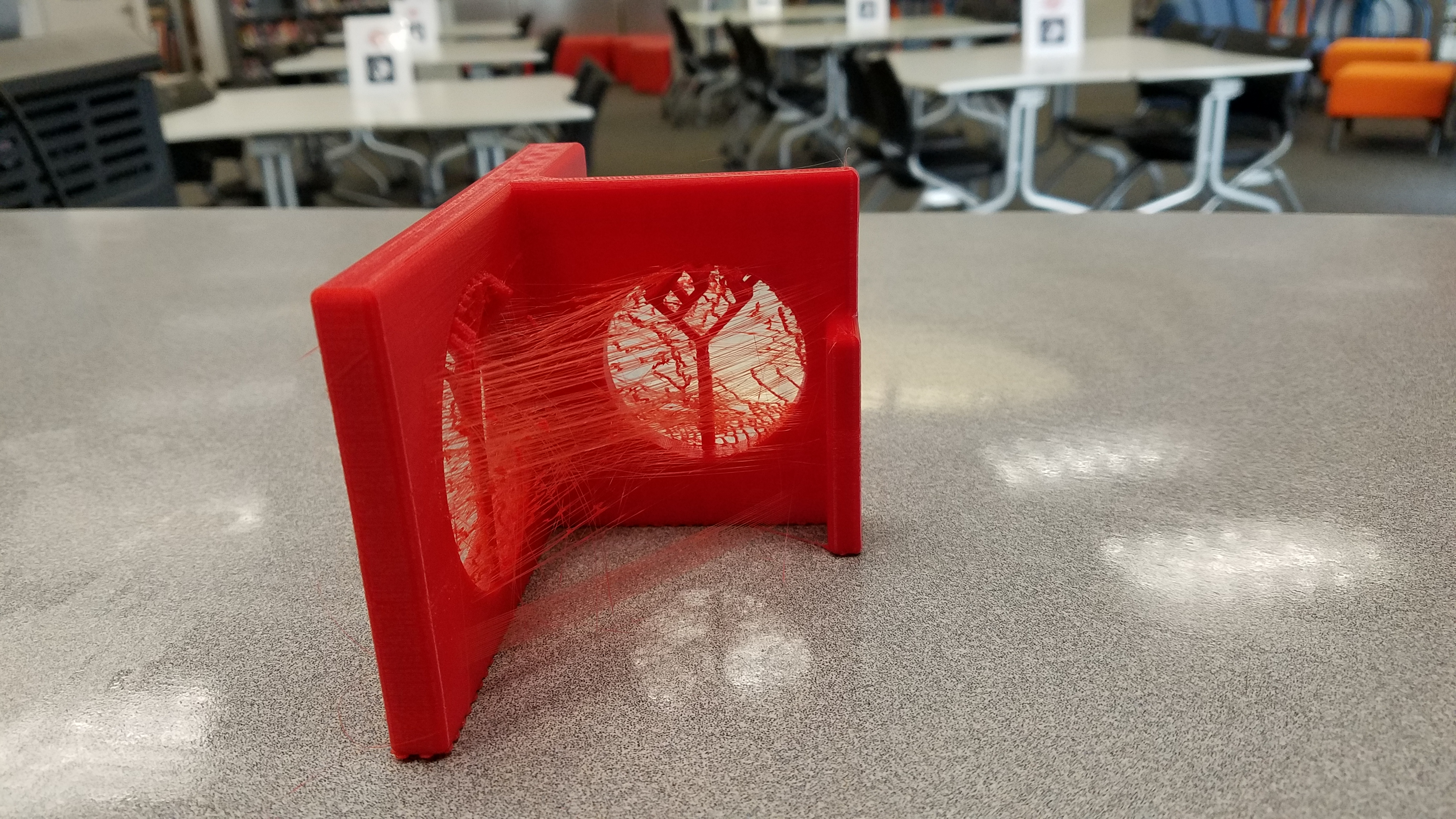

Another angle and a little closer.
My first thought is extruding too hot. I am assuming it is PLA.
Yes, PLA. I will try to print again and reduce the temp. I believe the Finder defaults at 220. What would you recommend? Thanks!
See what the recommended temp range is of the filament, usually on the label. 195-205 is pretty good.
