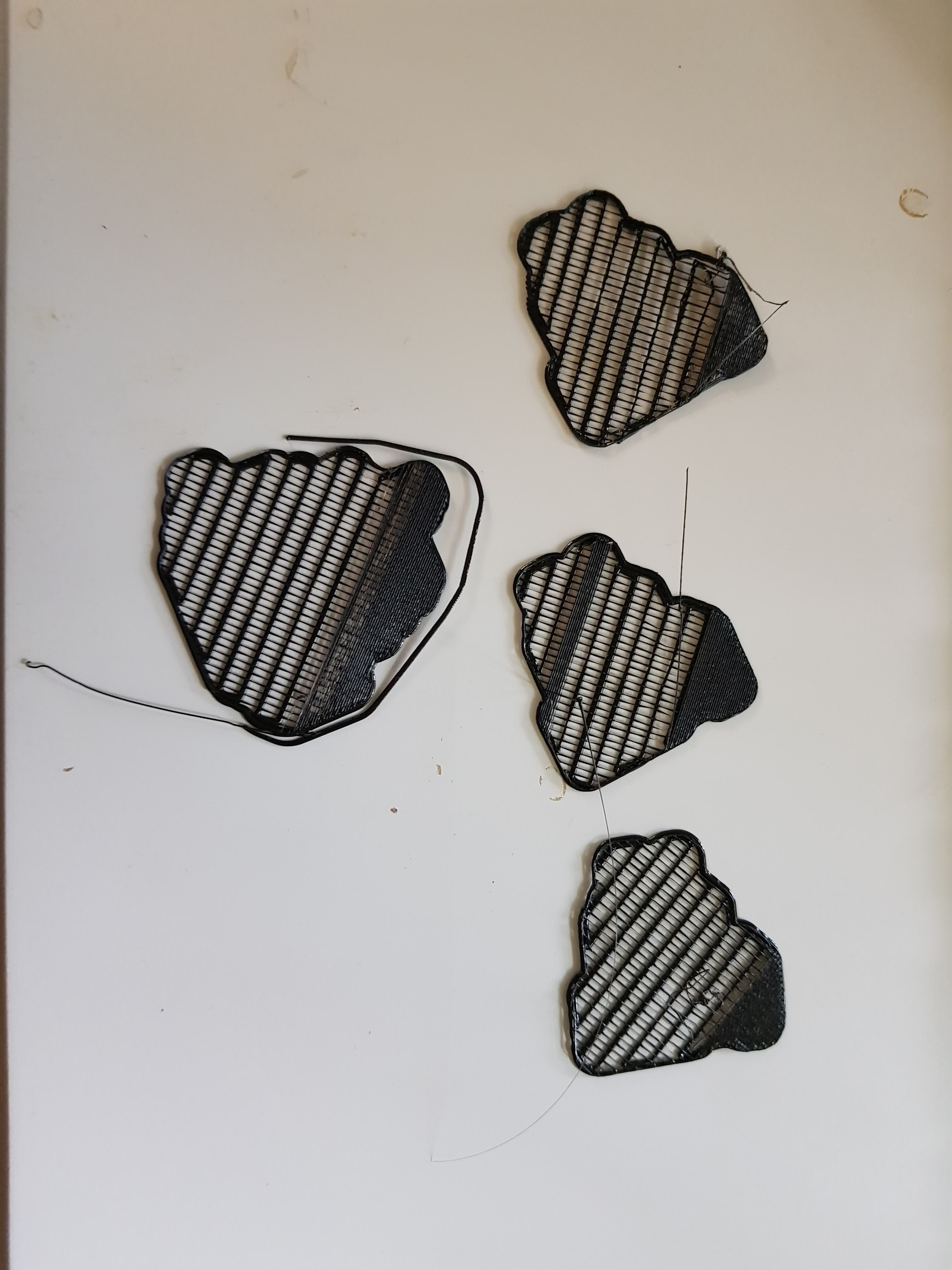

Anyway. It starts extruding ok, not perfect, but working. And then it stops all of a sudden, almost always in the same place. See picture. Changed filament as well. been dusting and cleaning in and around the printer.

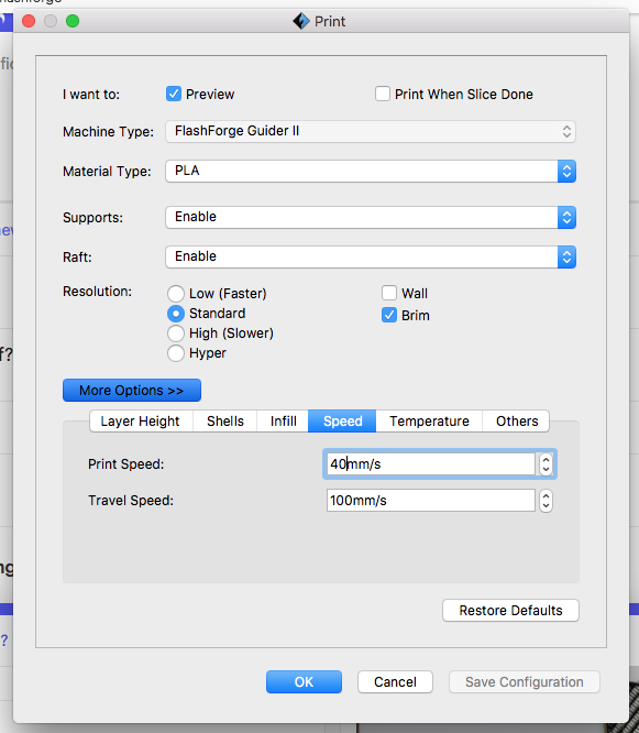

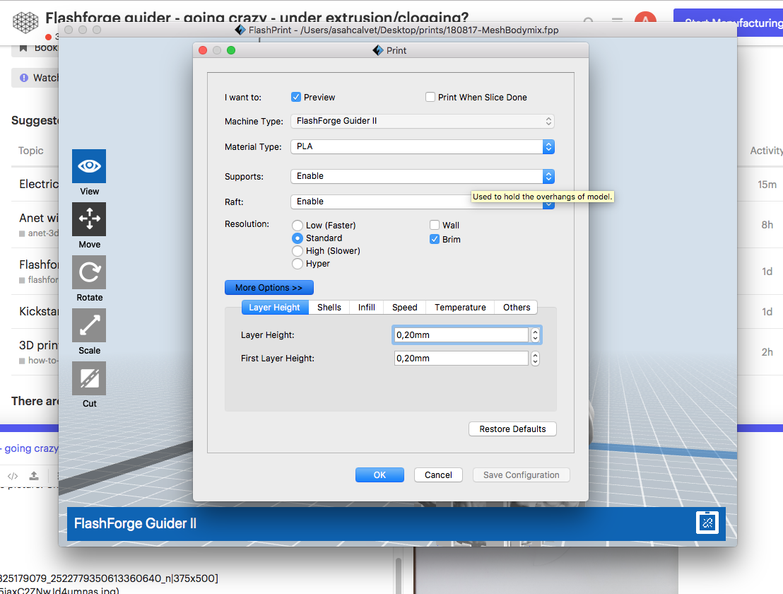

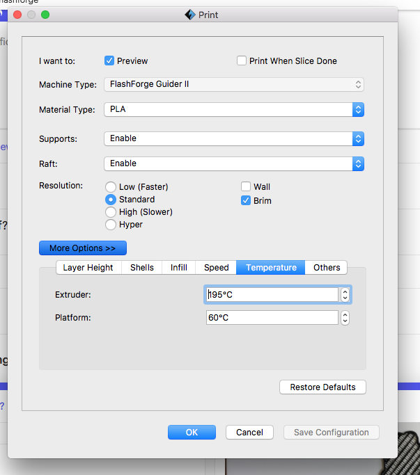

Current settings:
See picture below (next post)
setting 1
setting 2:
setting 3
Try at 215 degrees… I don`t have other ideas.
Hey. Did you ever get it going? Foryour problem I would say its a faulty thermocoupple. Seemes you have a higher temp than it thinks. Therefor burning the filament and ptfe. Any boubbles or holes in the print?
Start with 200 degrees in nozzle, bed is irrelevant on the buildtak. 0,2 layer height, 0,45 extrusion width, 0,85 extrusion multiplier, full cooling and doors open. Speed around 40-50 mm/s. This should work perfect on any PLA. But it seems you have a faulty temp sensor.
@Solidified got it working. Seems like the files were bad and they fucked everything up. At this point (when i wrote here) i had already changed the thermocouple. After changing ptfe, nozzle, thermocouple, heatblock, and cleaning everything i got it working at 220 degrees with open “roof” and door. It doesnt seem to like files exported from fusion 360, but with some modification of the geometry it works fine :blush:
