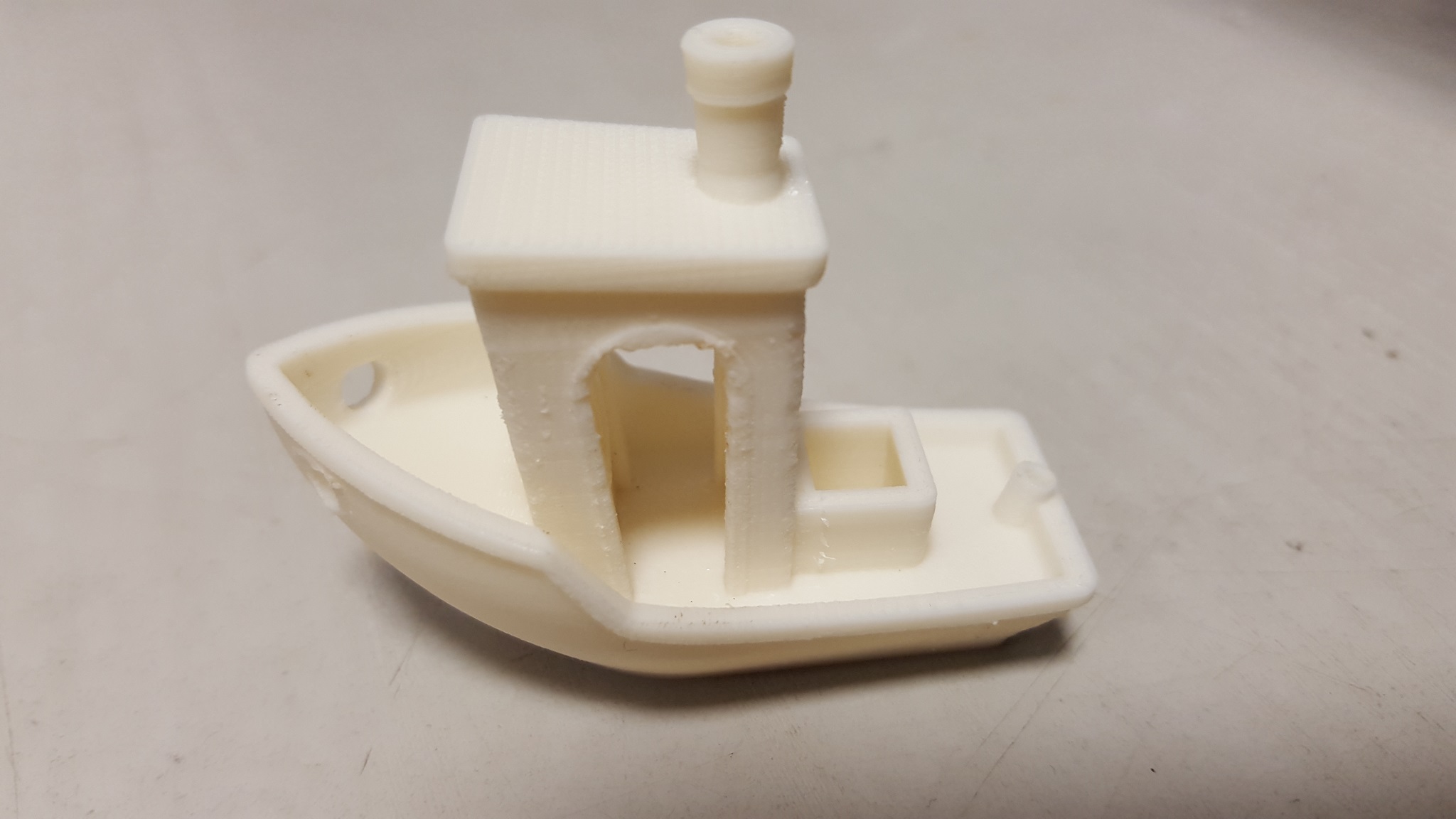

Hey there! I have no experience with 3DLAC but I do with everything else you have mentioned. I bought my FFCP printer back in September and to date only have one failed print. It was my first and I was printing via USB instead of the SD card. The bed stopped moving down the z axis as simplify or windows 10 locked up. Anyhow the only thing you haven’t mentioned is the filiment you’re using? I’ve been successful with the standard ABS it ships with but have recently gone with Hatchbox filiment. I had to print new spool holders so if you do go with a different filiment make sure you have enough left of the old stuff to print at least one. I realize I am getting off topic. There must be something either very simple that is wrong with how you are going about your print or something fundamentally wring with your equipment. Could you let us know what filiment you’re using and maybe throw up some screen shots of your print processes from simplify?

Shipped white ABS
Simplify default settings
Speed 1200 mm/min
In first picture I try to print Marvin
I print from SD Card, I do not have test prints only a horse with chinese file name.

Did you specify your nozzle diameter and filament diameters in your slicer? looks like you might be over extruding.
Just wanted to see how your progress is going and if your prints are getting any better? I’d like to also like to emphasize how important it is to make sure the bed is level. Take the time to make sure it’s as level as can be. Next would be to check your layer settings in S3D. Set your first layer to be .1mm and other layers to be .2mm. After changing the layer settings add 6, 8 or more skirt perimeters to the object. This way you can stop the print if your having bed adhesion problems. Now for bed adhesion. Elmers purple glue stick. Get the three pack of the jumbo sticks. Get 1 pack to start. Apply a thick layer of the glue to the bed. Enough so there’s no gaps. You only need to apply where the print will be. You may need two coats if it appears to have dried to fast if the print hasn’t started. With the bed hot, 100 or 110 like you had is good, apply a second coat. Now when your print starts you’ll see the nozzle almost carve into the glue. With ABS the smaller transition temperature from hot to cool you’ll have more shrinking. I would even try to bump up the temps a bit 235 or 240. I think you shouldn’t have to go above 245 for ABS. Once the print cools wait for the print to cool evenly with the bed or carefully remove the glass from the bed and set aside to cool. You could also try with PLA. 200 or 205 max temps with the bed at 60. Hi me up if you still have issues.
14 days later
0, Simplify3d make gcode and copy to sdcard
1, clear glass with isoproyl.
2, Use 3DLAC 2 layers
3, preheat bed 85c ext 200
4, Use 3Dlac 1 layer
5, print
6, at layer 20 cooler switch on 5%
7, sucess!
