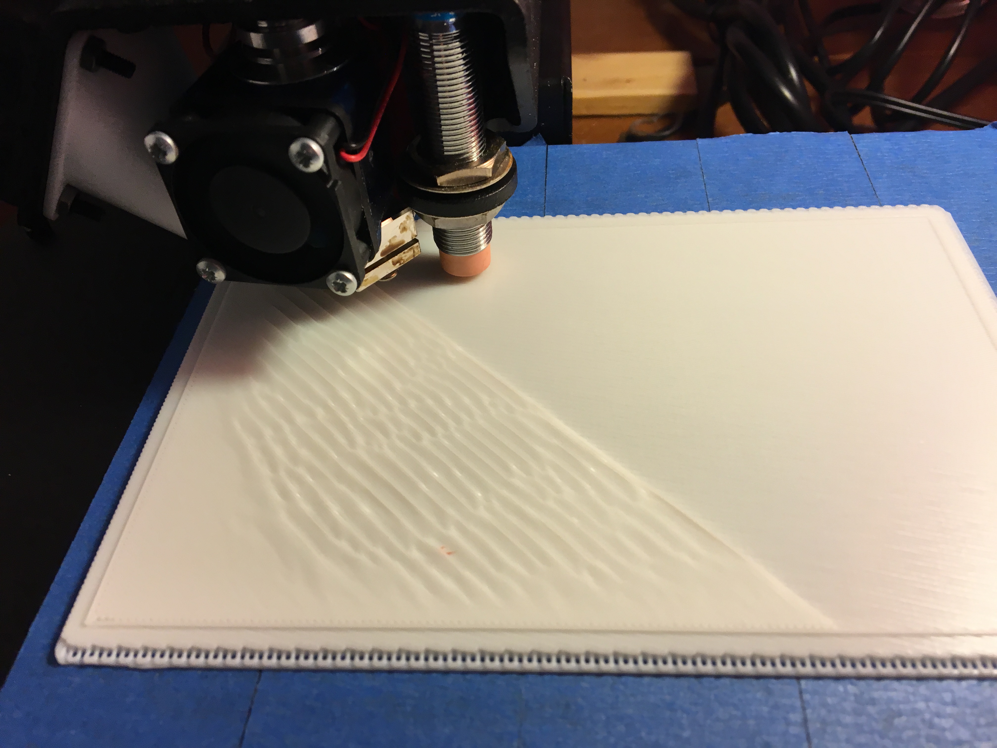

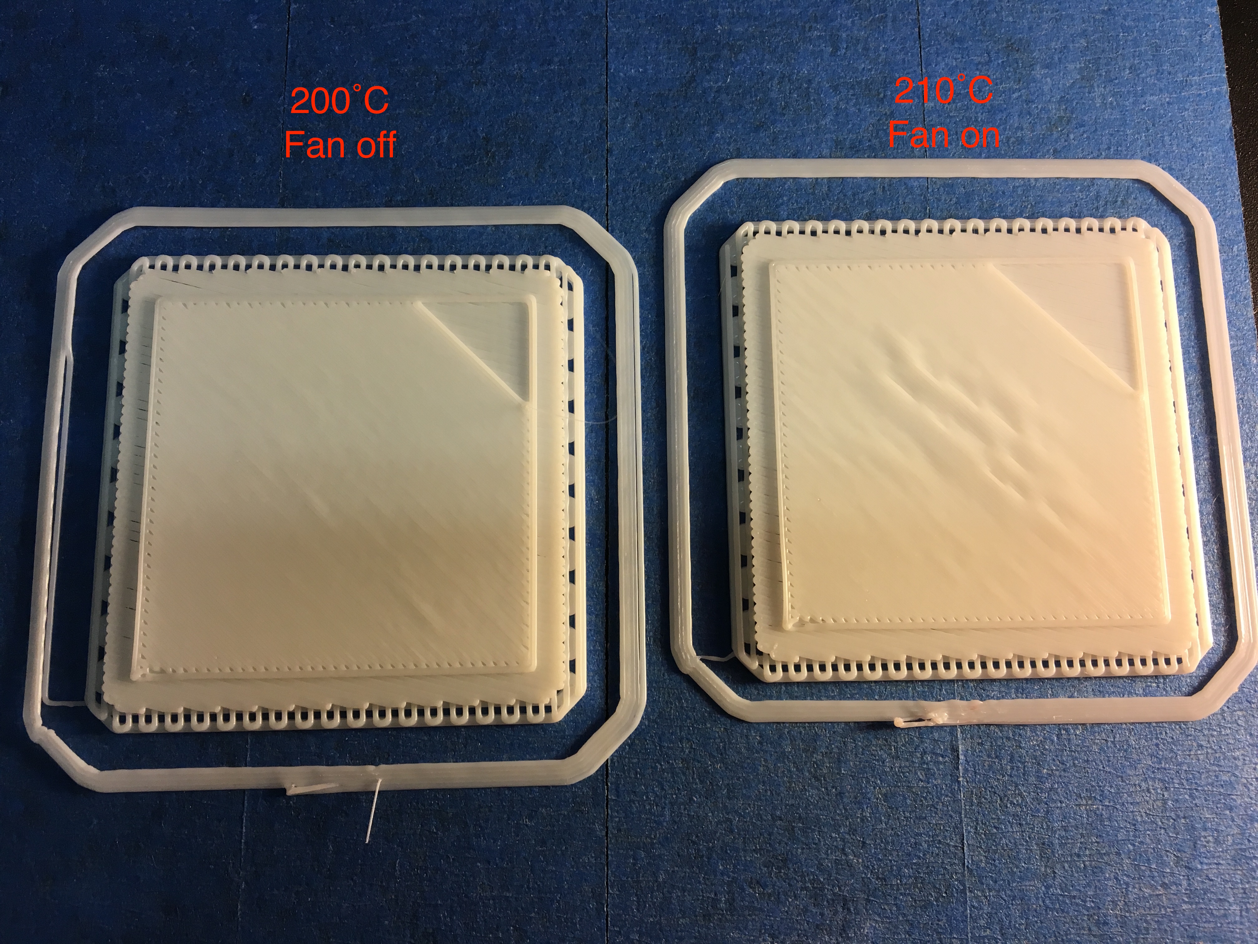

The solution in my case was to decrease the temperature to from 210 to 200. I also stopped the fan on the first later of the print on top of the raft. The picture shows the original settings on the right, and the updated settings on the left. A definite improvement.
Many thanks for all the suggestions!
