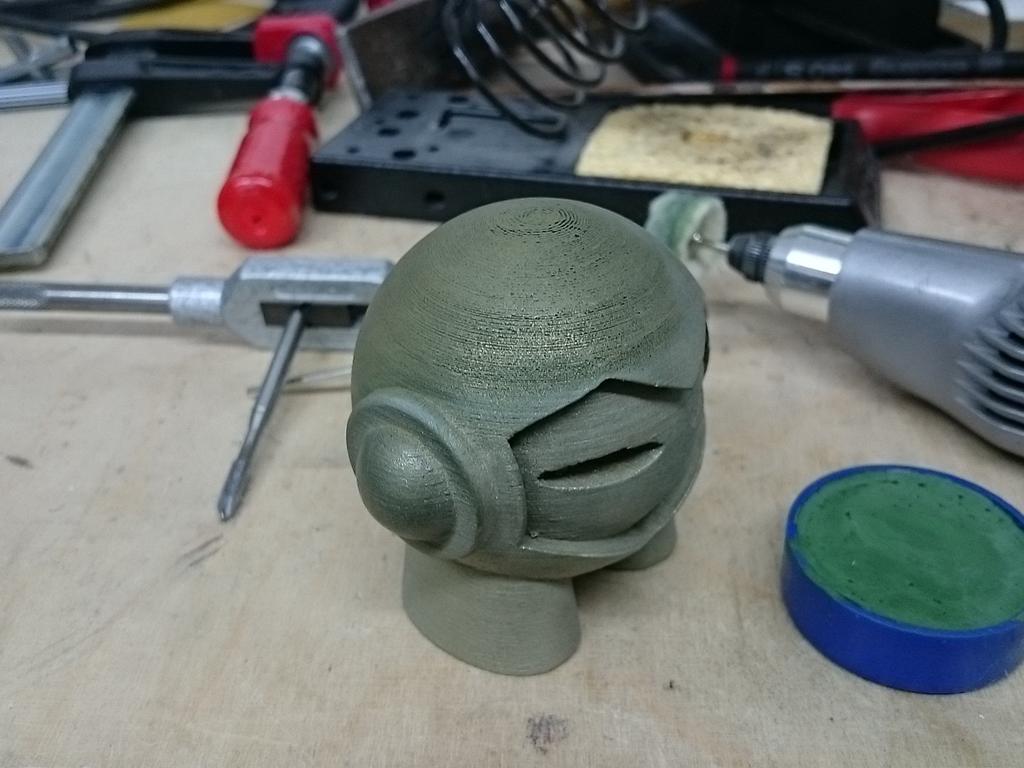

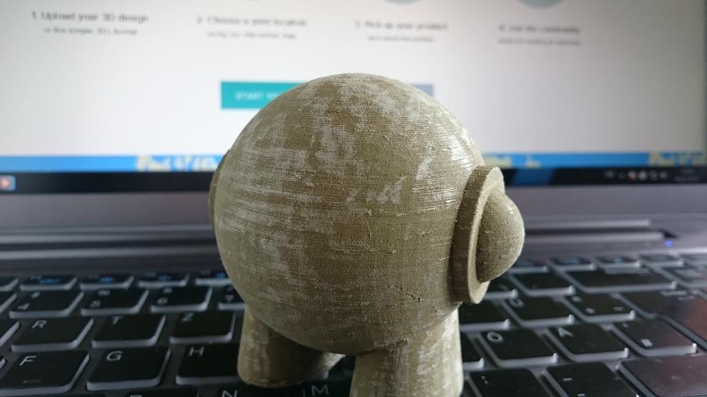

One of the first prints in brass was the 3dHubs mascot Marvin. Pictures of the print can be seen below.

PS: the brass print looks greenish due to a special polish, that I used. Your polish can be customly changed. Sharp edges and cavities aren’t polishable, that’s why you see some unpolished material at the edge of Marvins face and in his eyes.
The metal composites can be sanded to get a flawless smooth surface, in the case of Marvin, I selected 0,15mm layer resolution, theoretically I could go up to 0,05mm, but usually this isn’t necessary due to the ease of sanding.

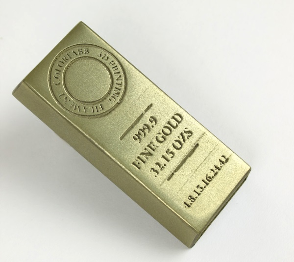

Hi Chris! Thanks for your response!
Something like the attached would be perfect. How long does it take to create something like this?

Marius,
What process are you using to achieve such a nice finish on these pieces? Sanding and polishing by hand makes my hands cramp up! :wink:
Thanks,
Mark
I first used a bit of sandpaper to remove blobs on the outside, then I started with steelwool to bring the metal look out. After that I proceeded with polishing disks (clothlike disks). My preference were 100mm diameter disks on a drill press at slow speeds around 500rpm or lower, faster speed heats the model and deforms it. Before polishing I held a file to the spinning disk to clean it, after that I held a pre-polishing paste to the wheel and polished the print. Next up the last step again, but with the final polishing paste/block. For finer details I used the same method but on a dremel. Optional you can use polishing bg liquids like brasso instead of the buffing wheel, I used both :wink:
