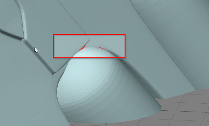

I have looked at the file in my slicer and don’t see anything obvious. I did notice however that it will generate supports if I turn it on. I will have to look closer but I wonder if these overhang areas on the inside of the print coincide with your lines?
Haven’t had time to try a print yet.
I’ve loaded the model into my S3D.
There are a number of self intersecting surfaces in your part.
Not only at the specific area also on other places.
Look at the screenshots.
Maybe that is your problem.
3dhull
22
Hi thanks for your help. Is there a way to repair these intersections. E.g netfabb repair?

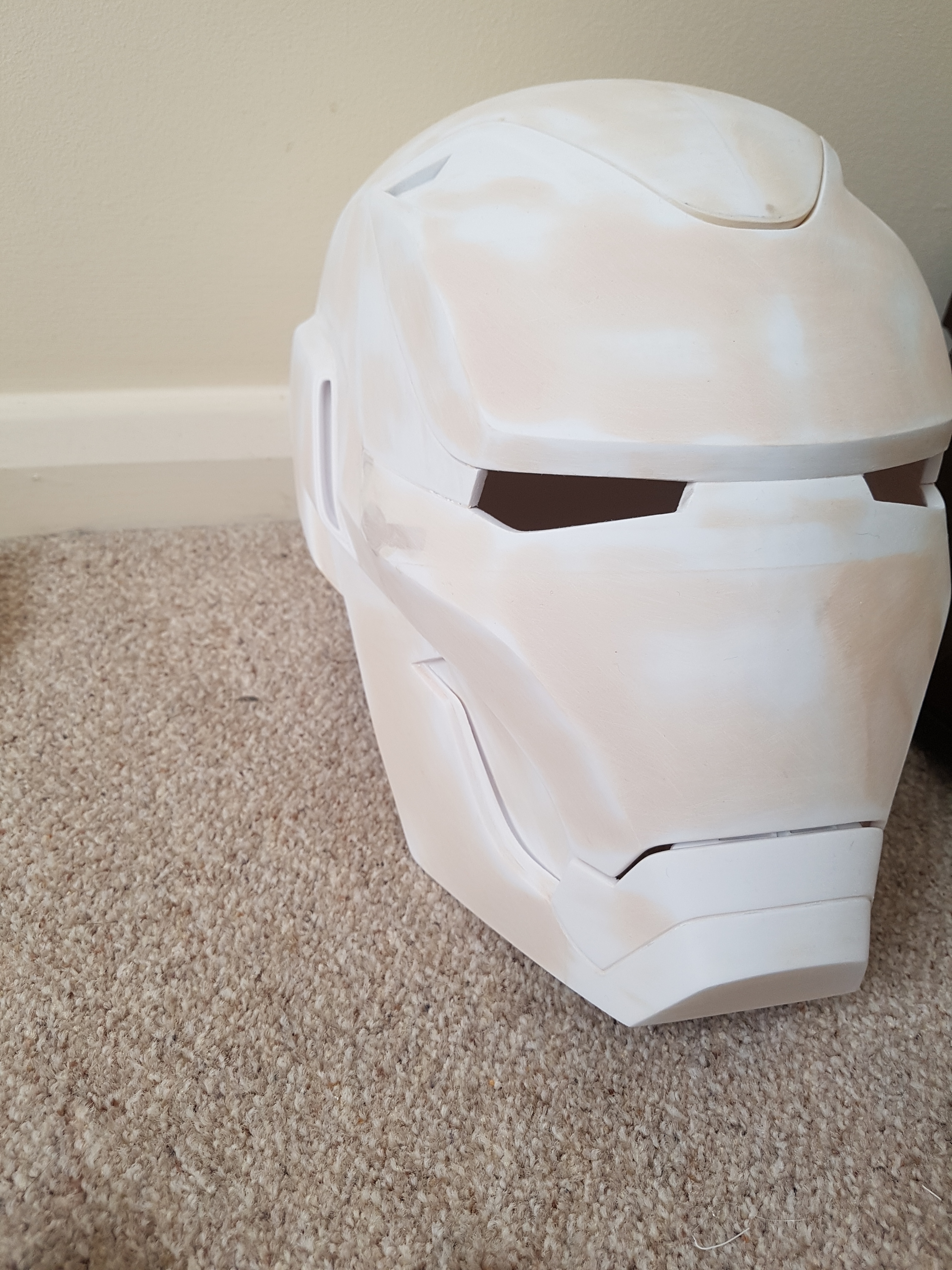

Ok so i think ive figured the problem. When i cut my big stl in smaller peices on netfabb. I then level each peice on the z axis to sit flush on my platform. However I noticed that when I send these files to flashprint some do not sit flush on the platform and no supports are generated between the model and raft. My theory is it causes a layering problem on the side of the print which was not level to the platform. I have made sure the model is completely level and am currently printing a test peice. I will report back with the results. Thanks to everyone for your help. My print is also the latest iron man suit from avengers infinity war mk51 if anyone is interested in the building of these suits
