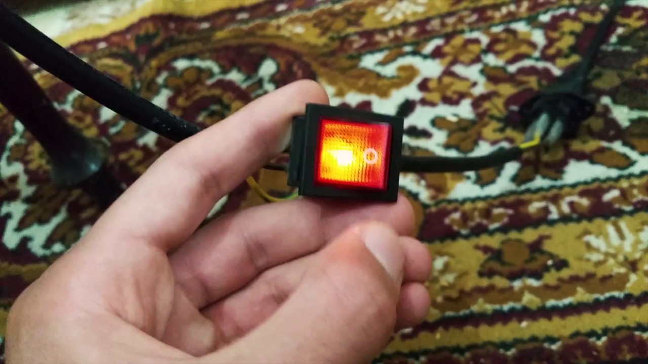

Hello everyone, i have a Geeetech Aluminum Prusa i3 and i have a problem with my extruder it stoped extruding after like 15 prints so i did a couple of things to try to resolve the problem: (THE X Y AND Z AXIS WORKS NORMALLY ) -replaced the entire extruder with a new one -replaced the hot end -swaped the extuder motor with the X axis motor and i kept the hot end wired to the board (the X axis motor kept doing the same thing as the extruder motor BUT the extruder motor worked normally SEE THE VIDEO) -changed the cable that connect the extruder motor to the board -swaped the extruder driver with the Y axis driver -turned the screw on extruder driver (ive followed this tutorial [www.youtube.com]) -used usb cable instead of the memory card for printing -changed the fan to a bigger one -changed the software that i use from cura to repetier (and i couldn’t connect my printer to cura maybe you can help me with that) and i still have the same problem now i have no idea what to do. the problem could be from the board or the power supply maybe and the hot end works normally and the problem is not from the extruder i’ve made a video of the printer maybe it will help identifying the problem and i’ve uploaded cura and the printer settings and a picture of the board thank you and sorry for my bad english
