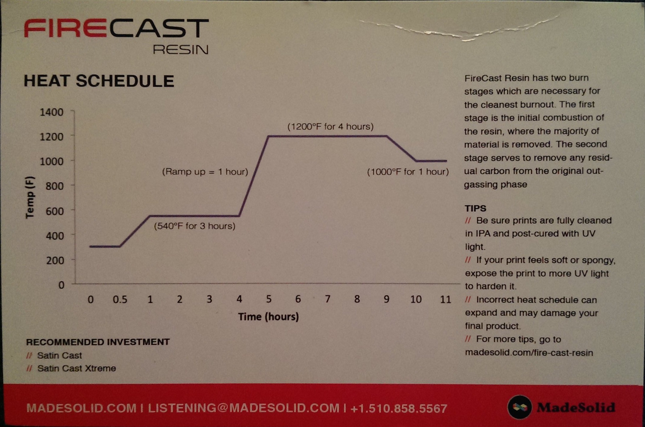

Hi Todd,
We utilize a Form1+ and have experience with both the Formlabs Castable resin as well as with the MadeSolid FireCast resin. I’ve tested the thresholds for burning out both materials, at different time lengths with quick burnout processing at full temp with investments designed to do so, as well as from cold oven starts, pushing ramping times and soak times. Depending on ring size and the mass that’s being burned out, I find that both materials we’ve worked with burnout quite easily and cleanly, close to that of ash-free wax for jewelry or dental laboratory uses. I’ve actually had more of a difficult time getting beautiful ash-free burnouts from the 3D systems Visijet resins that utilize the paraffin wax for support material than I have had with either of these materials in the Form1+.
Additionally, I’d like to contribute the burnout specs for the MadeSolid FireCast resin for future referencing of other users here. The attached image is the card that comes with the FireCast resin when purchased.
