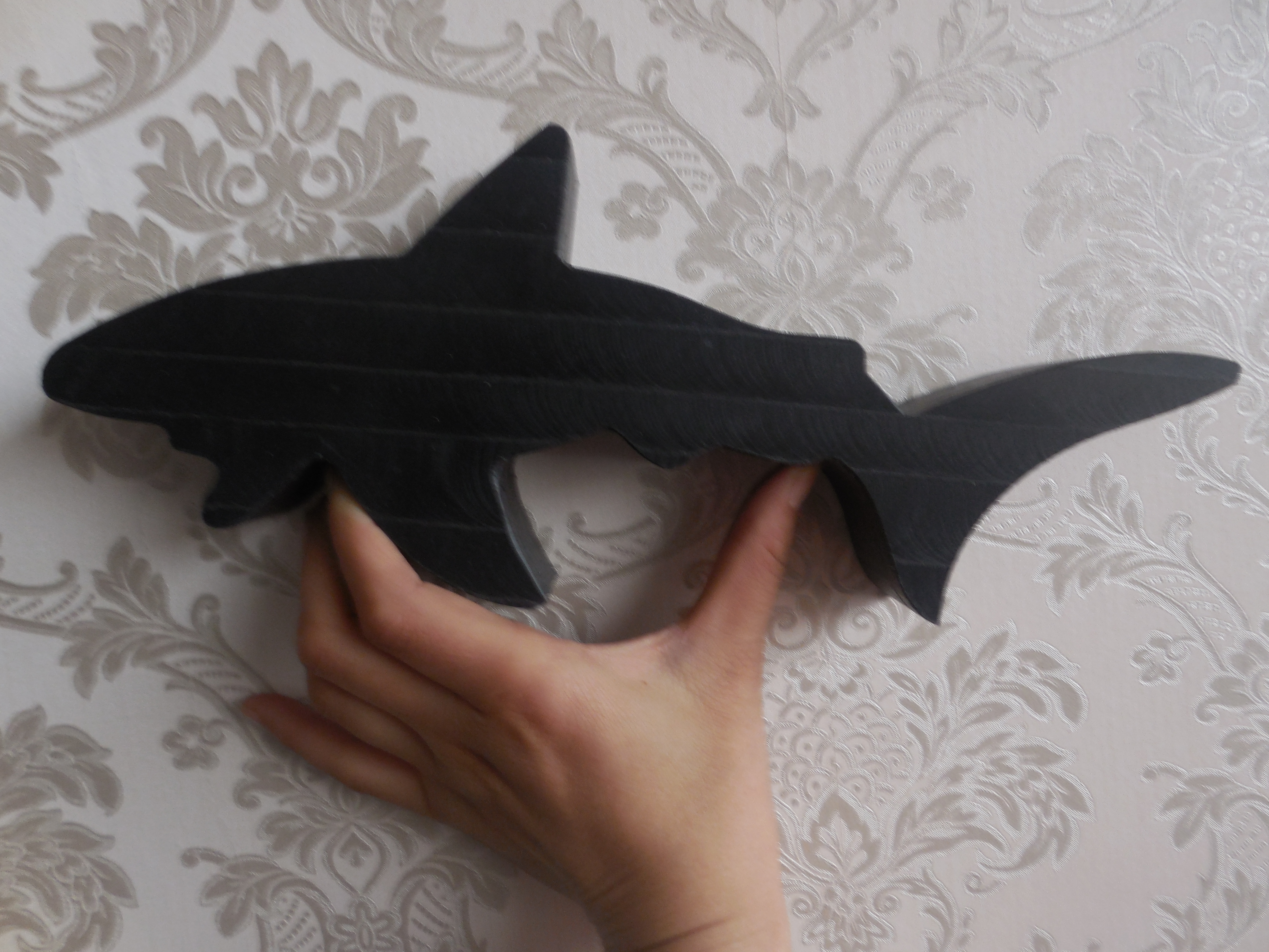

We do this with recycled hdpe 40mm thickness,but customer still think it a little expensive…
What’s about PLA?
http://ch.rs-online.com/web/p/3d-druck-materialien/8320264/
price-performance is very high!!
How many % infill did you use?
What PLA density?we use 100%Uhmwpe
1210–1430 kg/m3
Is 100% required by the customer? Otherwise I recommend 35% infill and a shell about 1.2 to 1.6mm (top, bottom and all around)
Uhmwpe is very strong, is it necessary?
