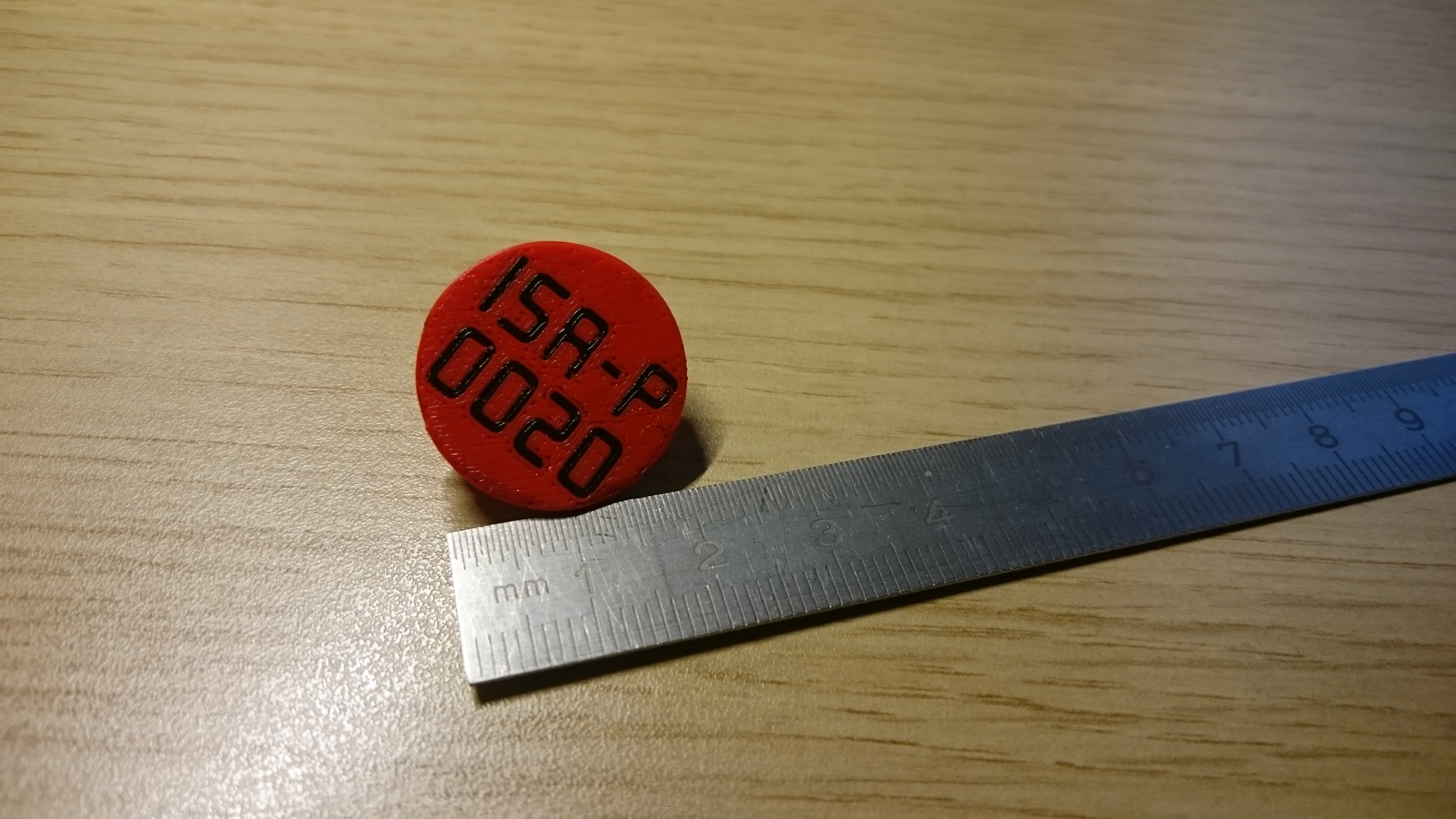

I have print job that I thought would be fairly straightforward, but I’m having trouble finding any information anywhere that will tell me if this is possible. My print job is a small disk about the size of a nickel with printing (Arial bold 20pt) on it. I would like it in two colors. I have 4000 unique versions of this job (only printing is different) and have no idea of how many of each I’ll need. It could be 10 and it could be 1000! I would like the printing embedded into the disk.
The thing is that I read all this stuff about the resolution on 3D printers being phenomenal, but the quality of the results I’ve seen remind me of the old dot matrix printers compared to today’s laser printers.
I can design this with CAD, but don’t want to go to that much effort if this is either not possible or not cost effective. Am I not asking the right questions? I’ve attached a copy

Hey there,
if i understand you correctly you don’t own a 3d printer and want these coins/disks to be made, right ?
First of all to print you need a 3d model. There is software, that can creat a 3d model out of a screenshot but these won’t work for this thing as it is not just a flat model.
For amounts going towards 1000 pieces (with the same text) it could be too much for 3d printing as injection molding is cheaper then,
but with the variation in models (you said 4k different texts) and two colors, injection molding is very difficult/impossible.
What do you think on how much of those disks you will need at first and where should they be shipped to ?
I would like to take the challenge and use my dual extrusion (two colors) printer to give this a try.
Do you have a special wish on what material should be used for printing this ? I’d recommend standard PLA as it is easy to print,
available in very much colors and -most importantly- cheap.

Hey Mark, it’s certainly possible, but you’ve got a lot of tricky features in the print that would throw amateur Printers for a loop. The “button” on the underside of the print makes the rest require support material. That support can lead to an imperfect surface on the underside of the “nickel”. Not a huge deal, but something to be aware of. Having the lettering should be OK. Having it be in a 2nd color is slightly tricky. Unless the printer has dual extenders, the person running the job will need to “Indiana Jones” in the 2nd color mid-print. Hot-swapping in a 2nd color isn’t very hard, but it can negatively impact print quality, and it would be a huge pita to do 4000 times. Also, based on the way 3dhubs prices by volume, this job wouldn’t pay very well for the effort, equipment and skill sets needed. That might make it tricky to find someone willing to undertake the task.
Why not print this upside down, then you don’t need support and the 2nd color for the letters can be pulled mack by a lot after a certain height (depth of the letters) to stop that nozzle from oozing and creating blobs on the surface
It sounds like what you really need is to 3D print just the prototype for dimensions and fit. Once proven i would seriously look to injection molding (Much cheaper in quantity) and ink printing on the surface latter.

Oh, I would definitely print this upside down because I can get a prettier surface for the top and so I don’t have to have any support things to clean up afterward. I agree that the color for the letters shouldn’t go all the way through the disk part. I initially wanted a domed top, but gave that up because supports would be required no matter which way the cap was printed!
NS -
It is really the two color lettering that I’m having problems with. If I had a printer, I would get one with a dual extruder just because of the amount of work involved in hot-swapping a 2nd color. I also imagine creating a whole bed of these things at once and each one may be different. The printer wouldn’t care about that.
Also, I’m going to end up needing a lot more than 4000 of these. I have 4000 unique caps, but I may need anywhere from 10 to 1000 of each of those 4000 caps. Certain ones of these things will sell better than others so as I find out which ones I sell more of, I’ll know which ones to order more often and order more of at a time. I don’t want to keep a gigantic inventory of these things around.
I don’t think painting is going to give me the effect I want. And, I’m concerned that it would wear off and the customer would be left with a dud! Keep running it through your mind and let me know if you come up with anything.

Thanks for your reply. You are correct in that I don’t have a 3D printer and would want these things made for me. The 3D model isn’t a problem. It will be quite annoying to change that 3D model 4000 times, but once its done, its done. If I ever need more than 1000 of a single cap you are right that injection molding is a better choice. I don’t want half of them injection molded and the other half 3D printed though and I know some of these will never have more than 50 or 100 of a single cap.made.
I’m thinking that PLA will be the best choice of material but am open to other ideas. As far as tolerances go, I haven’t though about that. These will fit in things that are injection molded and the only thing that will be different will be that certain brands may need larger or smaller diameters for the post. But, all of a single brand would the same size. I’ve thought about making that center post smaller than I need and including maybe 4 little things that follow the length of the post, but are fairly small in width. This way, the tolerances can be higher because the 4 little things would act as tolerance adjustors. I have attached a 2d drawing of this looking from the bottom of the post to the top of the disk. I know this is a fairly crude drawing, but it was fast and easy.
The font of the text can be changed if a different font will provide greater clarity. As far as colors go, I think something like a yellow base with blue or black printing would give the best contrast. I’m in the US (Colorado to be specific) and I think I saw that you are in the Netherlands. No need to send samples now, but if you think this can be done I’ll go ahead and create a STL file for you. Then, if you can try it and just send me a picture of how it turns out, that will be fine with me to start.
If we need to take this offline, please don’t hesitate to let me know. I guess I’m still confused by the absence of 3D printed items with contrasting lettering though!

i have started printing the coin part. Due to the very high contrast of the colors the black shines a little bit through the yellow color. I’m trying to fix this by printing the coin flipped on it’s side. Then the second nozzle is never touching the print unless this nozzle actually prints.
As you can see i have used my own font that is optimised for printing it, i have to make a tiny adjustment for the flowrate of the first layer, so that the lines are smoothly fused together. I have other coins which have a smoother surface, but these have more black filament fused with the yellow background, so that they are not really representative for the final prints.
The final version will most likely look like this one, exept that the shadow from the black filament fused with the background will be gone and the lines are smoothly melted together to a solid coin. I have also added another picture of a test lego brick that shows the real yellow color aswell as what you can expect as a smooth surface when choosing my hub for printing. (I broke the knobs off the lego brick to test layerbonding)
I’ve printed the coin slightly larger then supposed to be, so that i can figure out the best settings when printing small, downsizing the print is no problem.
The hexagonal shape of the upper part will not be necessary to archive high quality prints.
However i have thought about recessing the letters and having a solid black disc inside of the upper part.
The yellow surrounding would be printed above the black disk and by that the lettering appears.
I’ve got some other ideas on how to get the cleanest yellow while maintaing absolutely filled black letters.
Please tell me if you are still interested in having these parts printed. Please contact me so that we can discuss further details of the print. Also i then would like to explain further ideas on how to improove the models geometry and design.

Hey Mark,
I don’t want to bother you, but still I’d like to hear from you and want to know, if you still are looking for someone to make these parts.
I’ve had further success printing the part as you can see below, i have added a M6 nut for size reference.
Currently I have some more parts being printed with improoved surface quality (as you might see there are some cavities in the red surface).
The new way of printing the letters allows me to use any colors without them mixing in the surface, there won’t be any little dot of black filament fused into the red/yellow background part.
The colors are very clearly seperated, no colormixing on the letters edges. Even white and black would be possible, for maximum contrast and ease of reading.
By the way all letters are printable with this method, no limitation to just capital letters, same goes for numbers, punctuation and more. (Like the “<” in “I <3 CAKE”, or the “,” in “HI, MARK”).
-Marius

From what I can see here is the part is printed upside down in PLA.
The design is simple so start on Tinkercad and make all your parts for your first session and see where that goes.
I see that your letters dont follow a curve. This lends itself to extreme simplicity and ease of effort in working the design.
After that you have a starter library for next set of parts.
Don’t do cad? This makes your whole project a larger problem than it has to be.
Flexibility upfront is the key. I have found there are 3d printers that don’t do cad. How can this be?
I have a PRUSA i3. I used Tinkercad to create a Bowen hot end holder. Took 3 days. I then created a x axis holder for a Dremel remote tool. 1 day to create, 3 days to print, 5 days total to get it on the printer. It isnt that tough. Precision? Extreme. I used digital calipers to measure the Dremel then went straight into cad. I have a long history in the creative arts so perception to drawing to cad to device wasnt that tough. I hope you fair well in your endeavour. Sometimes take a step back and dont rely too much on others when you know you can get something done by most of your own efforts.
My thoughts are to make metal deposition moulds for injection. This will drop your costs quite a bit and give you the detail you need but doesnt solve the two color part. Or find somebody with a dual color print box, cad up a test, and send around for test. 2nd option is the cheapest by far with no real commitment and gives you something really quick to fondle in your view thereby giving something tangible to change your perceptions. Its the only way to get the rocks out of the way. Fustration always breeds complexity in the beginning.
