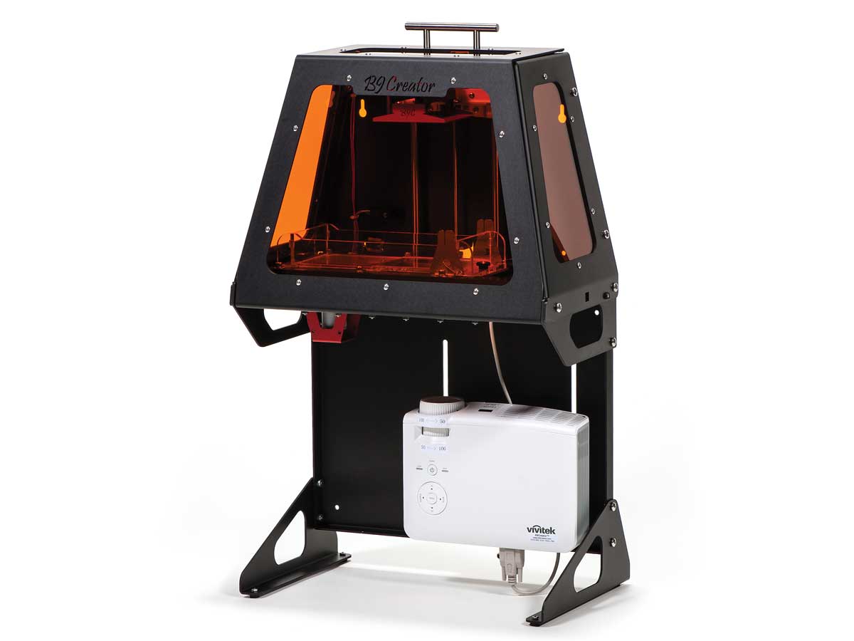

Hi everyone, I’ve been using a B9Creator 3D printer for more than 1 year and I’ll answer any question about resin based (and video projector) 3D printers here so you and I can link it in future messages.
Open the Source
Cheers!

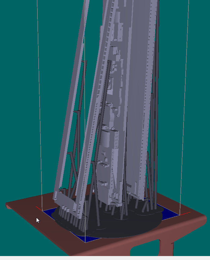

Hi all,
I have been using Substance G+ UV Cure Resin made by ‘MakerJuice’. However the printer was out of action and recently fixed again, and since the 1.7 update I haven’t got the right settings for the Substance G+.
Could anyone help me determine the necessary settings? Rather than the time and cost consuming process of trial and error.
I have attached screen shots of the program and the model file used for your reference.
Thank you in advance!
TheBIGConsultant
Well, there is no magical way around trial and error, it really depends on many things… and there’s always a compromise.
I’ve been using SubG+ alot but I only ordered clear, non-pigmented, and added pigments and dies to get the desired colors and tranparency. Every time I changed the recipe, I had to tweak the settings…
Also, what is most critical for each print? Each particular model has different features so if you need to get thin features right, or thin supports, then you need to increase the exposure time, aybe give it some/more T-Over… If it’s more critical to get interior dimensions (like hole diameters, cavities, etc) right, then you slightly bring down exposure time and possibly set T-Over to 0… or are exterior dimensions more important in your model, you do the opposite…
What I suggest (what I do):
Download this Calibration Matrix http://www.thingiverse.com/thing:165389 and print it when you’re not sure what settings you need for your next print. It’s a 2-5 minute print, it’s dimensions are based on pixel matrix so the minimum feature will be one row of pixels, no matter what Pixel Size Setup you’re calibrated. You can easily tell, from how the features came out, If you need thin spaces between features you need to lower the exposure times, and if you need very thin features you gotta elongate them. With experience you’ll know the best settings just by looking at the model…
Or who knows, maybe you have a tall model that you need to place flat and there will be repeated exposures in the same spots and you want to spare the PDMS coating and some time on the print, you then make your supports thicker and lower exposure times.
So, as you can see, it’s an art. Every model is different and needs a little setting tweaking.
Anyways, SubG+ rule of thumb:
100µm pixel setup — ~10s attach layers and ~7s the rest
75µm pixel setup — ~7s attach layers and ~ 5s the rest
50µm pixel setup — ~5s attach layers and ~ 3s the rest
You decide for T-Over (perimeter pixels exposure)
But then again, each model is different and needs it’s own settings fine tuning.
