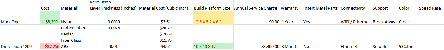

My company has been in search of a printer and we think we have narrowed it down to these two models.
One is the tried and true Dimension which we know from previous experience will last for years and produce accurate parts.
The other is the new MarkOne printer that prints in Nylon reinforced with carbon fiber, fiberglass, or Kevlar.
What are your thoughts?
I am concerned about the reliability of the new MarkOne but I also think the dimension may be a bit dated.

The price tag on the MarkOne is more favorable than the Dimension and the annual service charges. But the build platform size on the Dimension and ease of use are hard to beat.

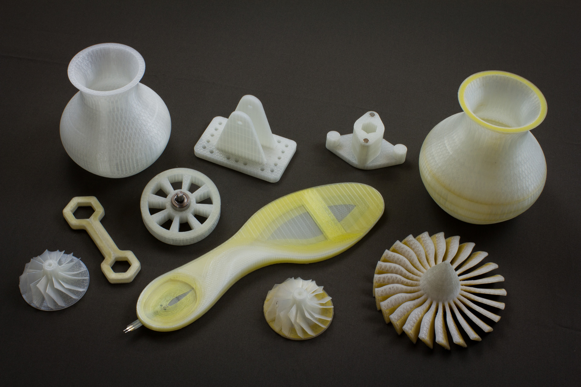

We looked at the Fortus, it is a very nice machine but it was out of our price range. I am all for the Dimension as I have used it before and know how simple it is. But holding this Carbon Fiber inlayed part is also very impressive.
Mark One claims to have a better resolution but at what cost? I’m thinking it takes a big hit in speed working with nylon and CF composites. But at that price it seems almost worth it.

There are only two issues with Dimension. Cost of the machine and cost of the material. Everything else is great.

Well since everyone is suggesting the Dimension, I’ll tell you my experience with the Mark One. We have only had one problem in the first 8 months of using the Mark One and all it required was to replace a print head. The Mark One excels at printing strong parts by using a continuous fiber to reinforce the nylon prints. It is excellent for jigs, fixtures, molds, usable tools, orthotics and durable usable parts. The build size is 12.59" x 5.2" x 6.06" or 320mm x 132mm x 154mm. At $8,799 it is a bargain for what it can produce. Have you seen benchmark parts from your files?

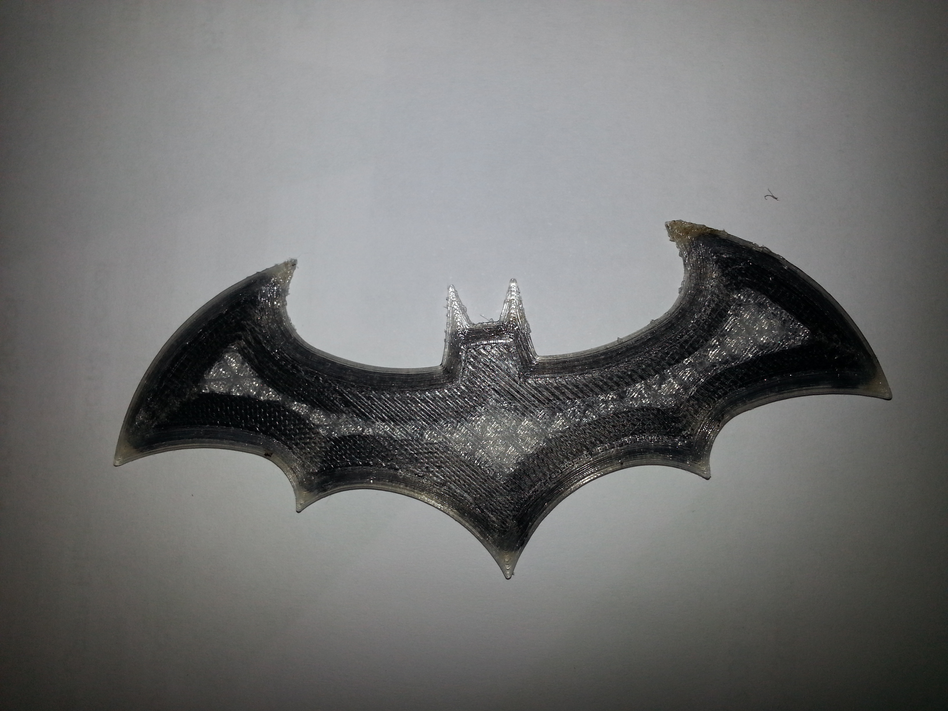

I have not had a benchmark part made from my files, I was given a sample from a demo show. The model had a few inconsistencies that I had to trim off. The part suffers from discoloration at a few of the wing tips where these issues were seen. Is this common? I saw this on more than one demo part. The developer blamed atmosphere in the nylon due to him opening and demoing the sealed nylon holding case.
Well, I agree with you, I am just suggesting that other options exist. We run Stratasys ABS.
As that is a lot of carbon fiber to put in such a small part, it looks like the tips got burned from the extruder head. I have only seen that happen once and it was on a very thin print for a logo key chain. Nylon tends to be very moisture absorbent and we always keep ours in the dry box that came with the printer. If you email me at amoskowitz@accucode.com I can provide a benchmark part or two from your files so you can see the print quality.
