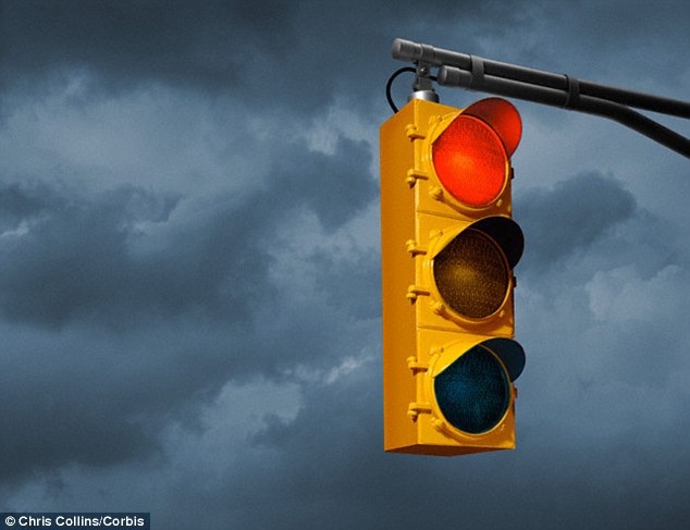

I have a small business making model railroad graphics. I’m also starting to sell led products. I’m wondering if it’s possible to print this type traffic light
Of course the yellow shell and three translucent lenses can be printed if you have a model. With an FDM printer, you would probably want to experiment with epoxy or paint to make a realistic smooth surface.
The lenses are not a problem at all. This would have to be made in 2 pieces do that I can install the LEDs and then glue the 2 pieces together
What would be the size of the yellow box (length x width x height)?
Approximately .08x.12x.44. If I supplied you with a drawing of what I need would you consider trying to print it?
What thickness on the hoods on the stop light do you hope to achieve? The thinnest wall in your model will probably be the main factor that rules out certain printing technologies.

1/87 scale traffic signals and boat trailers are both likely to be unacceptable (quality) printed from any filament-based 3d printer. The nozzle is going to be around .35 mm, and that diameter of melted plastic is just too big to capture details like a stoplight at that scale.
Investigate resin-based printers, there are some in the $150-300 range now, or at least being pitched on Kickstarter, that would make tiny parts like that with some chance of meeting the kind of quality you would need to make marketable parts. Then again, once those printers are on the scene, expect a lot of competition. The window of opportunity to make easy money from something like that is somewhere between closing quickly and already closed.
.02 whats? Inches? Still too tiny.
You need a model, that was mentioned and that means a CAD model, a 3D CAD model. You might be able to find one already on Thingiverse. Download that, then upload it to a 3Dhubs printer or one of the big 3d printing sites. Buy a couple … you’re going to find mostly disappointment with things that are that tiny. Can be done on professional machines, not so much on prosumer machines that use any sort of filament.
