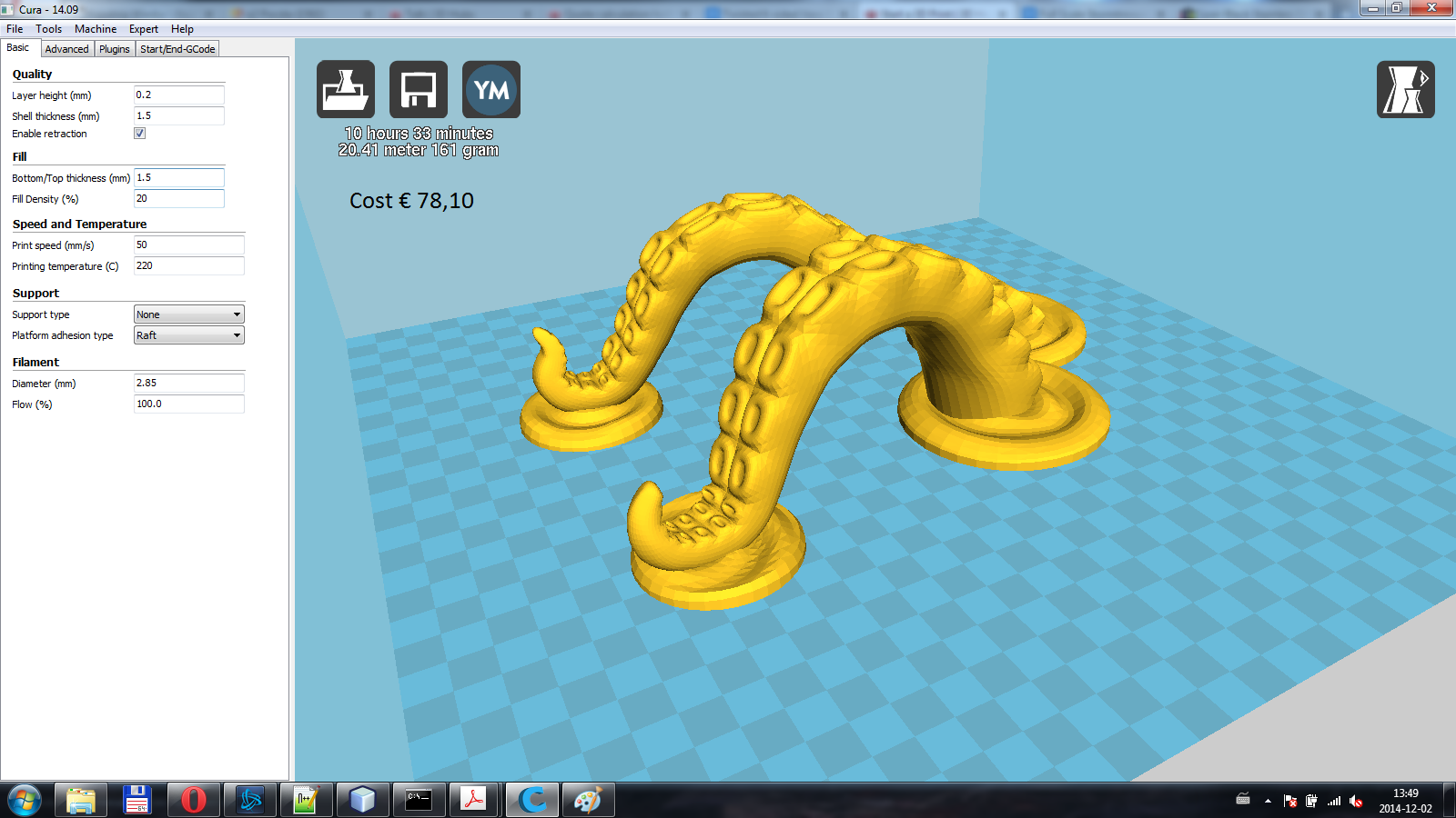

I also found one more very strange thing.
Please take a look at the pictures and try to tell me why so big price differences
object octo is half the weight of vase 1 with price difference of almost 5 times
why is that ? @Brian @pedro
