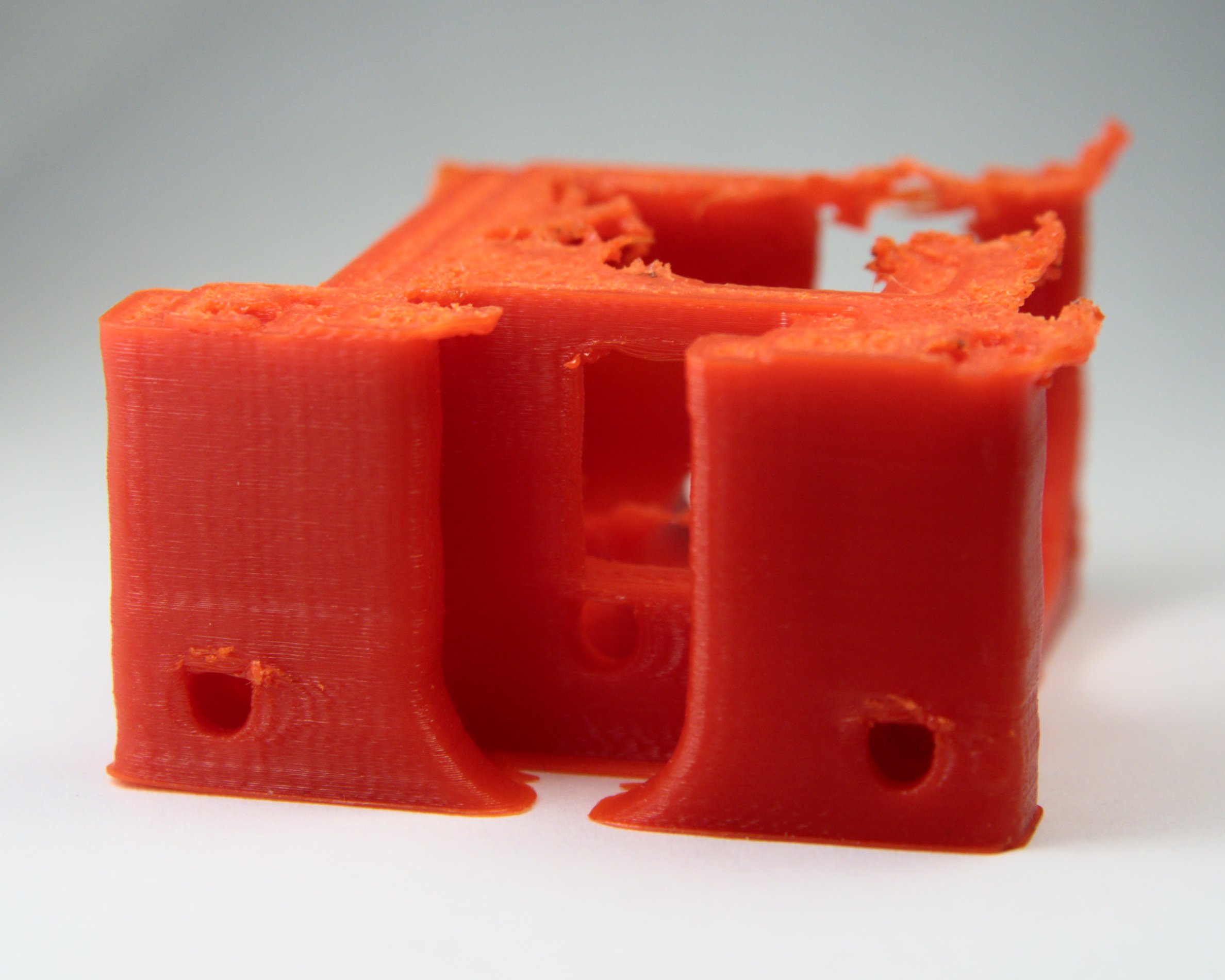

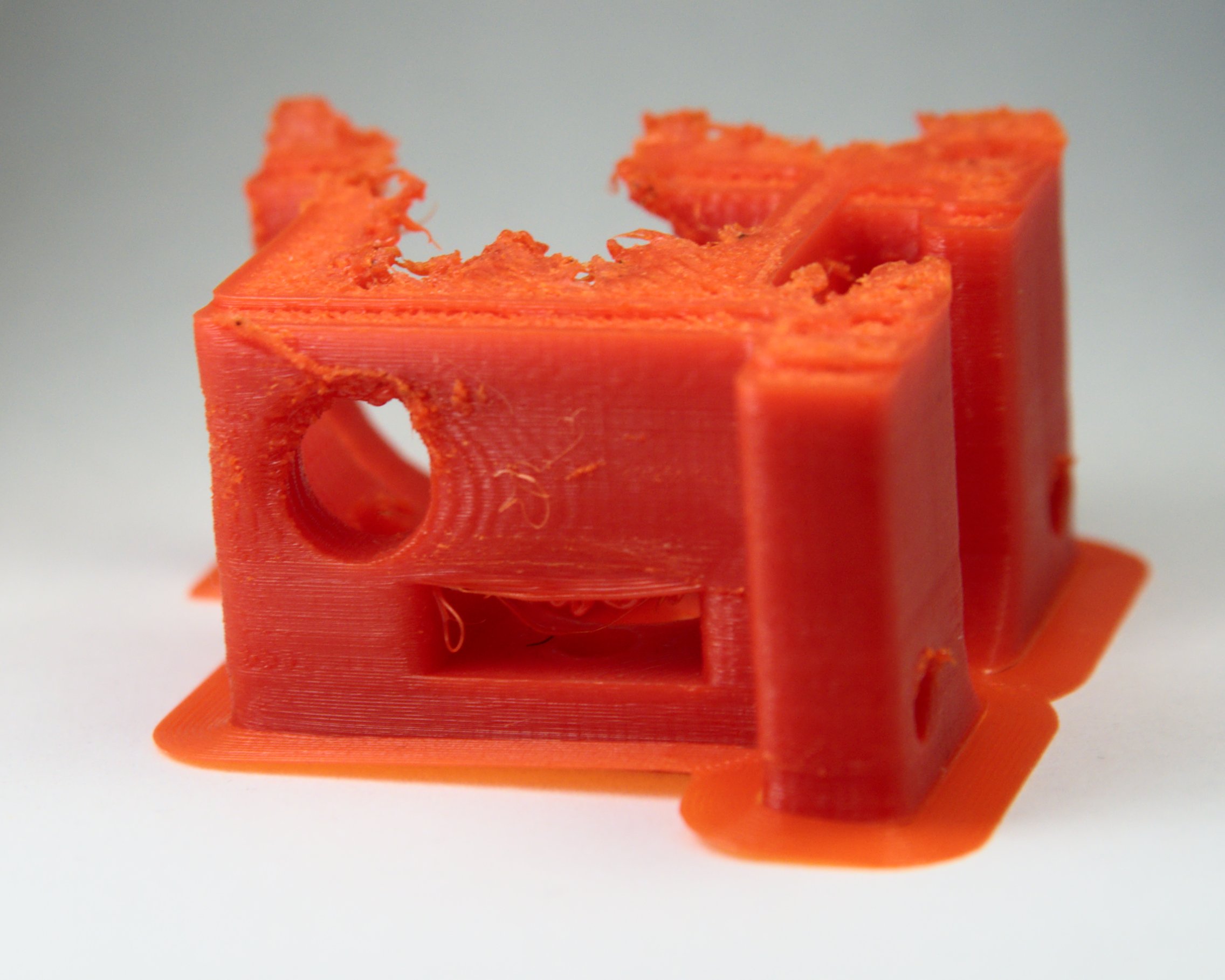

Hi anyone who’s still left on this thing, newbie question: I am getting beautiful results with Colorfabb XT when there are no overhangs / bridges; however, things turn ugly when trying to print something that includes bridges and / or overhangs (say, Marvin’s underside, or an Urchin extruder body).
I am using Cura on Ubuntu - Slic3r is more flexible, but stuff doesn’t even stick to the table at exactly the same speeds / flow rates as Cura, no matter the material: PLA, PLA-PHA, XT, (conductive) ABS - I think maybe its flow rates .

Meh, I should have included more info, but I was too sleepy… Also attaching a few nice photos of my last failure (it failed due to other reasons, most likely Y driver overheat - it was supposed to look like this: https://github.com/zbysniew/Urchin/blob/master/stls/64\_01\_01\_b01\_urchin\_chassis.stl).

250 deg. C hotend, 70 deg. C bed covered with Kapton, the last one was 0.1mm layers and 40mm/s shells, 60mm/s infill; the infill looks bad, so I guess 60mm/s is too much.

The fan duct is the one in the picture I linked above, the blower was in theory full on after the first 3mm (… but Cura is steeped in the “user is stupid, I’ll do what I want” way of doing things, so grep M106 thing.gcode shows that fan speeds alternate between 127.5 and 255 for some reason). When testing the duct I actually put some incense sticks in front of the blower and looked where the smoke goes: it hits the workpiece where it’s supposed to - close to the nozzle, so I’m pretty sure my duct design is at least ok-ish.
As I said in the original message, I can’t get prints to stick to the bed with Slic3r at exactly the same parameters (temperature, speed, bottom layer height, filament flow, bottom layer extrusion ratio) as Cura. It does … something that messes things up and I have no idea what, so I’m stuck with Cura for now, and Cura won’t allow me to customize the bridging speeds…
