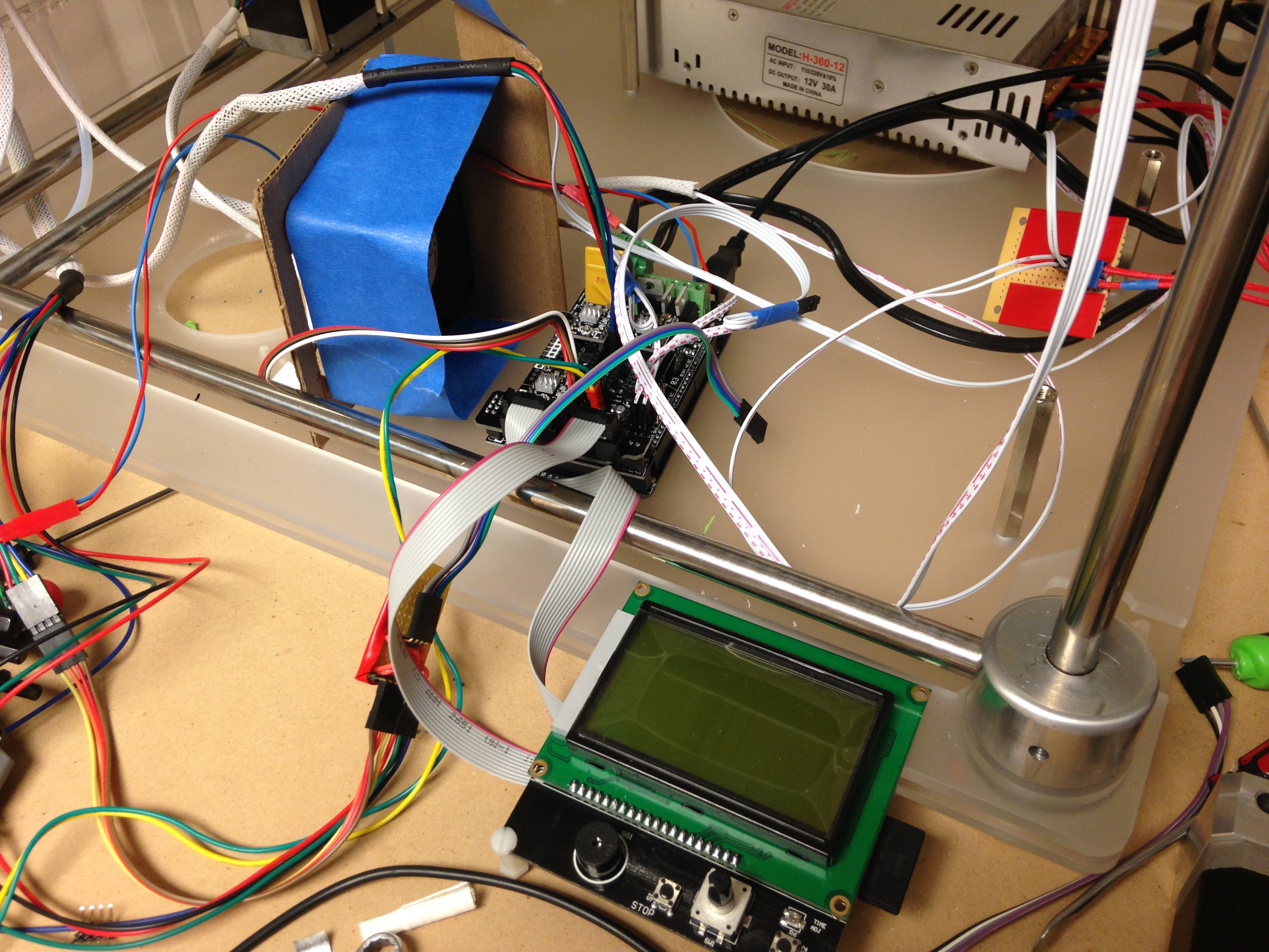

Hello all,
I recently purchased a Cubex Duo as my first 3D printer. I’ve managed to get several nice prints using Kisslicer, but I’ve had twice as many failed prints. I’m ready to begin modifications and go to a RAMPS controller as well as stiffen the bed and install a heatbed with a glass surface. I’ve seen only a couple of people doing mods to these things, so I’m hoping someone here can offer some advice on the best route to take on the modifications. The physical printer itself seems very nice especially since I bought it brand new for 1/10th the original price. I’m hoping the mods will unleash it’s capabilities.
  • I have already trashed the ridiculous filament cartridges and added external roll holders. I had to remove the filament tubes after the included filament kept breaking inside of them.
  • I bought a 300mm x 300mm MK2a heated bed and plan to build a more sturdy mount to install it to, I just need to get a glass printing surface.
  • I bought a Mean Well 450 watt 24 volt power supply to use independently for the heated bed.
** I haven’t taken the Cubex apart yet, but can I use the included power supply for the RAMPS board?
** Can I use the original stepper motors and extruders with the RAMPS board?
** Is a RAMPS board the best option or is there something better?
I’m watching YouTube videos on how to install RAMPS boards, drivers, etc., but if anyone has experience that they can offer, I would greatly appreciate feedback.
Thanks again!

I can’t give much specific help, i’ve never used a Cubex. But after reading some reviews on them I think i’ve got some general things that might help…
a new control board won’t necessarily fix whatever was causing your failed prints. Make sure you’re calibrated as well as you can be for everything, bed leveling, Z Offsets, temperature sensors placed correctly, etc…
If there is a calibration error a new controller won’t fix it, but the process of installing a new controller will probably ensure you check each thing and it will get fixed :wink:
Marlin firmware is the only one I’ve used since moving out of the proprietary XYZ Printer realm and I love how much I can control with it. It works with just about every motor you can get, so although I’m not 100% sure about it, I would be very surprised if you can’t re-use your existing equipment. To the firmware it’s just about how many spins = how much physical space to move. You’ll set that up in your initial setup steps. You should be fine with it. Cubex made the hardware work (sort of) You should be able to as well. Just take your time and understand each part of your printer and each part of your firmware before moving onto the next thing. Just because you can make it work doesn’t really mean you “get it”. Work with it until you have your head wrapped around it and as problems come up you’ll be much better at fixing them.
Good luck, and keep at it :smiley:
-–edit—
Also for your bed, check out http://www.thingiverse.com/thing:6599 77. Put some springs around the screws holding your bed to the platform and it becomes SUPER easy to level again when it gets out-of-whack. Big Big time saver :smiley:

Upgrade the stepper drivers to DRV8825. I’ll post my Marlin config.h for you later tonight Go with optical end stops. Much easier to use.
Make sure your RAMPS shield has the higher voltage rated components. You will find that the z axis is still a pain. Driving that nema23 motor consistently at 19v is painful.
The steppers are ok but power hungry. Be sure to tune your stepper drivers. I’d also consider converting to E3D hotends and Bowden drive to make things easy. Direct drive with the stock components still creates issues.

Awesome! Another Cubex owner! I’m replying as best I can on this smart phone… I’ll dig deeper tomorrow when I can sit at my pc… I’d like to order some hardware ASAP, so thank you guys so much for making recommendations. CollectorCNC, I need to start following you. I’d like to build a CNC machine as soon as I get this 3D printer going… I’m assuming you know CNC as well due to your name. Thanks for offering your config.h!
I forgot about the RAMBO… I bought the Mean Well 450w 24v power supply to run independently for the heatbed. I thought I read somewhere that it would provide enough power. Good advice on the insulation. The mk2a heatbed/element isn’t exactly flat… I was thinking about using a sheet of aluminum roughly 300mm x 300mm as the bottom of my heatbed. It’ll be solidly mounted to the frame pieces coming from the rear supports. I think once I get some bolts and stiff springs at all four corners of the mk2a, it should flatten out. The only concern I had with solidly mounting the glass was the chance of a print sticking to the plate. Does it help to get high tensile glass? Thank you for all of the information!
Here’s the full config file. I have built my own CNC Router and several 3D printers, and would be happy to help if you have questions.
Key things to remember:
  • I’m using single extruder with E3D v6 hotend
  • my fans are either 100% on or off and all powered directly from the PS
  • steps are calibrated to my steppers (1.8 degree 1/16 micro stepping and 1/8th on the Z)
  • I’m using stock MXL pulleys and belts
  • I’m using the stock filament drive system (not ideal)
  • I run 2 360w 12v power supplies.
  • One PS for my heated bed and one for the arduino/RAMPS shield. (you can run the 24v bed from your 19v PS in bang bang mode by using a relay.)
  • I have auto bed leveling installed
  • The Nema23 stepper is fickel. Spend time setting things up properly.
  • Get some sheet plastic at hobby lobby or michaels and use it to seal up the big open windows, magnets glued to the inside of the case work great, and this helps keep that giant heated bed from cooling too much on the edges.
  • unscrew the pucks on the lid and flip around so the vent is closed off.
  • I probably forgot some stuff since I have a pretty solid setup now so if something doesn’t make sense, feel free to ask.

I added a post a little while ago with a picture, but I don’t see it in the thread.

I have a few pictures, but last time I tried to post them, they never came through for some reason. I’m going to see if I can edit/add them to this post after submit it.
