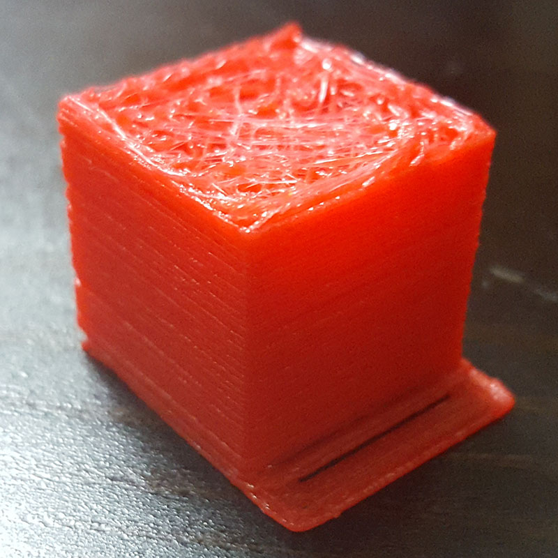

I’ve been trying to get my printer going and tried many different settings but have weird problems.
The pla filament keeps clogging - I’m going to replace the feeding tube as it is already distorted - but it’ll take awhile to order the telfon tubing stuff, so hoping I can continue without.
My neatest print on the sides was at 210 for pla… but the top didn’t fill.
I got a better face print on the lower levels with 180 down to 175 but on the later it just went all threaded and failed to print the remainder - there should be lips.
There’s a 2 cm by 1 test cube - seems to keep missing bits. I’ve checked my calibration and seems fine for x y z… not sure how to do it for the extractor.

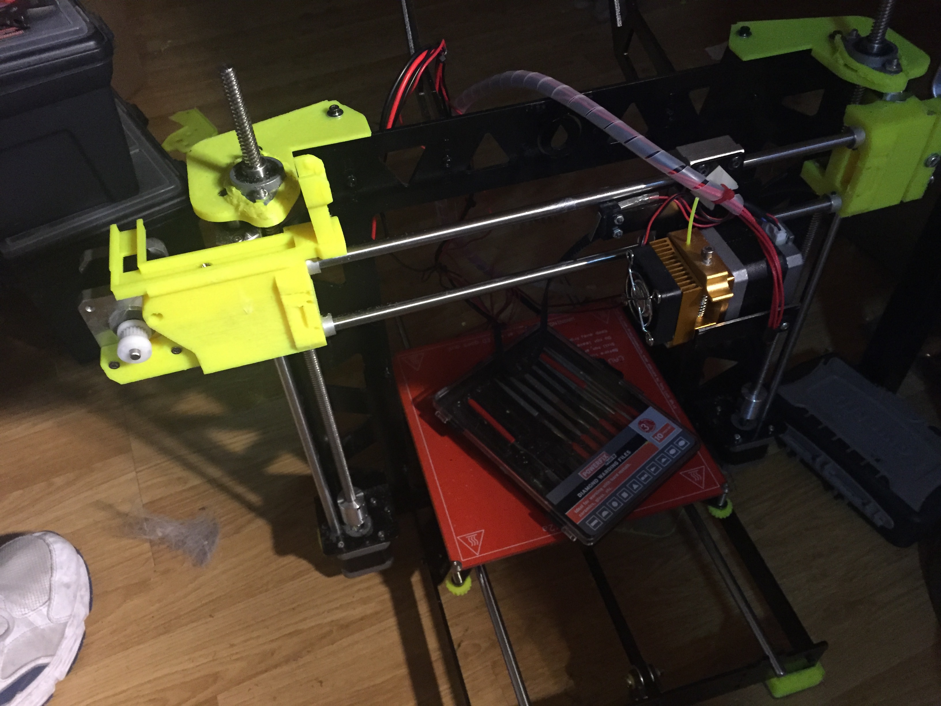

does your printer look like this? http://www.geeetech.com/wiki/index.php/Acrylic\_Prusa\_I3\_pro\_B
The smoothest was at 210 on the photos (outside of the slip - i’ve tightened the x-axis and that seems to have fixed that) - but the infill didn’t seem to work enough to build a base for the topfill. Pretty sure I tried 195 but it seemed to just leak plastic.
I’ve updated with photos (they wouldn’t upload from mobile >< ) so you can see the machine is very similar - except for the extruder - it uses a premade plastic piece with a small metal gear inside it, and hot end tube (mine looks the same as the one here Talk Manufacturing | Hubs - also burnt and horrible after only 4-5 attempts at printing :frowning: ).

Looks like you’ve got missing filament from the perimeters, particularly on that first cube. Do you have feed problems? Is your PLA consistent diameter? Extruder clicks?
Have you tried printing a lot slower?
From my ruler - the PLA seems ok… but I need to get myself some digital calipers and do a more accurate check I think.

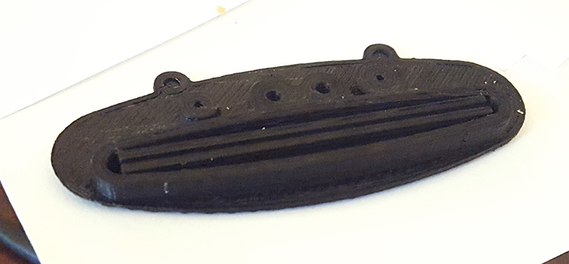

I bought some ABS from a local retailer - and I seem to get much better results, i’ve tried using the Prusa I3 settings too, and that seems to have helped, but my first layers have still looked very sparse. I do get a bit of Extruder clicking - but it seems to do it constantly, even when pushing out a steady stream.
Attached is my ABS print - 258 degrees first layer, 255 for later, and 105 bed. The fill to the edges still has some gaps, and one corner seems to have missed out on extrusion - my guess is these are all indicators of under-extrusion? What’s the best way to fix that?
I’ve cleaned out the nozzle and tube a lot with PLA - when i swapped to trying ABS, I ran through quite an extrusion till it was definitely all ABS, and been able to return without cleaning the nozzle every use without much trouble (outside of the possible under-extrusion).

I got hold of a CTC i3 pro off of ebay which was not built by me, but the previous owner.
After some investigation on this priter I found too many issues with the build quality, and decided to do someting about it.
The first thing I bought was a hand held 3D pen to use as a plastic welder for some parts that need to be bonded. I still need to practice welding with it, but it dose the job well. The next thing I purchased was a steel frame from Orballo, as I have the intension to keep most of the serviceable parts from the CTC. That was the intension, but the main board blew so I have replaced with a ramps 1.4.
both of the z axis lead screws have been replaced with proper lead screws with a 2mm pitch.
I also have replaced the extruder with a bowden, and upgraded the bed to a 200 x 300. The photos show a standard extruder
I have also remade some feet I found on thiniverse to allow perminent fixture to a base board for stability.
Most of the modification parts and other parts I have designed can be found on thingivers, including some for future upgrades.
I am also installing auto bed leveling and a remote hot bed mosfet switch. This is to remove the load from the controller board, as I was concerned with the amount of current being drawn through the tracks of the pcb.
The other Issue I found with the CTC is the psu, the max current delivery if correct on the psu info lable is 15 amp. This means the Psu is beeing driven to the max. I have upgraded to a 30 amp psu which will give a more constant current delivery.
