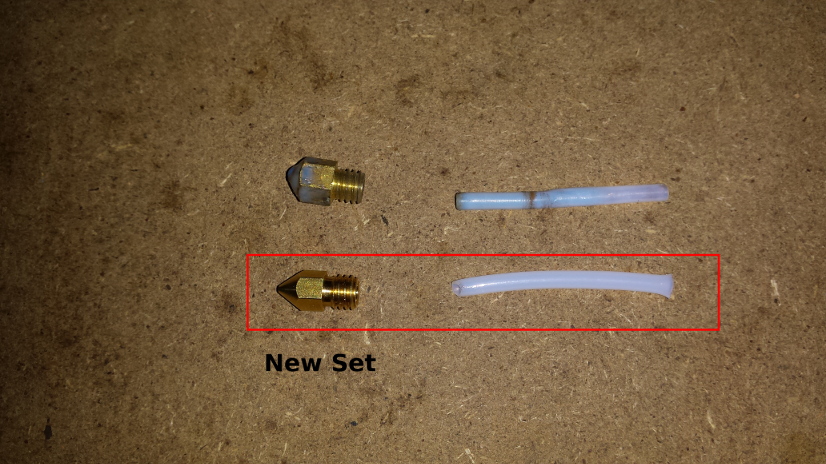

If you have an address send me over a message on here and I’ll post you replacment ones free cut to size all you need to do is remove the nozzle and slide this tube in and out the nozzle back on

I wrecked one of my teflon tubes, too. I bought a 5-pack of replacement hot-end barrels off Amazon but they had 4mm OD PTFE linings in them, and a lot of stuff just printed too differently for my taste. (PLA and ABS seemed to print fine, but PETG-- my bread and butter material --didn’t print right anymore.) Either due to the different barrel design, or additional thickness of teflon…
I finally just bought a meter of 3mm OD PTFE tubing and waited like a bloody month for it to arrive from Malaysia via slowboat while I used the lining from the left extruder to get the right one back up and running. Taught me an important lesson though; stock up on replacements of anything that can take down your printer!!!
Also, stay away from PFA. It’s supposed to be rated for the same temps as Teflon and it was easier to source in the right diameter, but if you take it up to 240°C to print PETG or something…it’ll LIQUIFY. Not melt or deform, LIQUIFY. (Invented some new curses for that one, I did.)

It was from that I persevered with it, I replaced the stock fixed extruders with spring loaded ones which has solved the skipping on the filament. I replaced the PTFE tube with that which is 1mm longer so that it’s compressed in the thermal barrier tube, no more clogging or jamming.

The thermal barrier tube is held by a set screw. Unscrew that and take it out you’re done. Btw you shouldn’t mess with ptfe lined tubes…AT ALL… EVER. There’s no possible way to print reliably with this printer unless you get threaded thermal barrier tubes with no ptfe, and with thermal paste on the cold side of tyre tube ( not the side that screws into the heater block) , and thermal paste where the heatsinks touch the block. If you stick to ptfe lined barrels all I can say to that is good luck!
With all due respect, although its a “clone”, makerbot released drawings to their replicator 1 that were wrong on purpose so all the Chinese clone makers got suckered. Original makerbot had threaded thermal barriers and worked.
Does anyone know how long the tube is supposed to bet cut to?
34mm + or - 1mm

Don’t remove the tube. Buy a new one and put it in there if not you will have nothing but clogs. Also a but of baby oil helps a ton. I usually have it on a lint free cloth piece and when the filament is being pulled it passes by the baby oil just enough to keep things lubed. Not really needed for oily filaments like abs, but pet, pla, XT and so on do need it and makes it print very smooth. Haven’t had a clog since I started doing this baby oil trick.
