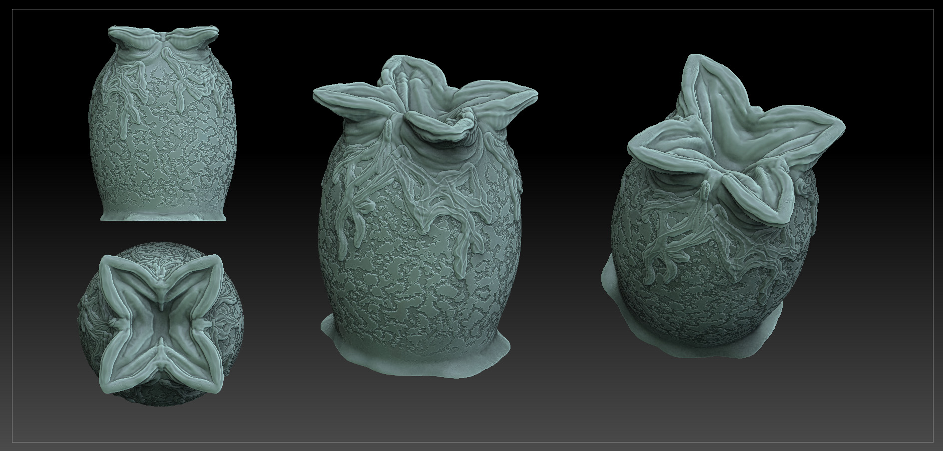

After giving it some thought I gathered lots of reference photo’s and found out there’s a lot out there regarding this “Egg”. I decided to go with something that would be cool to make and sort of unique but still recognizable, well, at least for the fans out there :wink: In Zbrush I blocked out the shape pretty quick, it’s not exactly an egg ofcourse but the whole thing is simple by design as you can see. The cool thing in Zbrush is that you can work in symmetry-mode(s) and quicly get a good shape. In overall, the whole thing took me maybe a few hours worth of designing and cutting it up about an hour or so. That’s why planning ahead is important with designing for 3D printing.
Early work in progress version…didn’t like that texture on it’s body
Final version…

Hello Alex3DHubs! Don’t know why I didn’t include that question in my post :wink: Unfortunately there’s no way for me to edit it again as far as I can see. Anyway, regarding you question; you can go about it in a few ways. The way I usually do it is within Zbrush.
Splitting up the model
  • If I think my model is finished and ready to be printed, I merge all sub-tools (separate objects) into one.
  • With Dynamesh I can turn it all into one continuous mesh. So now I have a mesh that has everything fused together.
  • With this new mesh, I make sure it’s Dynameshed (it should be :wink: ) and now I can slice it up one of the slicer brushes. You just draw a “line” where you want the cut and it will divide the object into 2 separate polygroups. For this model I had to make a few slices so I would have 8 separate pieces and they would all be there own object.
  • After slicing I separate them into sub-tools, since they have their own polygroup that’s is very easy with the click of a button. Now I will Dynamesh each piece so it will have a nice continuous mesh and holes and errors will be filled up with new polygons. After this I will create the keys and holes.
  • Optional technique: depends on the model a bit, for example a small figurine or something, or a model that you don’t need to slice up. I make a copy of this unified mesh, I use the Zremesher function on it. This will create a low-resolution mesh but with even polygon distribution, makes a really nice mesh. Then I will reproject the details of the copy onto this new mesh and divided it up until I have the desired detail back.
Creating Keys and Holes
  • After I have the pieces all separate there’s going to be a bit of tedious work :wink: It’s a simple process of adding and subtracting objects. First, I will plan out how I want the objects to connect to each other.
  • I have made an Insert Brush which consists of just one cube that’s a bit tapered toward it’s top. Doing it like this will sort of guide it in place when printed.
  • With the selfmade Insert Brush, I will create a cube onto the flat surface on the desired side. I Dynamesh it again so it will be part of the whole mesh. Now I make a copy of this object because using the following technique will have it merged and if something goes wrong I can simply try it again, fast :wink:
  • In the sub-tool pallette, you set to add or subtract. I choose the object with the key, to subtract with model above it which doesn’t have a key or hole. This way you will have the perfect hole for the key onto your mesh. What’s actually even better is creating a key where you want it, split this key off and duplicate it. Now you can scale the copy of the key a little bit bigger and use this version to subtract a hole onto the other mesh. Now you will have a slightly bigger hole since printing with plastic isn’t an exact science. Lots of factors will make the hole (or key) a fraction bigger or smaller. This way it will always fit and when you glue it it will never come off :wink:
Hope this explains it a bit, having a bit of Zbrush knowledge will come in handy. I know there’s another program called Magics (at least I think it was that program). You have the option to load your .STL’s and creating keys and holes but probably (or maybe) a more easier way.
