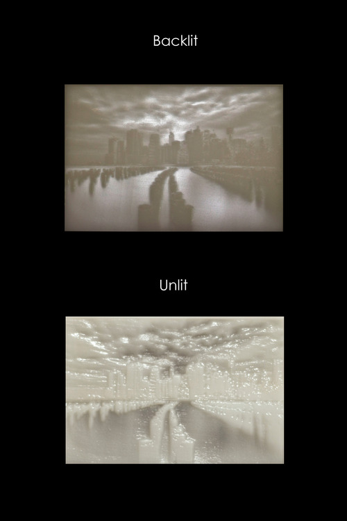

Traditionally, lithophanes are 3-dimensional images, etched or molded into a thin sheet of porcelain, which can only be seen clearly when they are backlit. Sandra’s lithophanes were inspired by 1800s lithophanes, but unlike their predecessors, they have been printed with White Resin on a Form 1 and other SLA printers.
Having no previous experience with 3D printing, Sandra decided to work with a retail service that helped her produce and design her first prototype (based on the image above) using an FDM printer. But FDM didn’t turn out to be the right solution and the quality of the print would not make the cut for a gallery show. Luckily, she met Jose, who’s been active in our community since April last year.
The 3d printed lithopane​
Achieving the right print quality
Sandra’s first prototype was printed using FDM technology, but as Jose explains, this process would never deliver the desired outcome: “Instead of creating a solid part with gradual and highly defined surfaces, FDM type printers create a topographical map of sorts. The filament builds up in very thick layers, and for the purposes of this print, we were looking for thin layers and a highly defined surface. In addition, we needed to angle the part in every dimension to prevent any unnecessary material build-up that would erode the different parts of the lithophane.
That’s why I advised Sandra to try an SLA technique. Contrary to FDM, SLA uses liquid resin instead of plastic filament. To solve the build-up issue, we pitched the lithophane on the x and y axises and tilted it on the z axis. All the resin was able to flow off gradually as the part grew.”
The printer was set to a .025mm high resolution, so the print time took 32 hours in total. After removing the supports, Jose applied a light coating of clear UV resistant spray to keep the part from curling and yellowing any more than necessary. The results were simply stunning and have driven Sandra and Jose to host their own art exhibit: “The Art of 3D Printing.”
The 3D printed lithophane both lit and unlit

Thanks for reposting Arnoldas!, This was a tricky print. Since then Sandra has created other lithophanes and I was actually interviewed by Univision and asked to 3D print a “selfie” of the reporter. You can see the whole interview here (http://miami.univision.com/…/enteratec-impresion-tridimensi…) It is a great way to use 3D printing for a 2D image!

Hi Jose…what were the dimensions of the lithophane? What were your set up parameters on the Form 1+ to print at 0.025 mm? I have had a lot of trouble getting relatively thin/large prints to print successfully (no warping, geometry as modeled, dimensionallyrics accurate, 3tc.) at that layer height. What software did you use for the lithophane STL? Thanks! Joseph

You can make your own here http://3dp.rocks/lithophane/
And yes, use white resin and high-contrast B&W picture
