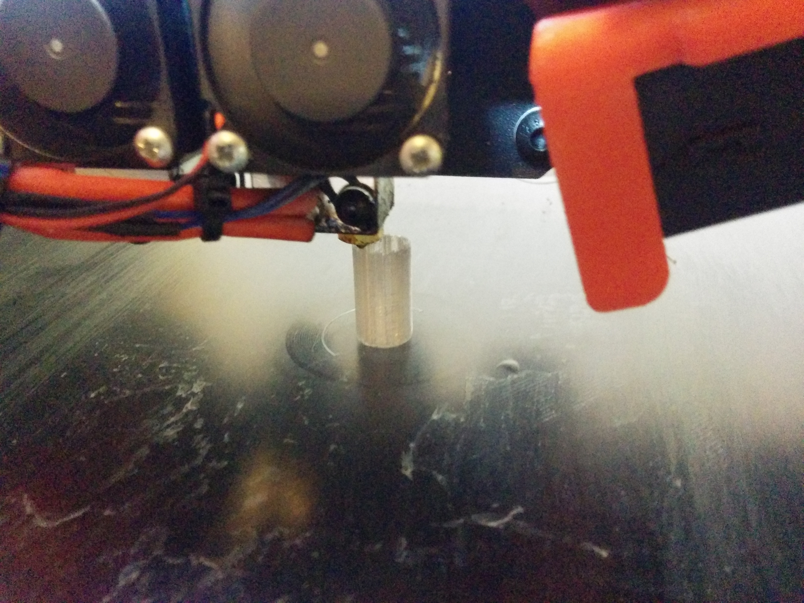

Actually, I just changed one of my nozzles last night for the first time, from .4 to .25. I have a MendelMax 3 Dual, with E3DV6. I designed a small part for a friends Dremel grinder, and needed the smaller nozzle for the fine detail of this part (a 10.4mm dia spline). Followed the E3D wiki directions: Loosen heat break, heat up to 285C (pulled filament @ 235C) , Remove nozzle, install new nozzle and tighten, let block cool, tighten heat break.
In S3D, changed nozzle size to .25, manual width to .25. Printed a 20x20mm cube, single wall, no infill or top. Wall thickness came out to .29, so I set width to .29 and printed my part in natural PETG at 75% infill, .200 layer height. Part seems to be great.
