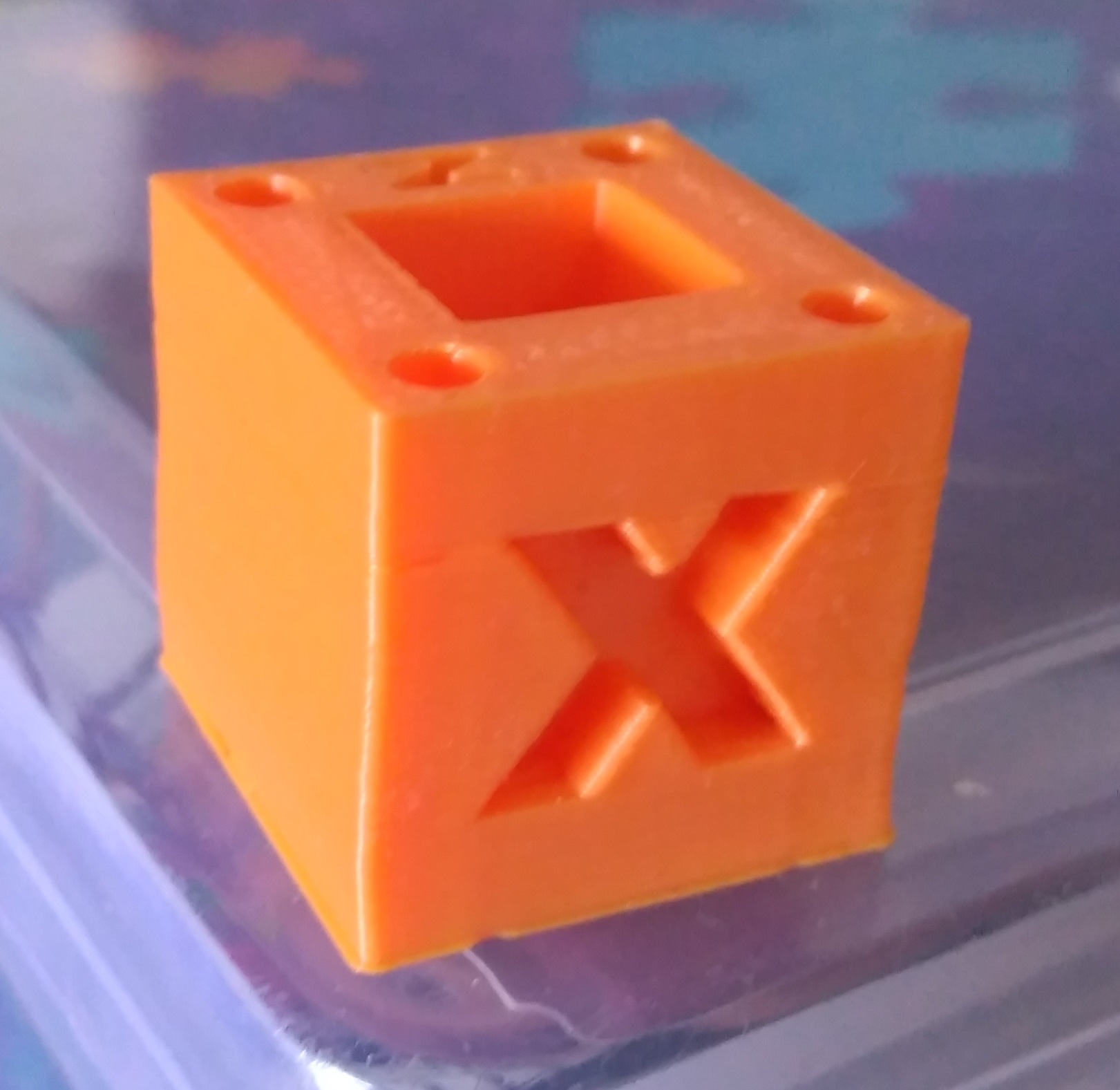

Small object are printed pretty well: (can’t upload the image :frowning: )

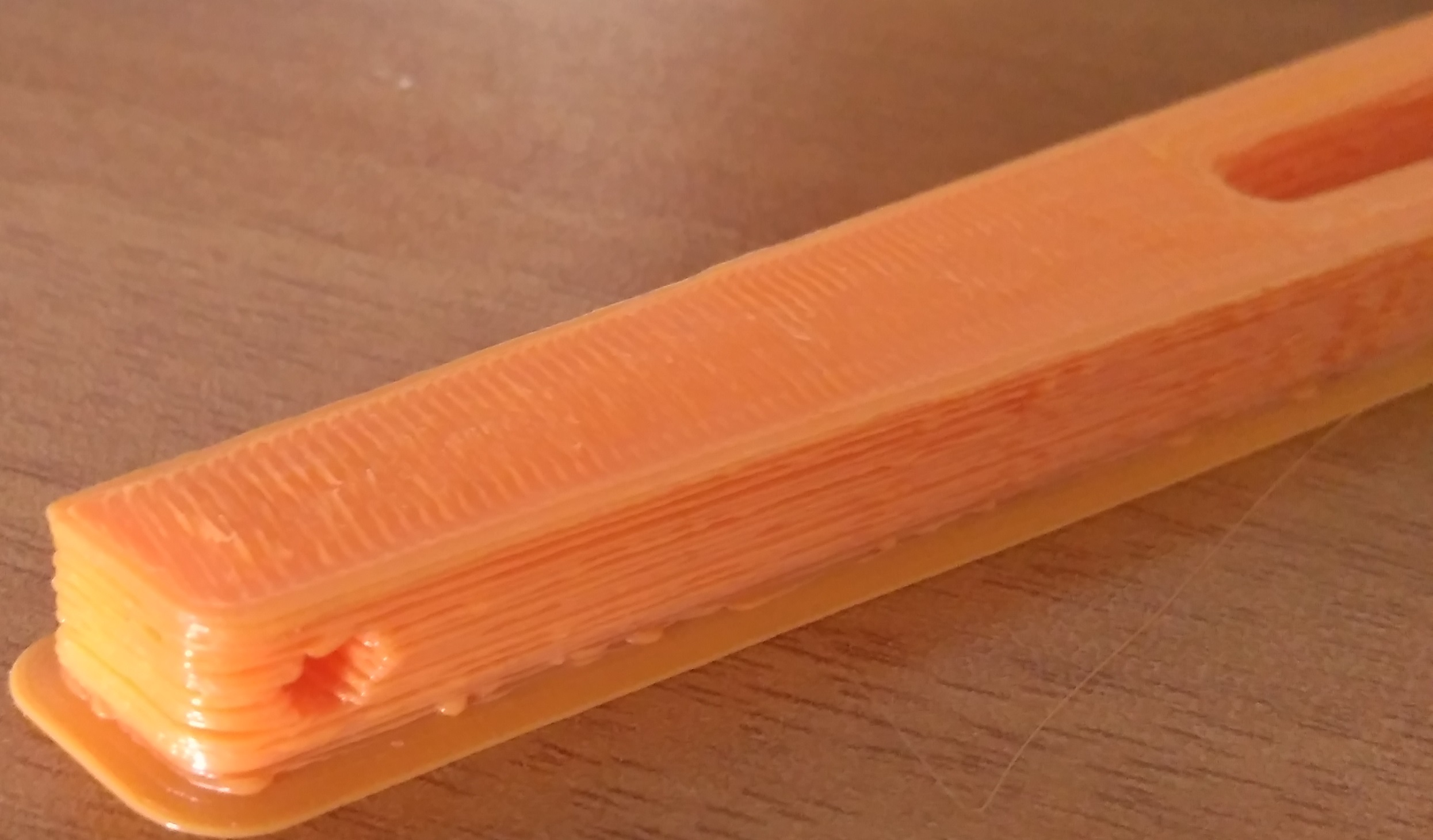

When I print big objects, it looks like:
And layers are not sticking to each other: (can’t upload the image :frowning: )
I tried to print the test boat. It starts well and then at a certain height it gets bad:
After many attempts to solve the problem, I am running out of idea. Has someone any clue?
