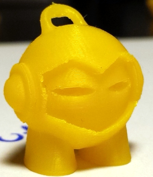

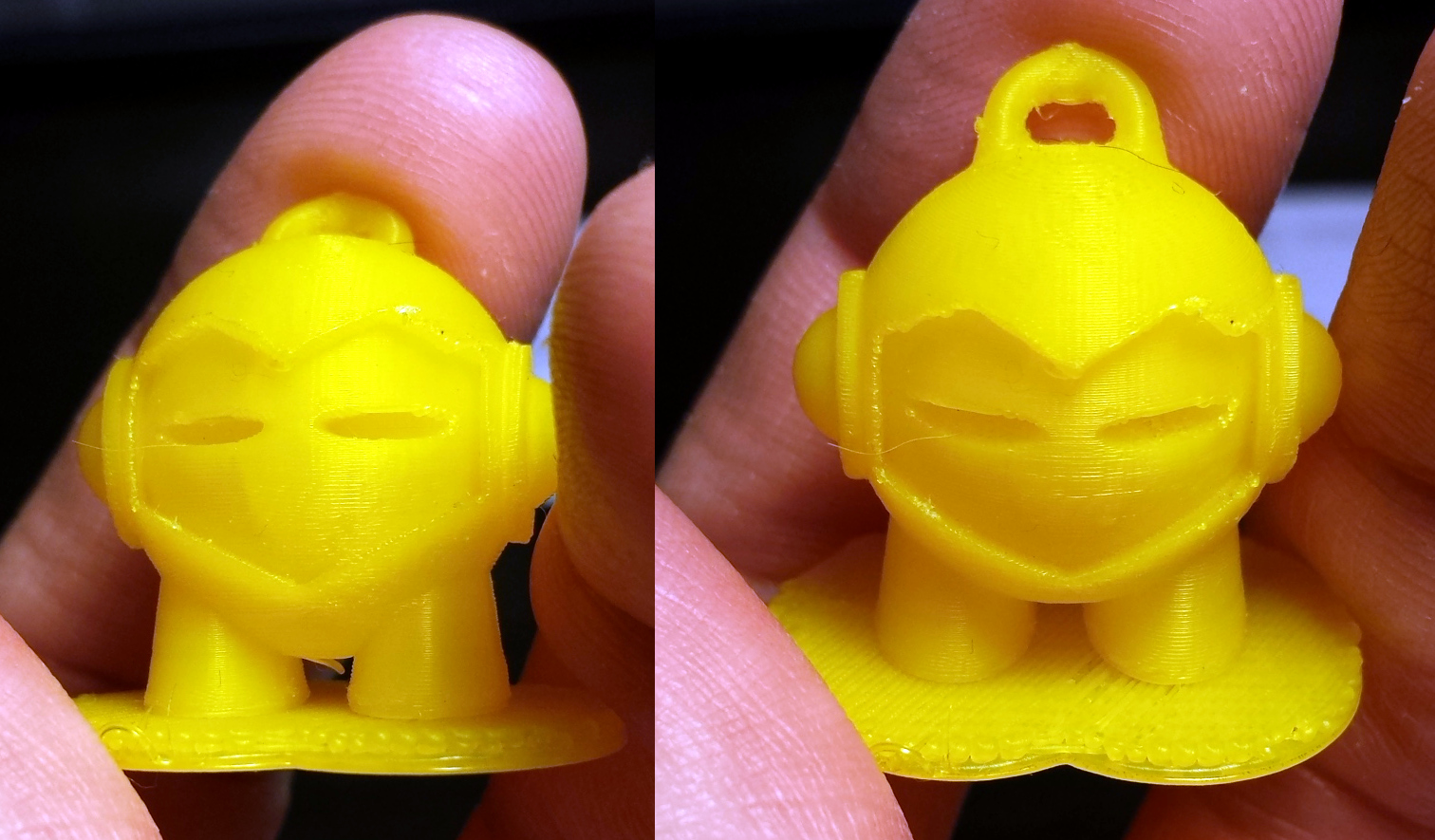

After a lot of testing and tweaking, I decided that some zits (at the sharp corners of some facial areas) were unavoidable on such a small model and with a 0.4 nozzle.
Not sure how this will show up, but I have attached a BEFORE and AFTER photo.
Before is the results I settled on. After is after removing the zits with a fingernail and tweezers.
I think this is the best I can really get on such a small item (2.5cm tall) and 0.1mm with the N2’s 0.4mm nozzle.
