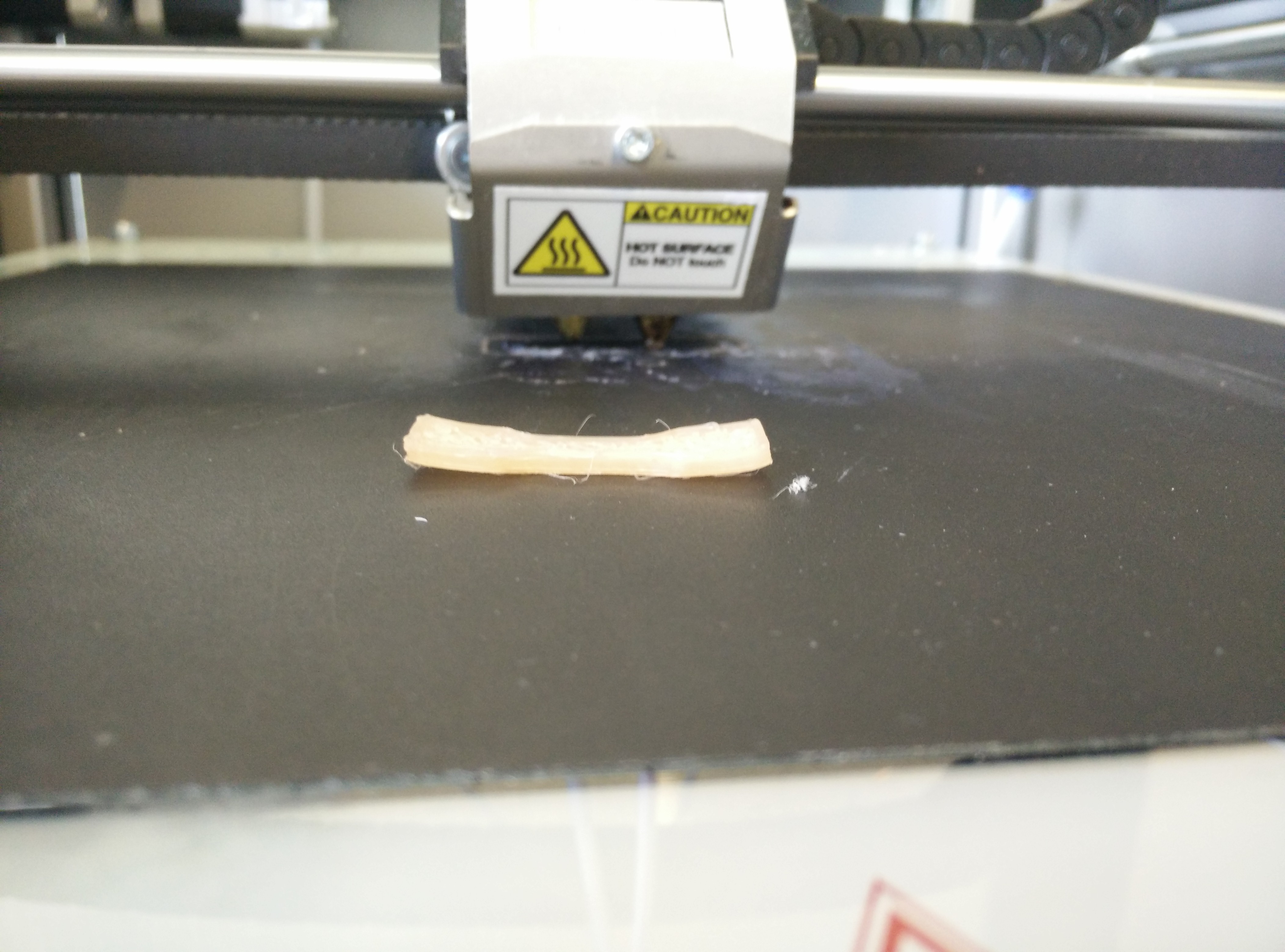

At this moment PP filament is already being sold by for instance GermanRepRap 8. I’ve tried some printing with PP myself but unfortunately I wasn’t able to get it to stick. 2I tried the following settings but so far without any good results:
The guys from the Perpetual Plastic Project have however been able to print PP 6. So this, together with the fact that PP printing products can in fact be bought, suggests that with a little more practice, PP can be used as a material for 3D printing. This is supported by my observations when printing PP. The extruding went very smooth and the layers sticked to each other nicely. The only issue remains the warping and the sticking to the bed, which of course go hand in hand.

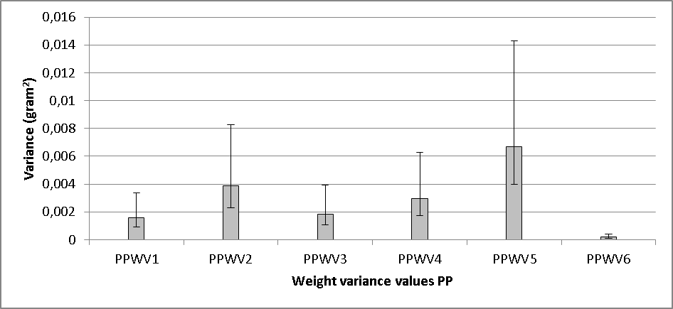

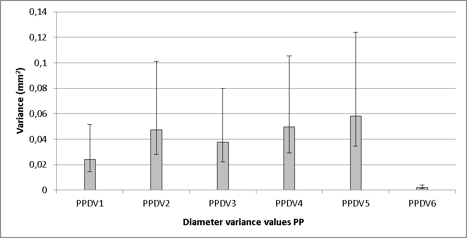

One other important part of recycling is the behaviour of PP when extruding shredded pieces into new filament. To test this I mixed different ratios of new PP pellets 1from poliplasticpellets.com 6 with 100% PP bag clips 2 that are shown in this picture:
I extruded the different ratios and measured the diameter and weight variance in the same way I previously did for PLA and ABS. 4The results are given in the following two graphs where the bars indicate the interval within which the values lie with 90% confidence. The abbreviations on the horizontal axes refer to the different material ratios as listed in this table:
From these graphs it can be concluded that variance is very acceptable for all ratios but that ratios of 100% new pellets and 50/50 perform best. New filament naturally produces by far the lowest variance since it is industrially produced. The diameter variance for PLA ranged from 0,001mm2 to 0,018mm2 and for ABS this ranged from 0,002mm2 to 0,02mm2.
Since the diameter variance of PP ranges from 0,017 to 0,123 it is a lot larger than the variances for PLA and ABS.

We’ve played around with printing PP but have found that not only do we have trouble getting it to adhere to the buildplate, we have trouble with layer-to-layer adhesion. This results in a print with low strength and a high tendency to delaminate.

Try printing PP with this settings: temp- 245-260 (temperature depend on room that you print in. PP must be printed with higher temperature than you post), infill 25%, speed strat slow (35-45mm/s). if you get object to stuck on bad you can than speed up to 60-65. first layer that you print print as much as low as you can. let the head/nozzle press first layer to bed.
7 months later
I know it is an old thread, but maybe for other users, it is quite easy to get the PP print to stick. Just put the transparent duct tape on the bed. I think it even sticks without heat (don’t remember anymore, quite a while since I last printed it). The issue with PP so far is the warping of thin walls. I haven’t tried it with my new setup though, maybe I will get it to work in future.
I recently even got POM to stick well and was able to print some nice gears. I think POM is even more interesting as a material than PP regarding its properties
