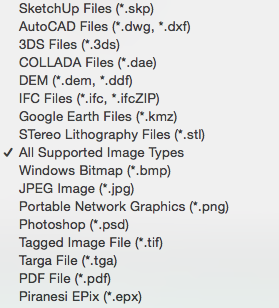

Google earth can be imported into SketchUp.
1. You can preview your model in Google Earth
2. You can import Google Earth Files (.kmz) into SketchUp
3. You can add a “geo location” to your model which will bring Google Earth landscape into SketchUp – you can then model on top of it, and I think there is one extension that can help you create buildings from it. But you can quickly model from a google earth image
