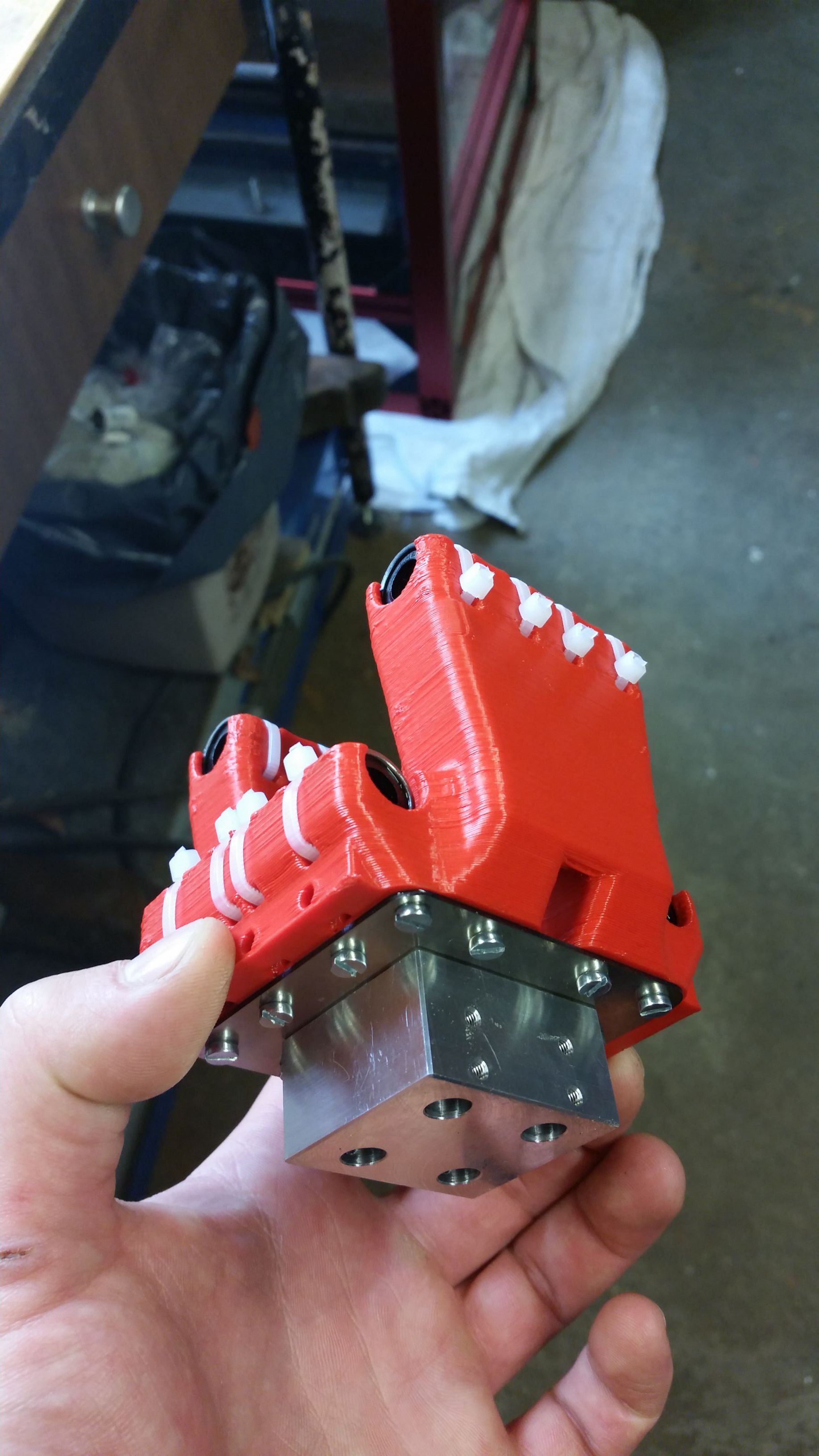

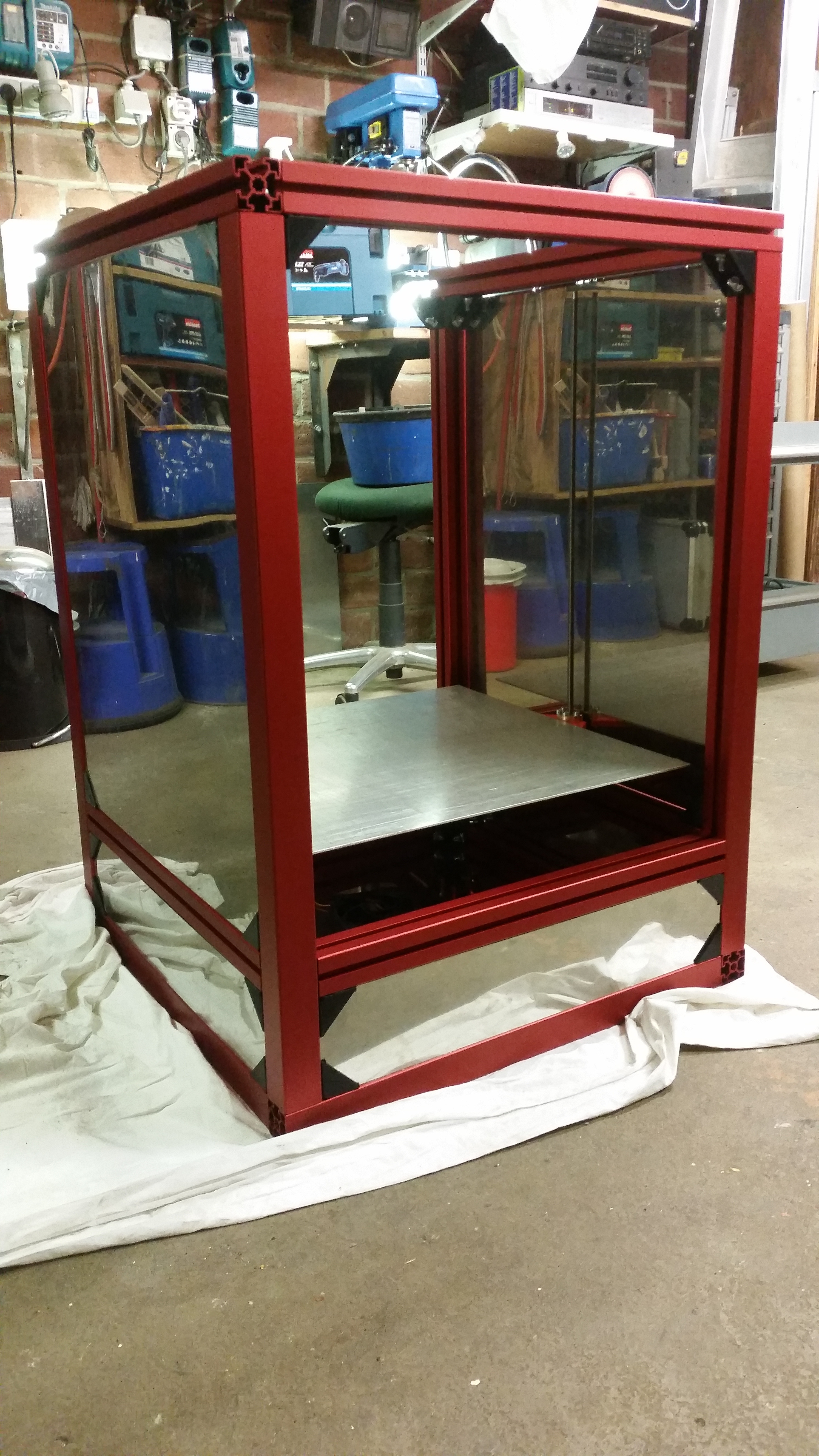

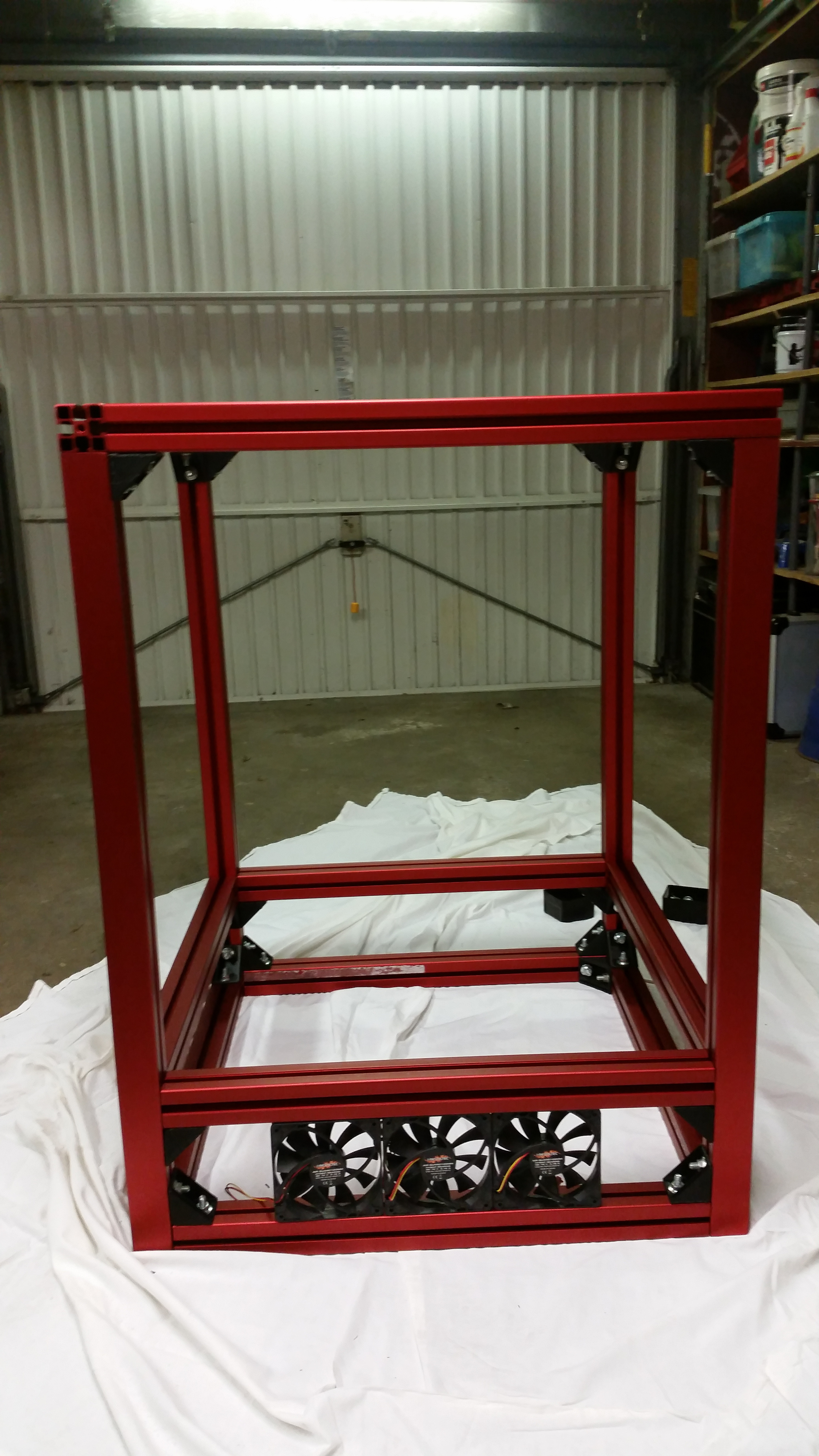

I am building a big format 450x450x550 Printer. Do you guys have tips and tricks? I am using the Kraken 4 nozle head. With the Duet board and the duex4 expansion board.

Bit by bit it’s beginning to look like a printer
Make sure the bed is leveled at all corners.
Bed must be well supported and not moving. Extruder should be moving in the x, y axis. Lower and lift bed for the z axis.
Large objects warp even more, heated bed is highly recommended.
Use 1mm nozzles to print large objects faster.

You told a lot of things correct, the plate seems to have little thickness, but I never used it extruders Kracken your electronics

i am going to be able to ajust the bed on all4 corners,
i also have a costom made heatbed of 760 watt 450x450 mm.
and i am going to try buildtak.

i got a heatbed and a reinforced glas plate,
i print on the glase plate because it is flat.
the print material sticks to this surface quite well.

Heej guys bin a wile it’s looking more and more like a printer. Discovered that I have to have a better quality guide rods. Any Ideas were I can get 8mm rods 600mm long?
