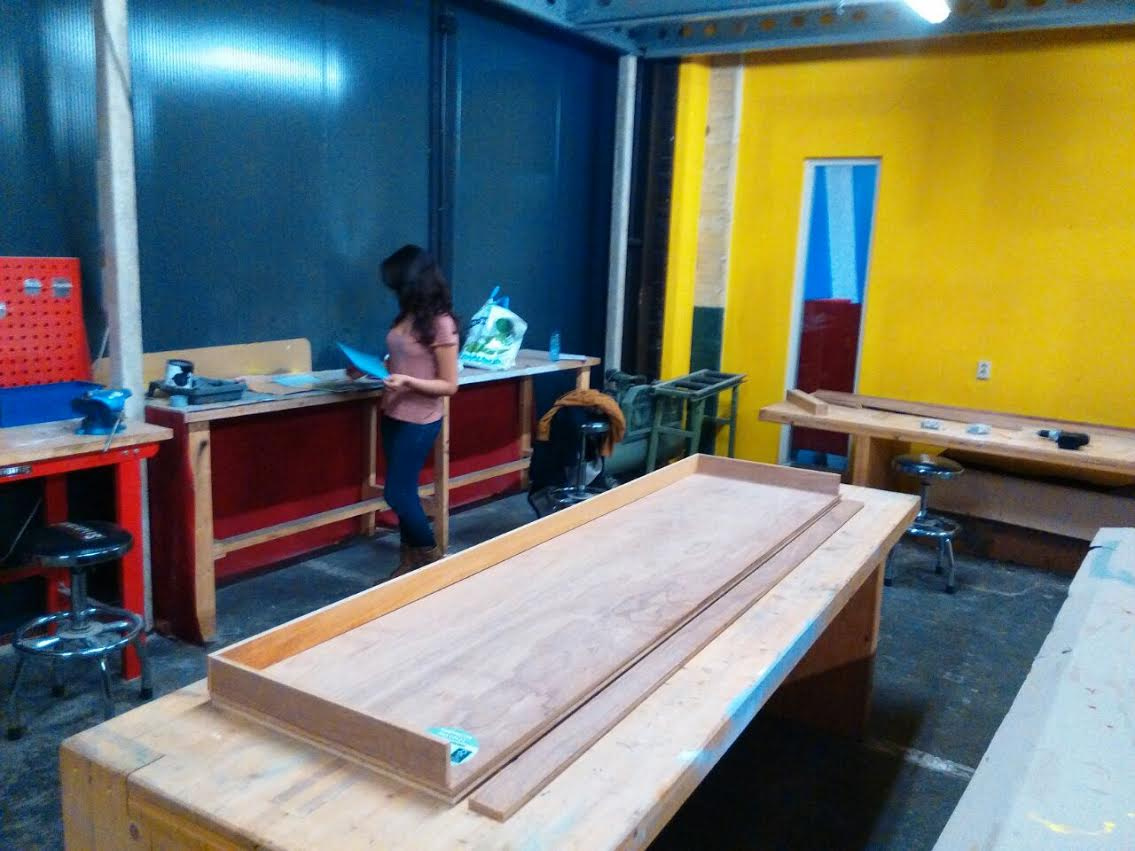

We’ve just finished with the first part now: We bought 2x plywood boards of 244 cm x 122 cm, cut them and screwed them together for the frame (the table size : 244cm x 61cm):

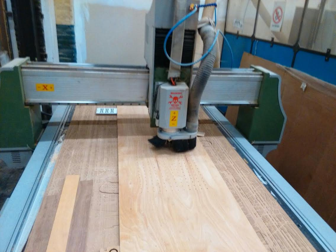

The next step is to mill holes with the CNC machine for the LED’s (there’s going to be exactly 300 of those). It took us about 2 hours and we did this at iFabrica here in Amsterdam.

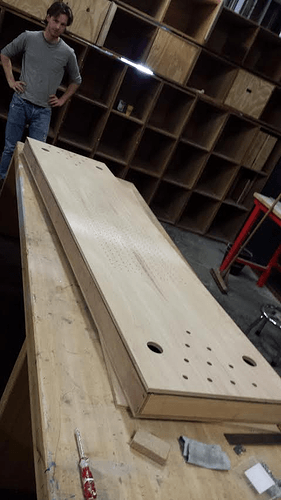

This is how it looks after the milling - you can also see the plexiglas sheet that we’re gonna put on the top of the whole table to make it waterproof and also help diffuse the light to make it look even more badass!
We put some tape in-between the two parts for the damping
And finally the painting - we just went for a classic black paint to increase the effect of the LED’s and colors.
