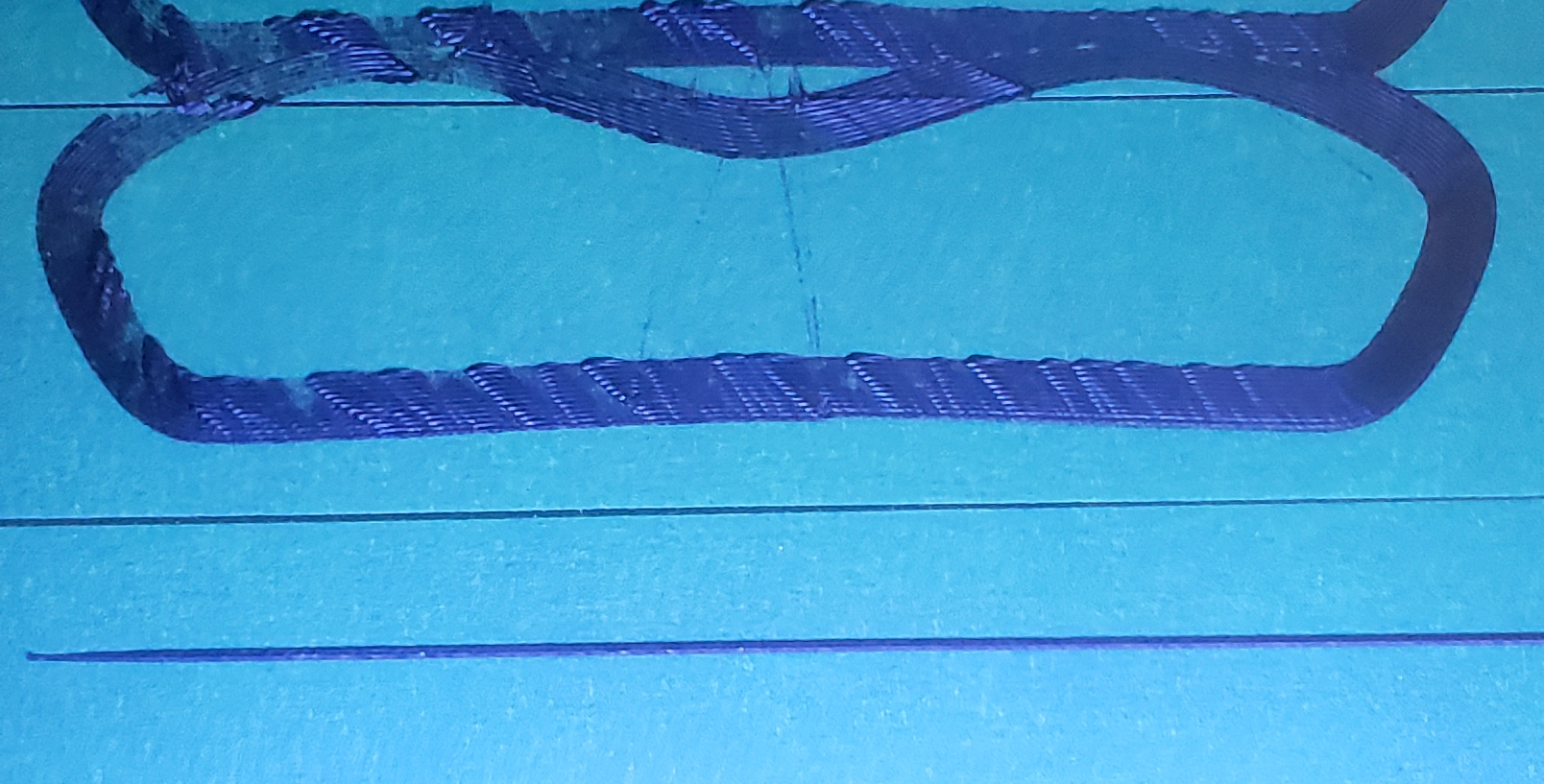

Any reason why my brims are starting to print wavy and not clean? Never had this problem before now. Been using the same filament all week.
It looks fairly uniform and across the print… suggests some interference on the x or y axis, maybe a tugging on the bowden tube every few millimeters?
