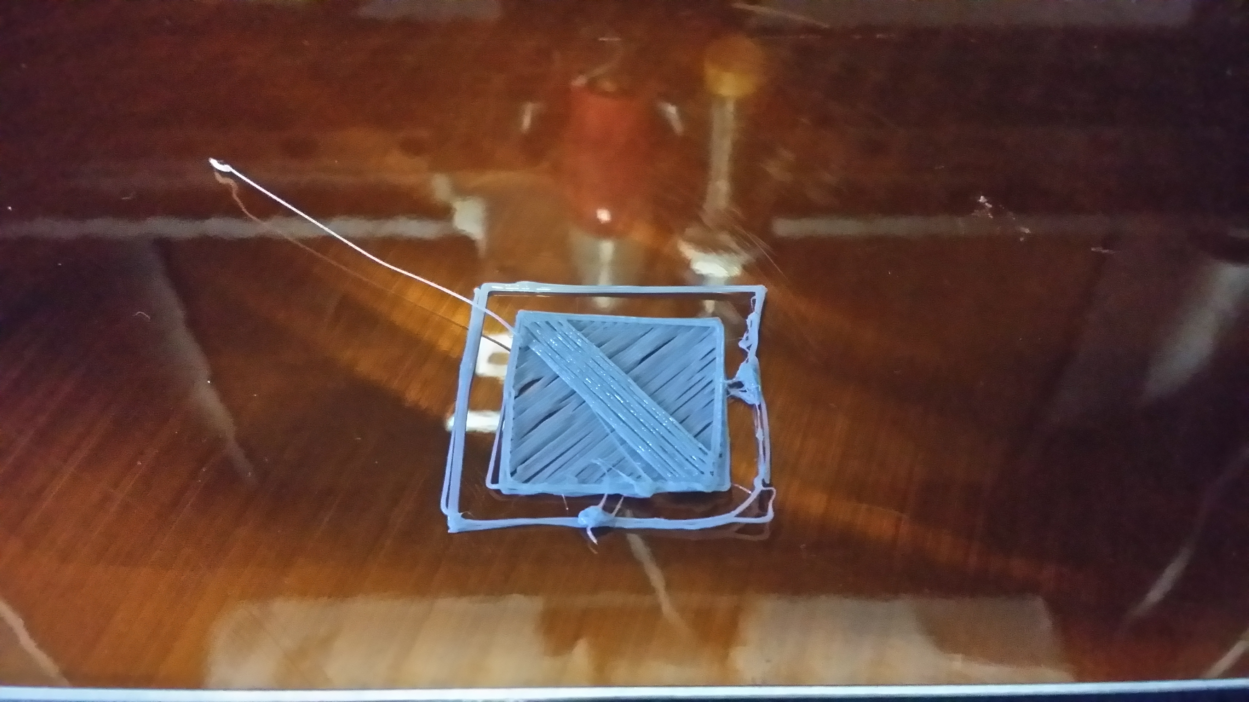

I’ll print a test print to show my layering I’ve not seen any deformation in the past I’ve seen it on the second layer get wavy

I agree that the first layer setting are very heavy. It is close to the max capacity of an extruder. It will probably not melt the plastic quick enough. Resulting in cooler plastic being deposited and maybe even more resistance resulting in missed steps or slipping filamentresulting in less plastic than calculated by the firmware. So lines do not touch and/or are not hot enough to fuse together.

No, I think you should decrease bottom layer Line width to 100% and bottom layer thickness to 0.2mm. You will extrude less than half the volume per time unit which is easier to heat up consistantly.

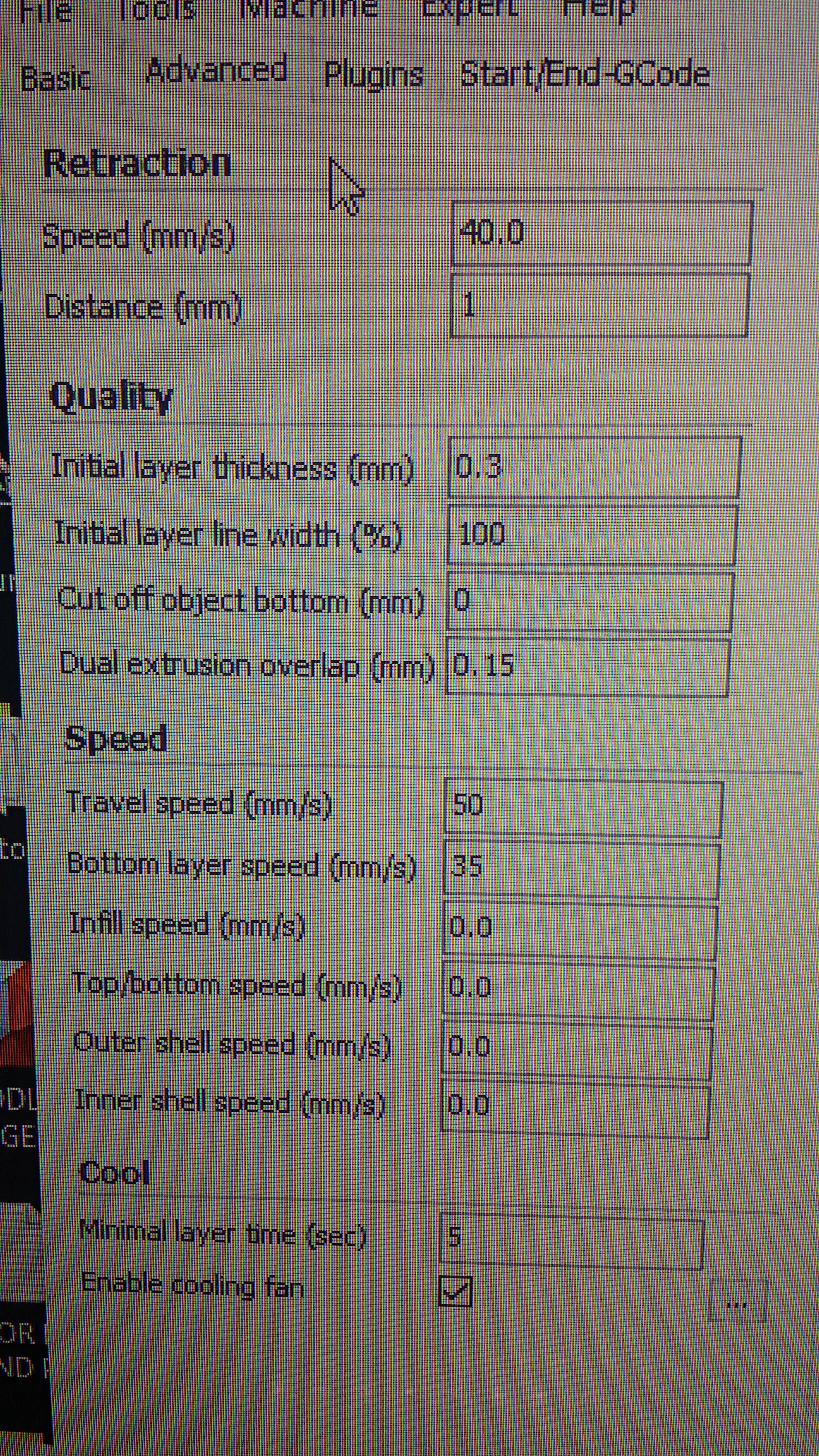

Ok this is the settings I am using now like everyone told me to change and this is what happens special when I change the width from 200 to 100 so I guess the z hight is off but why when I use 200 inicial layer it’s fine

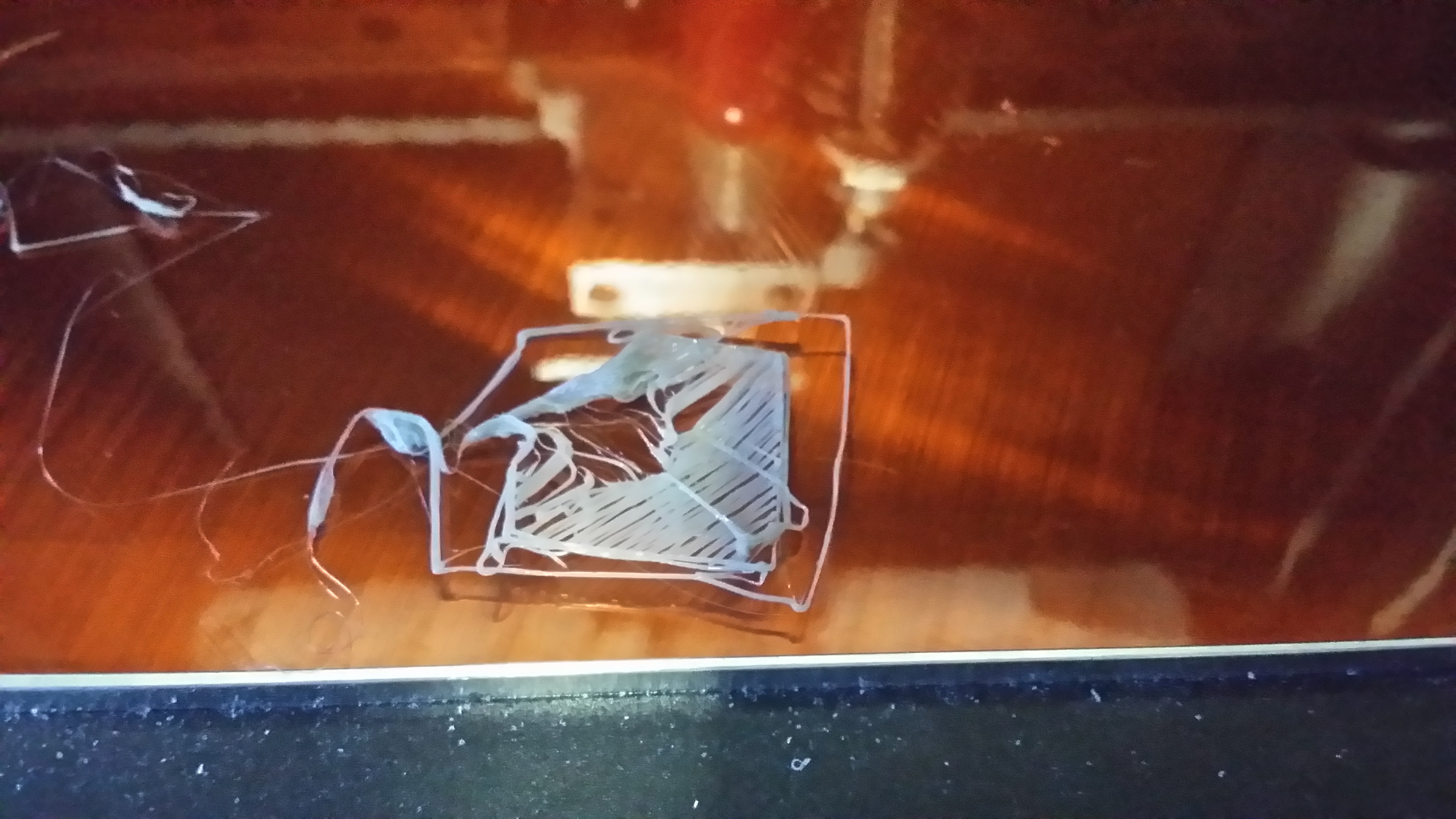

Ok this is the changes I did on Cura and the results now I know that it is the z height am I right also think half of you were but when I change the width from 200 to 100 this is the result
Hi Greg. I see initial layer thickness is still at 0,3mm. Please change to 0,2. Because at 200 percent and 0,3 you were extruding so much filament that it probably compensated a bit for z height error. But at the expense of lines not being wide enough to touch each other. If you do first layer at 100% and 0,2 any z error is much easier to detect. ( and loads on extruder are much lower) Because if to close to the bed, printwidth will become too wide. This becomes visible when infil patterns start to overlap. If to high, lines are not touching. A good workaround is to turn on raft. This will increase the succesrate of many prints and will also compensate most z errors. Good luck

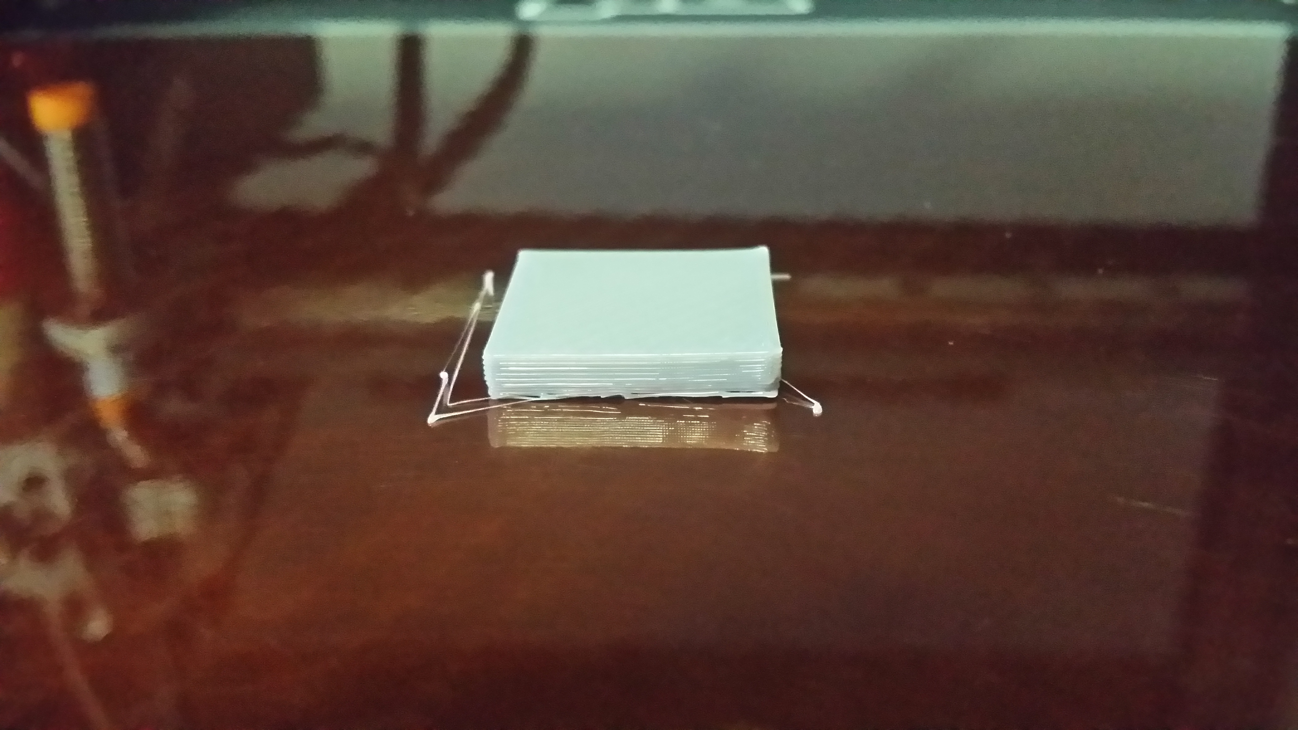

Ok did as you asked these are the results
Ok I wiped the bed down and tried again this is the next result takes time to stick to bed when extruding but layering still not perfect but it’s progress top and bottom pictures with new setting inicial 2mm width 100 print hiegt 2mm
