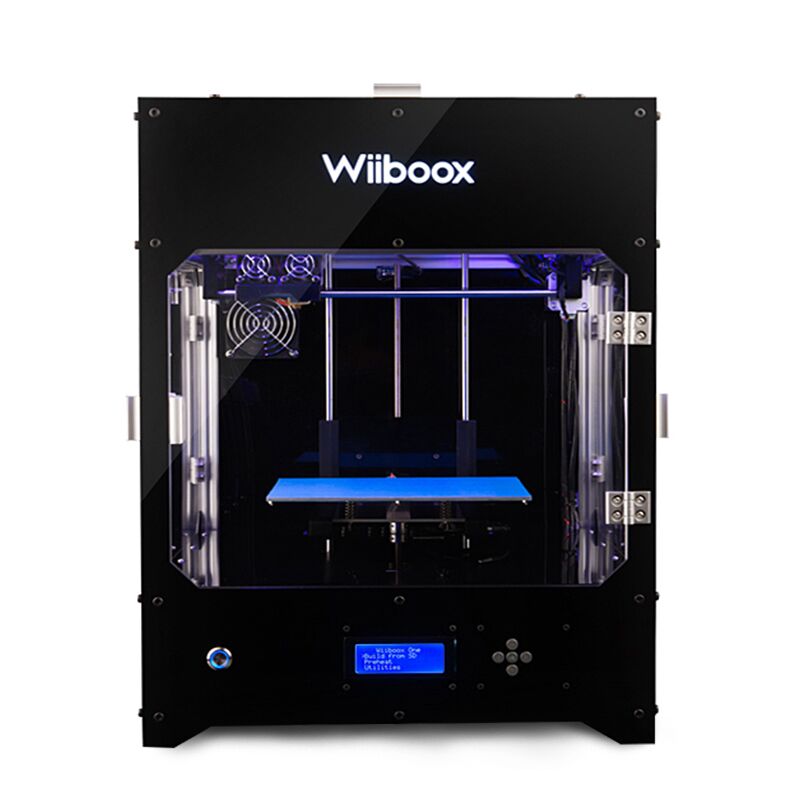

Hello, friend. We are Wiiboox 3d printer. Although we are not for kit 3d printer, the quality of our printers are so good and the appearance is so fantastic. It has 4 doors opened and wonderful air filtration friendly to the environment. You know that it is quiet for your work. And for this kind of printer, you just need to search “wiiboox” on Amazon. Then everything is OK. Thank you for your time.
