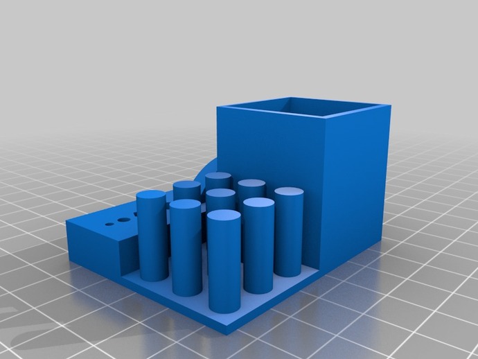

Torture Test
http://www.thingiverse.com/thing:33902
What it tests: Corners, layer alignment, overhangs, holes, and basically everything hard about 3D printing
Tips: A lot of trial and error. 15-20% infill, no supports, and a willingness to experiment

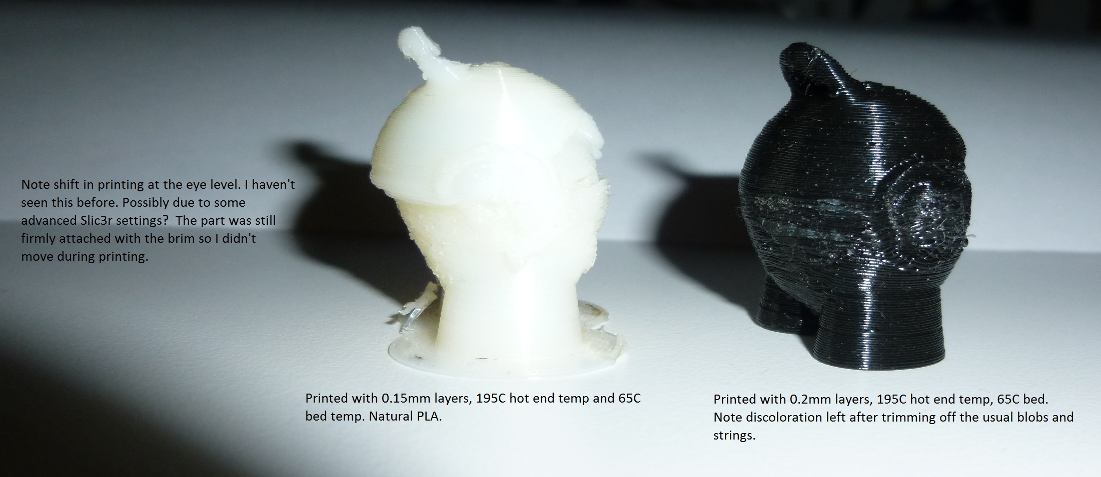

Great test objects. I have a lot of work to do as my Marvin test prints don’t look that well. The new natural PLA filament I have isn’t performing near as good as the black PLA.
